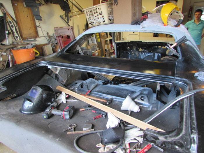

Why are there no seams for a rear deck filler on a convertible challenger? I would like to fill the seams on my hardtop. I have read in some spots that even if you weld the seams they can crack. Thoughts?

I’m guessing for more strength. I see a lot of the lead cracked probably due to body flexing. I can’t see a hard top cracking if you welded it completely.

I completely mig welded mine then hit it with a thin layer of Bondo then dragged a slot into the bondo to imitate the original seam

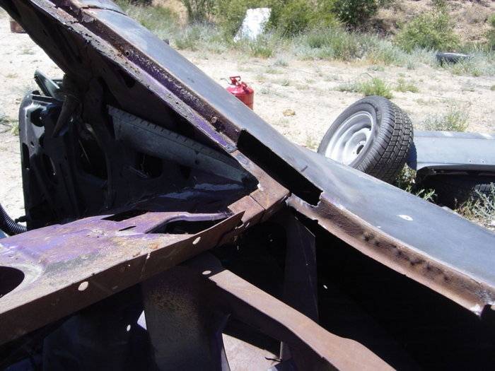

When I replaced mine I found on the right side all the factory spot welds had failed where it connects along that seam long ago, evidenced by surface rust on the welds. If you are going to fill or weld that seam make sure the bottom side is still connected; or you could add a couple of tack welds from the bottom... might be hard to reach.
(The cut out was for the window corner)

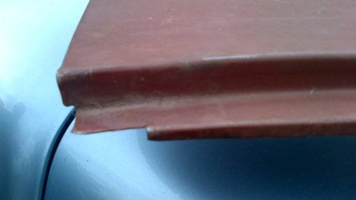

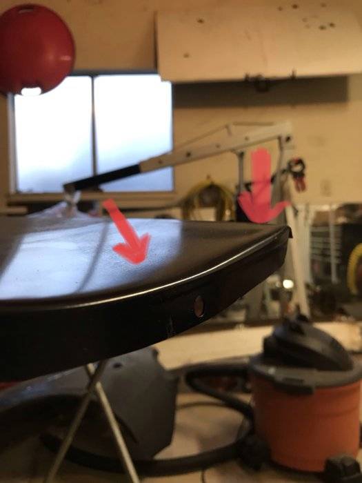

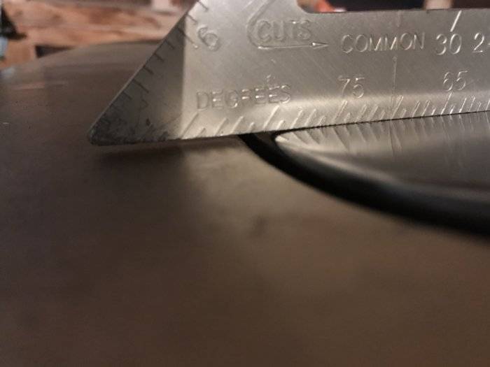

Also, I have the AMD panel in place and it sits a little high. I have trimmed a bit of the edge that sits inside the trunk, and it helped, but not perfect. I’ll take some photos. Need some advice on getting it to sit flush with the quarter.

Can anyone post photos of how flush their deck filler and quarters sit? It fits well at trunk edge, high in the middle, and low at the window edge.

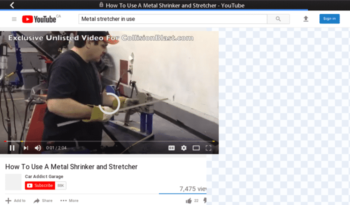

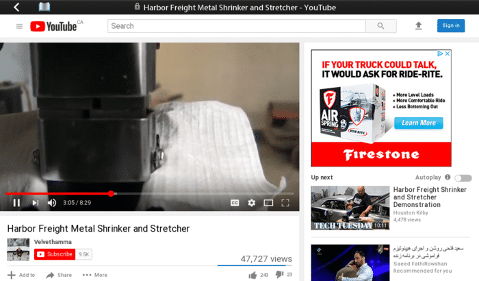

Ok, I went through a few episodes of the first season and couldn't find the clip, BUT, I found something more useful. Here are two videos that are better than the clip I was telling you about.
In these short videos you get to see how the tool works from close up. Apparently Harbor Freight caries them. In your case it looks like the stretcher is the tool you need.
I hope thiis helpful, good luck

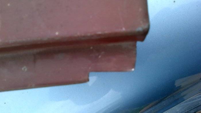

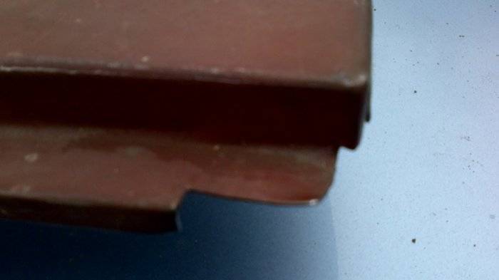

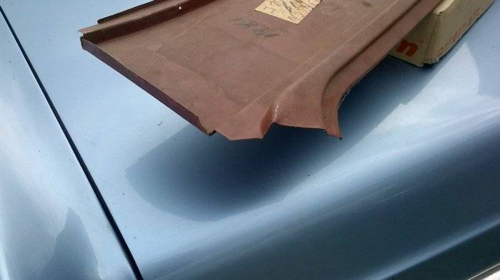

Ok, there is only one thing that could settle the score on that question and that is a photo of an nos Dutch panel , or equivalently, pics. from a good used one. I think I might be able to get you close-up pics of an nos panel if you are not in a rush. I have it in storage, but hard to get at at the moment.
But maybe another member can get you one more readily, at any rate I can get you a couple of pics.

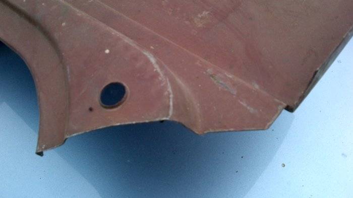

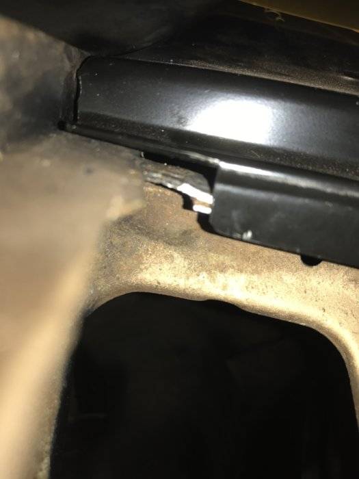

Ok, what about this gap here. This is at the corner or the window channel.
I looked at the pics of that area when I removed mine. There was no evidence it was welded that far up/close to the window channel. Just the shitty spotwelds along the side. The factory piece probably had a similar gap to aid in quick assembly, then they probably ran the seam sealer into the corner. The window trim would trap dirt & moisture there.
An easy fix would be to weld a flat piece, of the appropriate width, underneath the window channel to bridge the gap, and grind it to fit; but I don’t think it is structurally necessary because of all the welds along the sides, and across the package tray.

Let there be lite!
Sorry if the pics are a bit dark, took them in the evening

My deck filler panel was a little off as well. I cut small slits in the flange which allowed a little hand pressure to curve the panel and then welded it in place. Rod

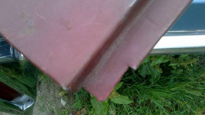

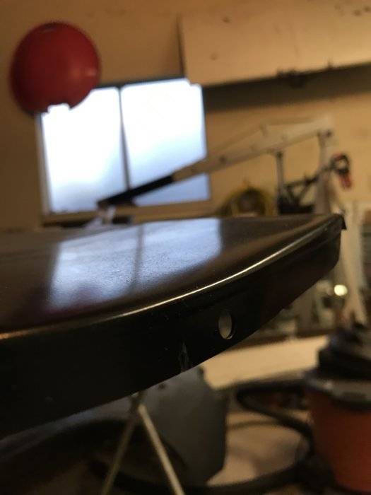

Ok so I think I got it figured out! If you can notice, the bend at the flange has a highly spot like the stamping wasn’t crisp. Now, lightly hammer the crease tighter?
