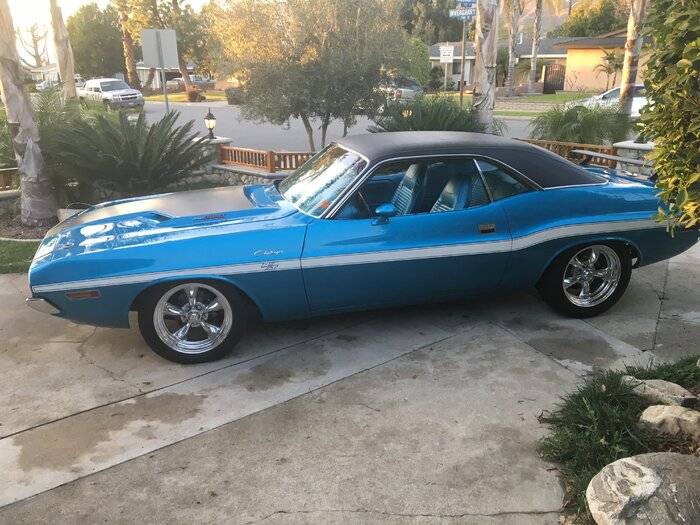

Prior owner installed the MP's on my Challenger. It sits low, 24 inches from the ground to the fender lip in the rear and it rides like a dump truck.
fetch
I like the lowered look. Ordered a set of Hotchkis Sport Suspension leafs that advertise approximate 1 inch lowering and have a 160lb rate. Should soften up the rear a bit and I'll probably get an inch of ride height back.

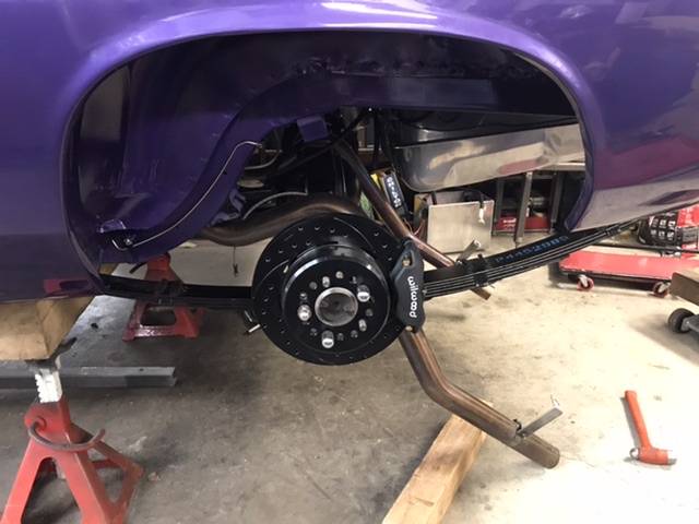

Hey 525, I bolted a set of MP Super Stocks under my Cuda and might have raised it 1/2” but no more. The p/n is P4452985 for the left and 984 for right. They handled really well before the upgrades, yet to get it fired and driving. The photos are before and after, sort-of. Do you have that monster running yet? Looks like you have made a ton progress.

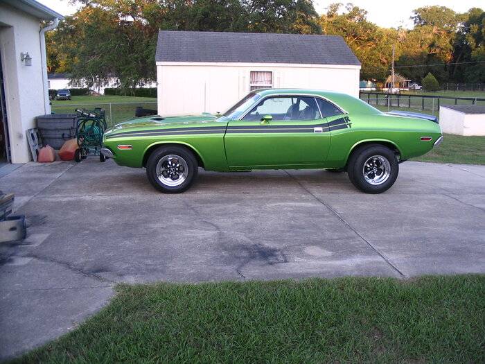

Running firm feel suspension, rides nice , corners flat, rear lip 24-1/4 inch off the ground, front lip 23-3/4 from ground on 255 50 17 rear and 225 50 17 front
Hope this helps
74Scooter
Nov 30, 2019
31
8
Hope this helps
Nice ride! Nearly exact same ride height and tire size as mine. How did you get front down? Prior owner of mine dropped by loosening the torsion bars... LCA is only about an inch off the rubber stop. I had to install SPC uppers to get the camber adjusted properly.
