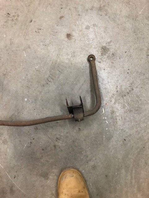

Working on 1973 Cuda with original rear sway bar want to replace the bar to body bushings and end linkS. What the deal on those bar to body brackets all welded together how do you replace the bushings and who’s a good source for bushings?
As far as I know, the rear sway bar bushings are not serviceable and OEM replacements are not sold. I have not seen any split-type aftermarket bushings available anywhere either. Classic Industries is now offering a rear sway bar bracket 1970-1974 All Makes All Models Parts | MM8143 | 1970-74 Mopar E-Body Rear Sway Bar Bracket | Classic Industries but there are no pictures so I have no idea what is included. Based on the price, I would say it is just the bracket that mounts to the frame of the car and would have to be welded to the bushing loop.
I bought the rear sway bar from firm feel. They might sell only the body mount, I don't know. By the way, this sway bar is awesome. Firmfeel Mopar Suspension and Steering
I had to drill the welds to remove the petrified bushing, but I found generic urethane bushings online for about $20. I added a zerk fitting and drilled a hole through the urethane because I wanted to avoid squeaks. It was an easy matter to weld back together. It works great and was cheap...
Note:this is an example, I only guessed the size at 7/8 (it may be 3/4) because I do not remember the actual size. Now given this example you could tack the brackets onto your sway bar, or discard them and re-use your originals; I would also consider buying un-split bushings and carefully cutting it, because it would be very difficult to force the bushing over the eye...
