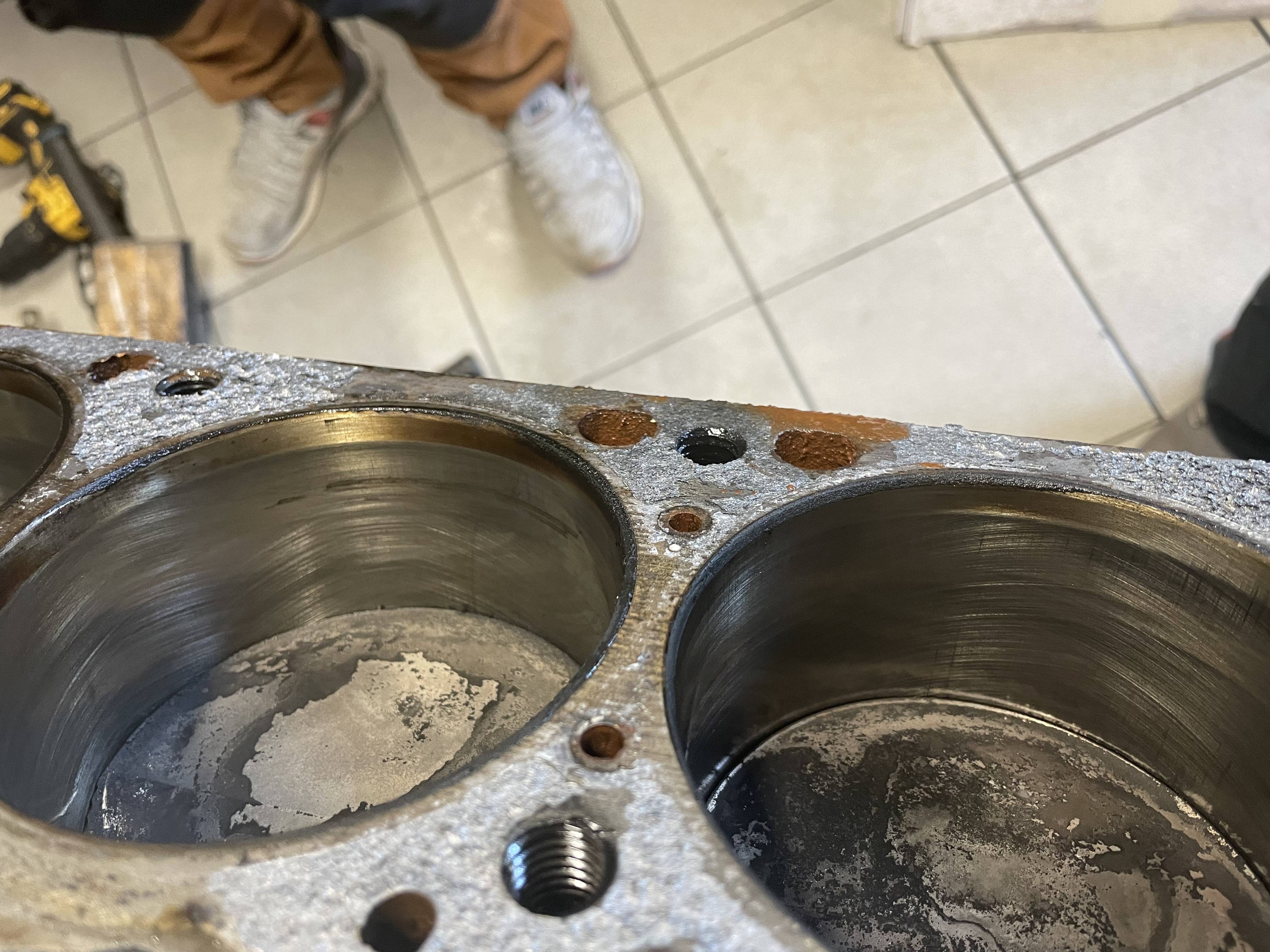

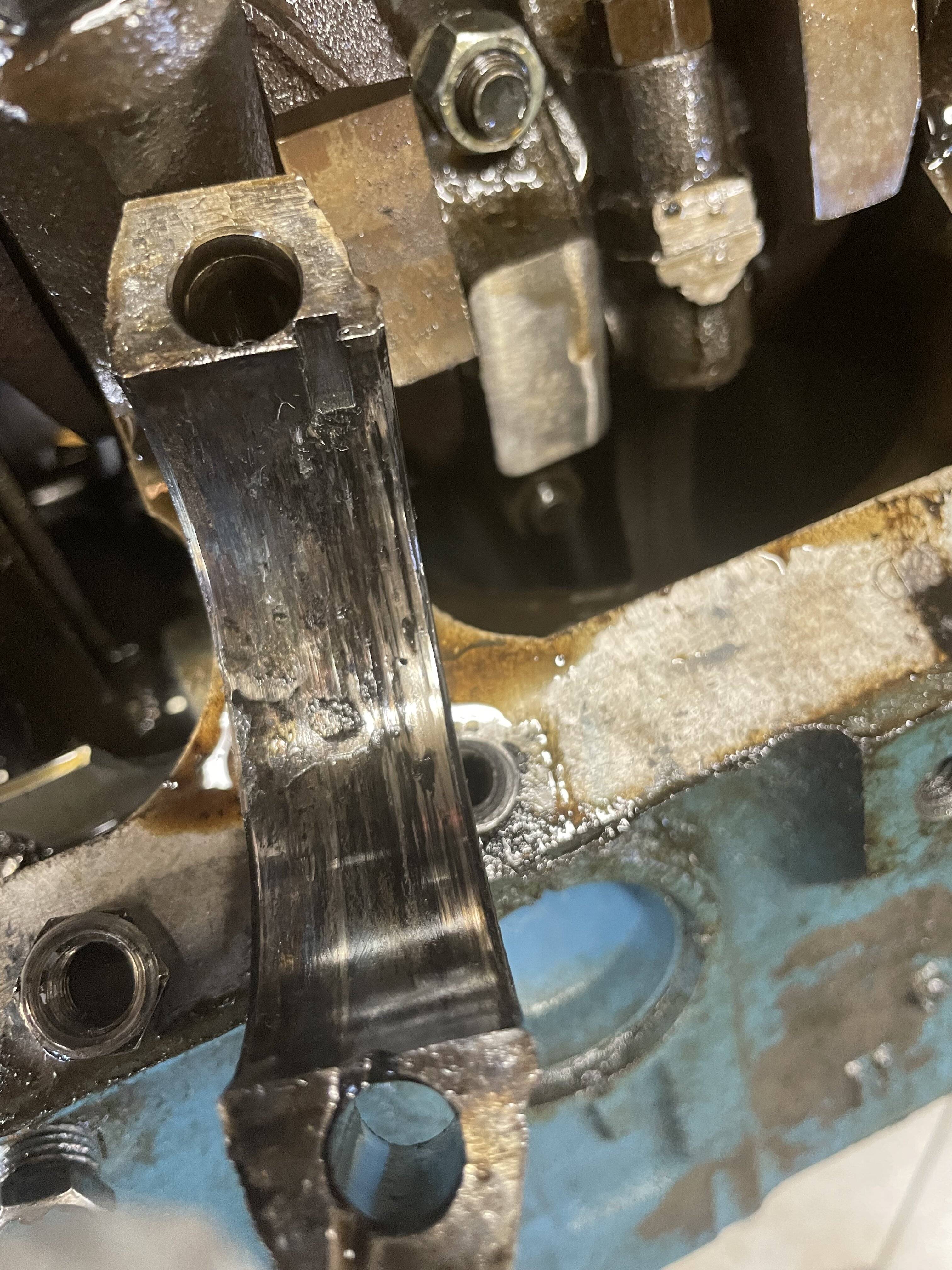

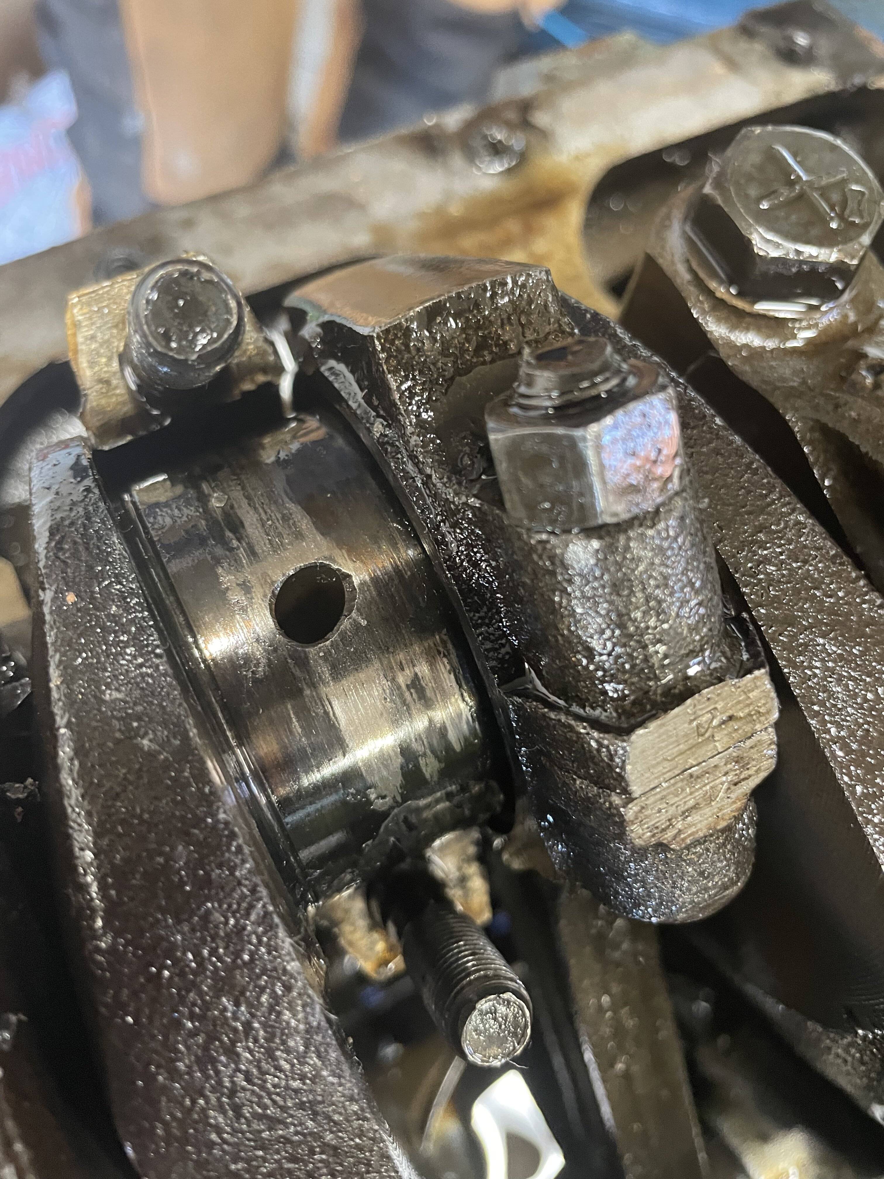

Definitely 1 rod bearing gone, thoughts if crankshaft can be saved ? Will need to tear into the rest. Bores look ok, heads look ok. Sump wasn’t baffled.
