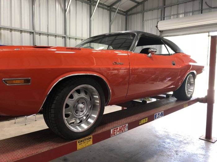

Look up American Racing,Torq Thrust 2 wheels,at Summit Racing. I think the new ones look like the old Torque Thrust 2 wheels..

Yes, late model challenger/charger rims will fit on a 70 challenger as they are the same pattern 5x4 1/2. Might have clearance issues with the front. I have seen pictures with them on e bodies. They do look different on the older cars, depends on what your look your after. I like the old school rims myself. IMO I would go with what Adam suggested and check out the Torq thrust 2 rims!

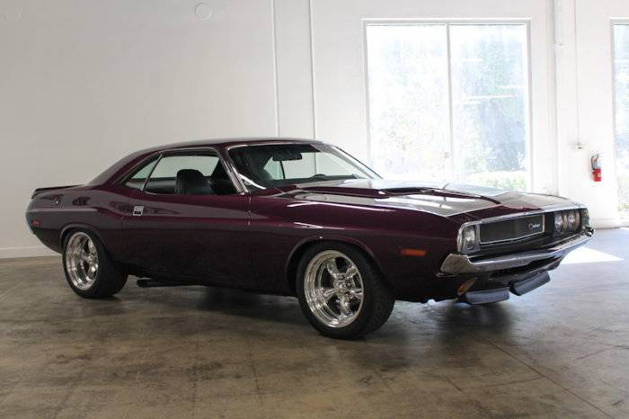

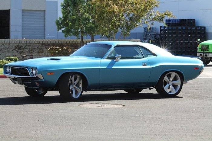

This might give your some idea of how they would look!?

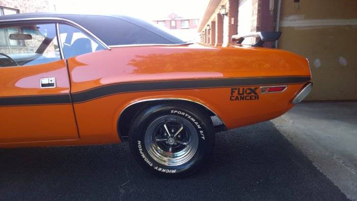

I currently have the 14 inch ralley wheels. I think everyone is right. Old school wheels may be the way to go. I like the Crager mags and may go that route. Thanks everyone.
