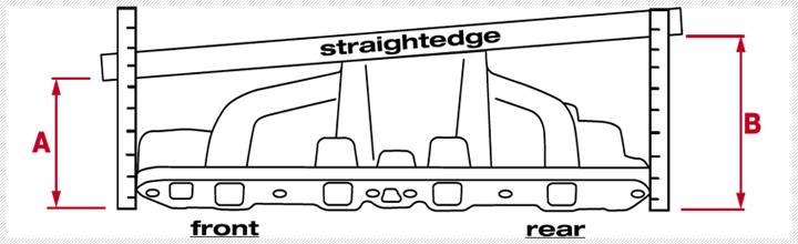

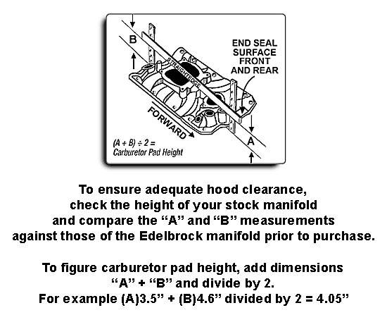

To ensure adequate hood clearance, check the height of your stock manifold and compare the "A" and "B" measurements against those of the Edelbrock manifold prior to purchase. The heights of all Edelbrock manifolds can bee seen on the Manifold Reference Dimensions page.
Please Note: To figure carburetor pad height, add dimensions "A" + "B" and divide by 2. For example: Performer manifold #2101: (A) 3.5" + (B) 4.6" ÷ 2 = 4.05"
Edelbrock Intake Manifold Important A/B Measurements.
