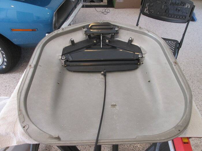

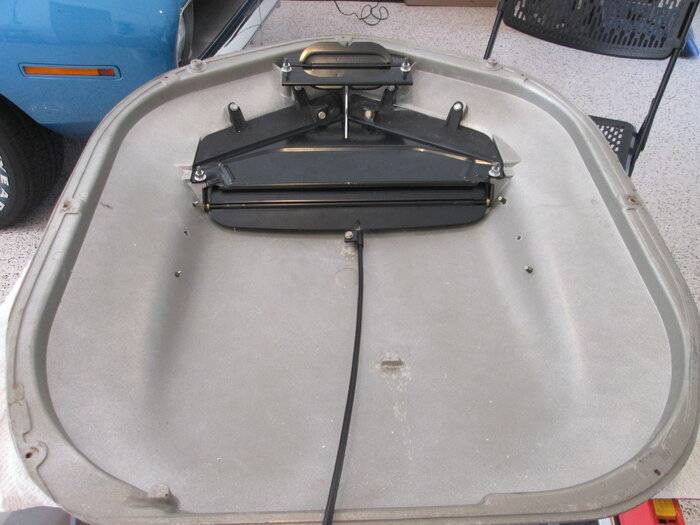

I found a couple more photos.
Terry

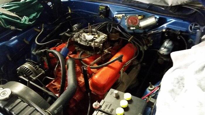

Terry im gonna drill the fire wall tomorrow hopefully if you look at me engine compartment you see the 2 dimples by the regulator so I'm gonna drill the one on the drivers side does that sound right to you. i was also told the hole is 1 inch

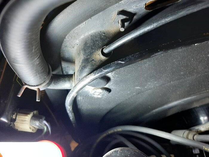

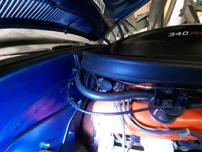

wanted to thank everyone with the help with the shaker set up especially Terry without him i would have had a real hard time doing this. Does the cable under the shaker scoop go out the slotted hole on the passenger side rear of the air cleaner base to the linkage? Look at last pic
terrywalker
Aug 31, 2013
554
366
No it does not. There's a hole out the side between that slot and the hose nipple. I just went out and snapped a picture of how mine exits the baseplate. You can see the slot you're talking about in the upper right of my photo.
Terry
KennyCuda
Aug 3, 2020
412
61
Terry thanks i went in the garage and saw it tough to see where its located but all good thanks again Kenny

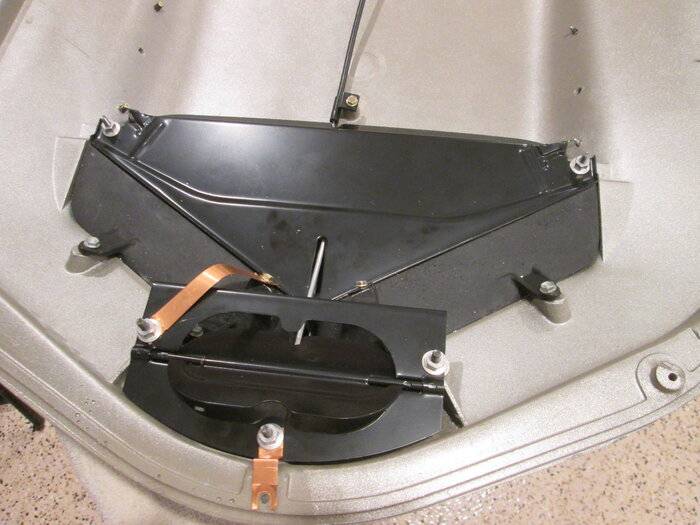

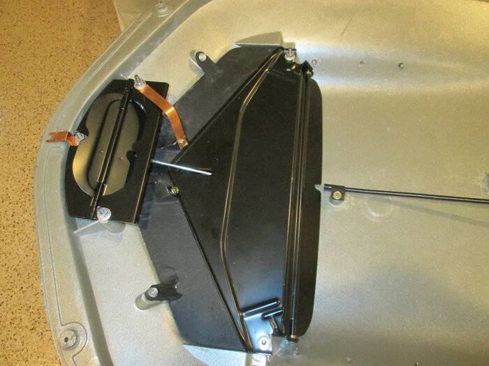

Kenny, I just noticed something in your photos from today. Did you put the grounding straps on the air doors. See my photos in reply #6. You can see the two copper straps. Just a thought. I can't make out in your photos.
Terry
KennyCuda
Aug 3, 2020
412
61
Terry i did just posted the wrong picture. Thanks for seeing that. Kenny
