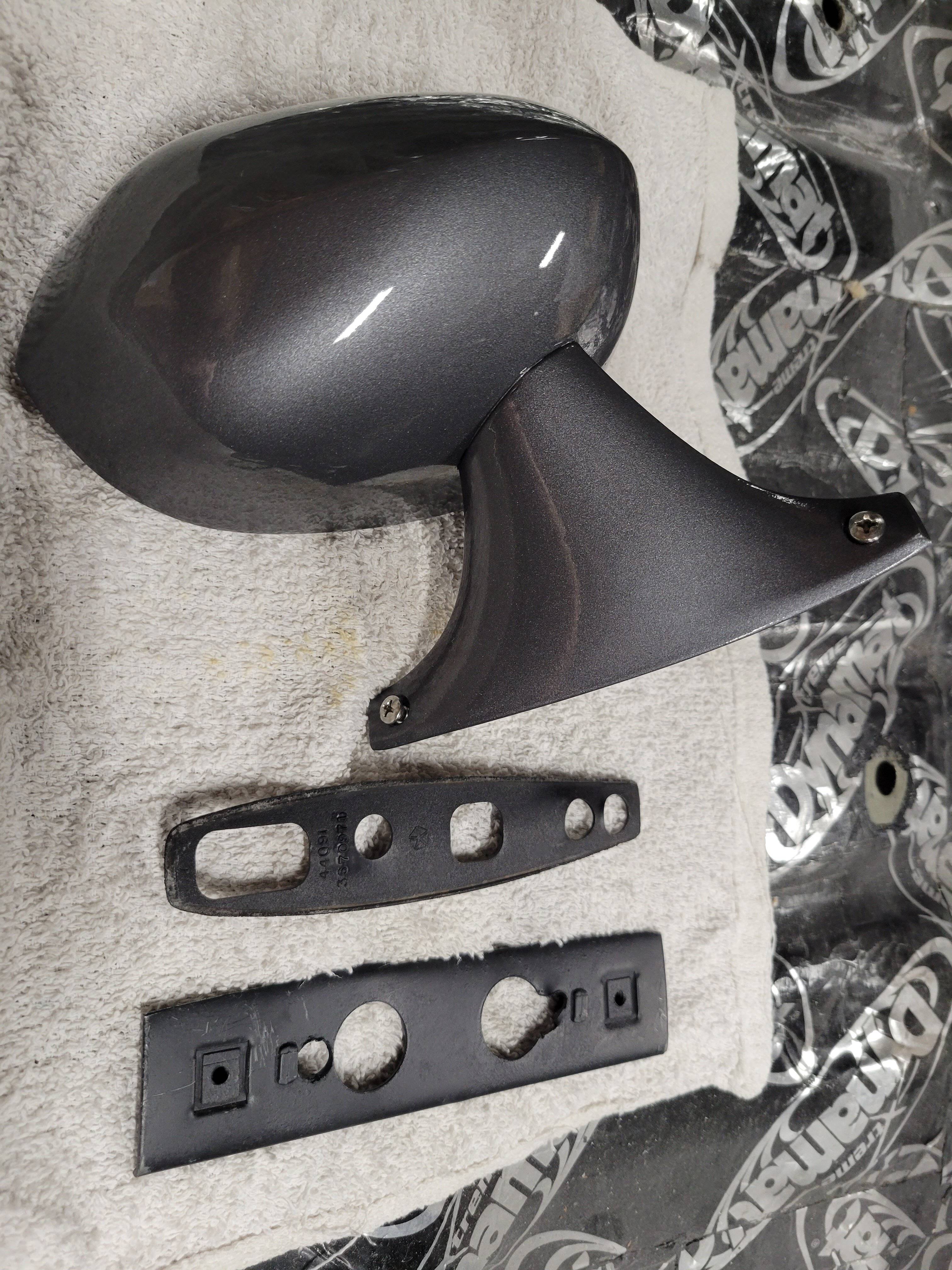

73 Chally: I can not find any videos or anything in the parts manual on how to install the side view mirrors. I have the mirror, the gasket, the screws, that's easy. The plate that goes under the door skin is the real problem. How in the world can you align that to capture the two screws as there is barely finger room to adjust? There are two other holes that look like they may hold this plate in place as you tighten up the mirror screws, but I got nothing to go by for guidance. These were already removed before I bought the car. Any help/suggestions welcome - thanks.Chally Door.jpg
I believe tht is a B body mirror , the base looks wrong for E body , the Ebody usually uses rivnuts & the screws thread into those
Well, these might be B body mirrors, but since the holes all align, they are now painted to match, that's what is going on. I'll figure a way to secure the backing plates in place to facilitate the installation some how. I see that Classic Industries notes the same part number for 71-72 B body and 71-74 E body, but something different for 73-74 B bodies. The previous owner may have installed the wrong ones. Thanks for your response.

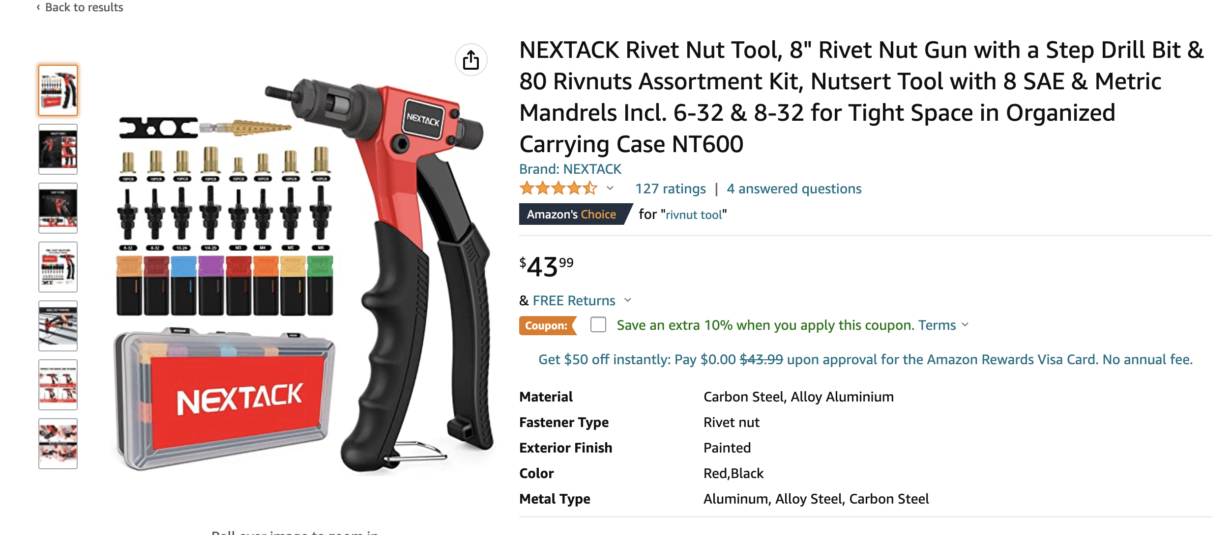

John, as Chryco said, Rivnuts, you can buy a kit with the tool from Amazon for ...I bought one and it is so easy.
Okay, that's cool. So, does the Rivnut option still use the backing plate or does the mirror depend on all support from the door skin at these two points? Seems flimsy to me?

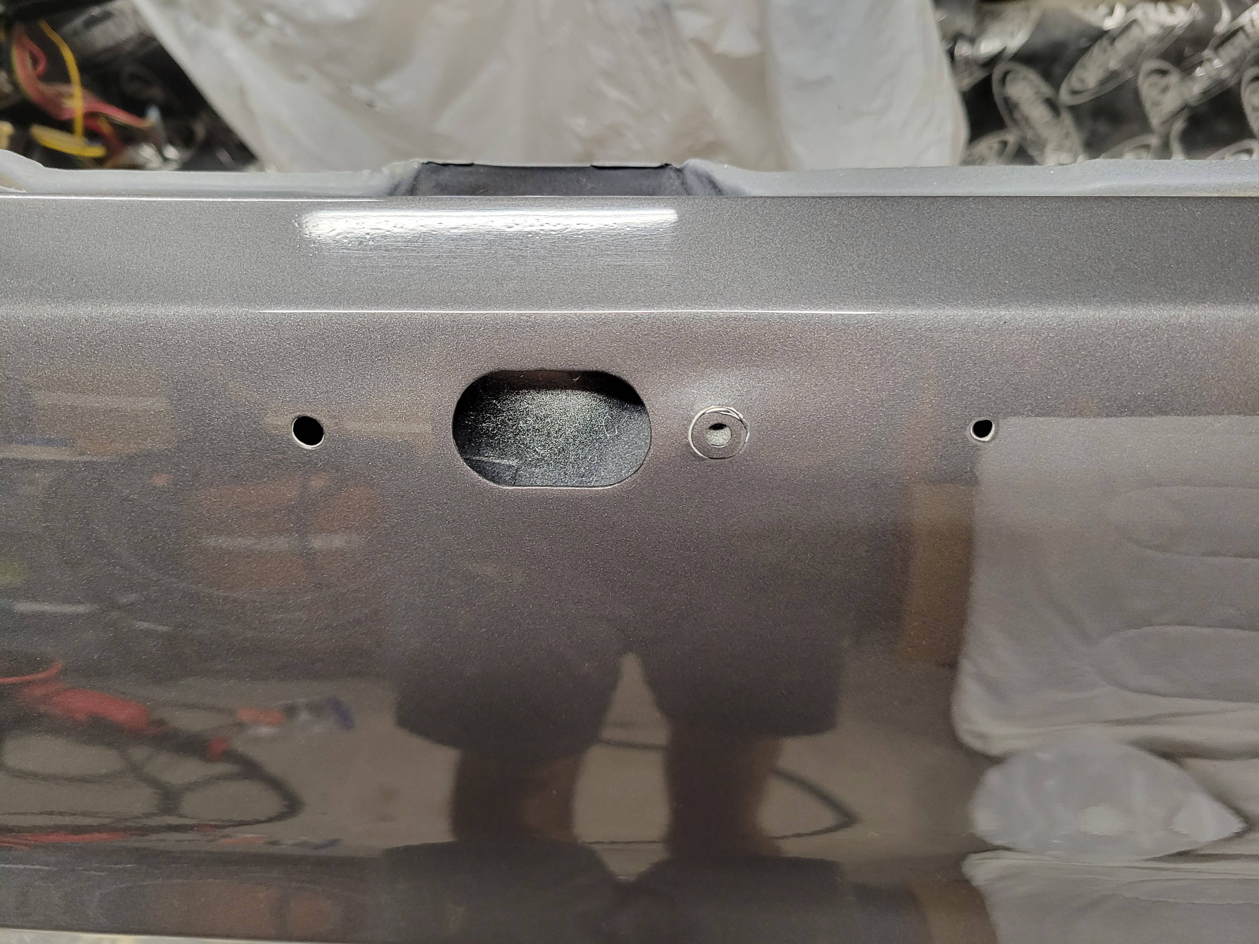

Is that a Rivnut installed just forward of the oval cutout in door skin photo?

Yes it is. There is only one on the passenger side also. But the mirror screws align with the two small outboard holes, both sides, not where the Rivnut(s) are located. I think Chryco is correct. This car had original side mirrors on it and were replaced with these current ones. Since these are not original, that may be why when replaced, someone put on the backing plates.
Backing plates were used on B bodies not on E bodies both had a gasket outside under the mirror .
Yes there is a rivnut at the front in the picture .
I have the gaskets that fits these mirrors. I think I'm good. Maybe the B body mirrors were heavier than the E body ones and that warrented the baking plate? The vinyl top is going on Saturday, so I'll post pic's of that and the mirrors installed.

how i aligned the backing plate ..with out mirror threaded one screw in moved it to thread in other screw then drilled 2 holes and pop riveted so they are covered by mirror
Nice idea. I like it and will give it a shot. Thanks.
