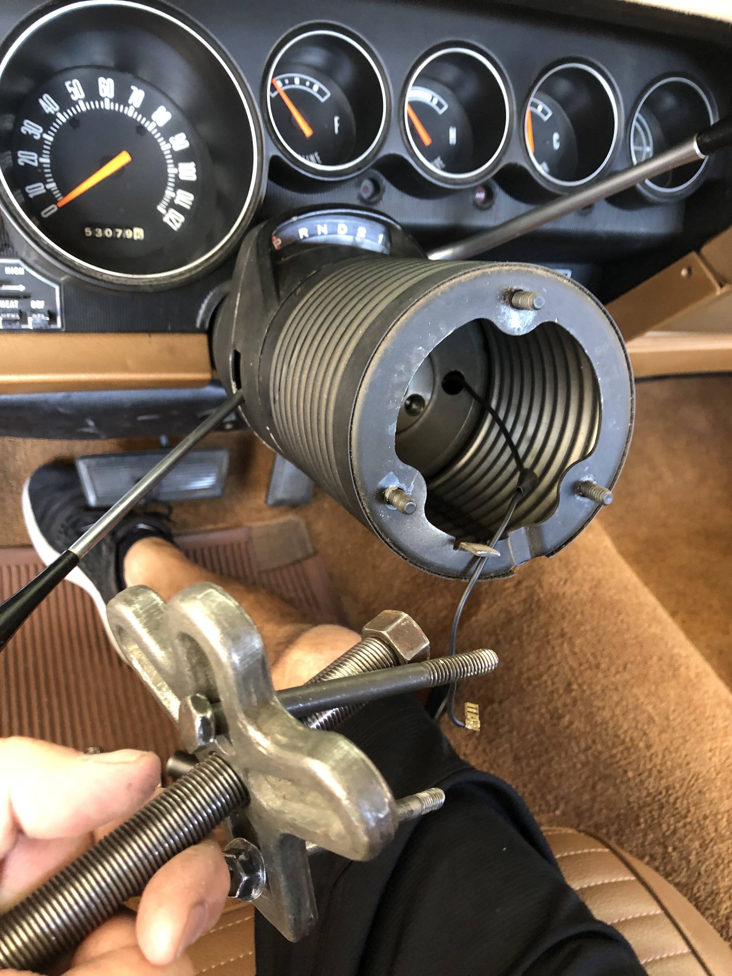

Steering wheel puller?? For challenger columns

6 inch long bolts? Or special puller?

Oreillys has a good loaner. There’s will go inside the lip where the studs are.
If you can get one to attach the the studs the wheel goes on would probably be ok, don’t know. I’ve always had to be under that lip. Only had use it a few times but, works great.

I have done both using longer bolts or smaller pullers that fit inside the can .

I made one using 3 long bolts, 1 nut and some tubes. Allows me to remove the crush cans from out side of them which is handy. That said, I used the ones shown for many years as well.

thanks guys i bought 10 inch long bolts!!! worked great!
