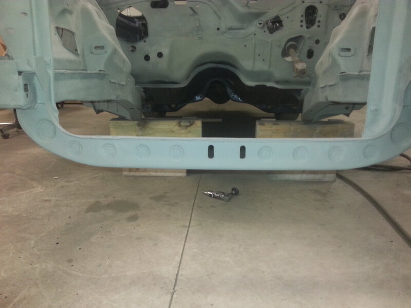

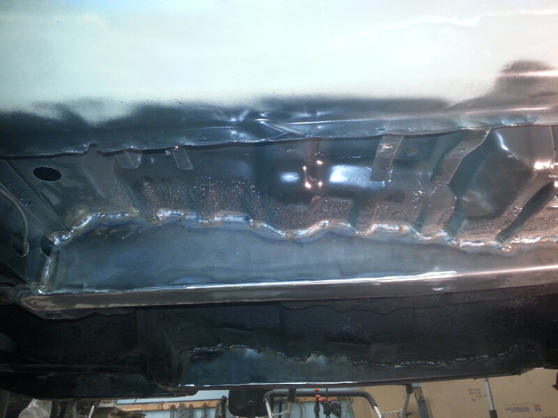

I used the Hotchkis bars on a hardtop and they are ok.

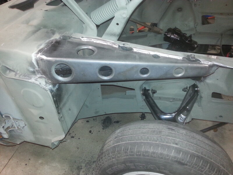

Magnun Force twin tube design. I did one theirs to on a 71 Cuda vert but I just bolted them in. Don't think they did a whole lot on a vert. Maybe better for a H/T.
