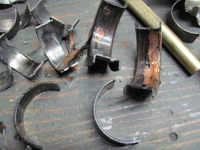

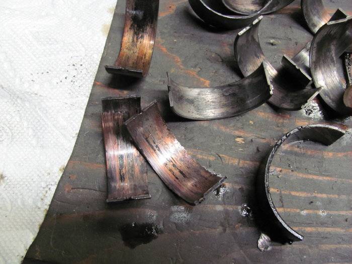

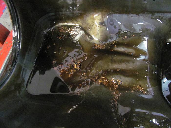

The friend is so worried about driving a car as valuable as a T/A he spends most of his time watching gauges as he finishes the drive home. Wouldn't you know it, about 12 miles from home he say's, "I'm not kidding you, the oil pressure just dropped instantly while I was watching the gauge." He shut it off and coasted to a stop.
We pulled the filter and cut it open............full of bearing material. The engine is in the shop now, we'll see, we'll see.

The relief driver was right, the oil pressure dropped immediately. The bearing material seized the oil pump and broke the hex off the intermediate shaft. Instantly no oil pressure.

Too bad this fix won't be that easy.

I'll bet the pump rotors look good too.
That upper half of thrust bearing looks suspicious to me.

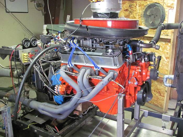

It has oil pressure now and 402 lb-ft @ 4,500 rpm & 411 HP @ 5,800 rpm.

Congratulations! Be interested in knowing what rear wheel net hp is.
