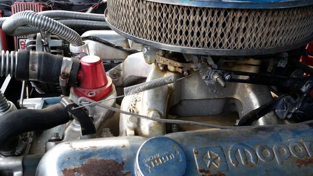

With taller intakes the kickdown linkage will not be long enough to push the linkage all the way back unless you put a bolt into the slide as he has or weld an extension into the linkage , if you remove the bolt & the trans will burn up .
you should Always run more than spring in case it breaks you can run another spring to the rear from the bottom of the throttle lever back to the cable support often this will work better .
