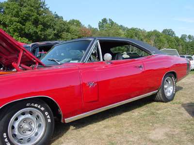

I had 295/50's on my Challenger with no mods, no rubbing and stock suspension. The same wheels and tires are now on my Charger.
I have since mini-tubbed and moved my leafs inboard on the Challenger for larger tires.
