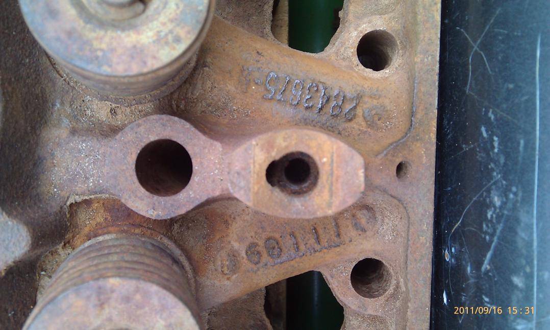

Anyway, the extra set of heads that he had with the deal have me wondering what they are. Attached is the number. Thanks for any help. He had a clutch fan, new alternator, and car oil pan and windage tray that I was needing also.

well you need to get 9.7 range for compression , you could build a stroker out of it & get a new crank rods & pistons if you need to change pistons to get the compression you need . The J heads are ok & do have the big valves but the other option is to sell them for good $ & build a set of the later 308 heads from 87-92 Dodge trucks , with some port work you can gain 40 rwhp over the J heads , I would look at a Lunati Voodoo cam , they are specifically designed to take advantage of the wider Mopar lifter & make more power , depending what you want you can go to a flat tappet hyd cam or a hyd roller or a flat tappet solid . 350 hp should be easy considering they made about 320 stock !! I am not sure what intake you have but the factory one is decent , next step would be the Eddy RPM Air Gap
