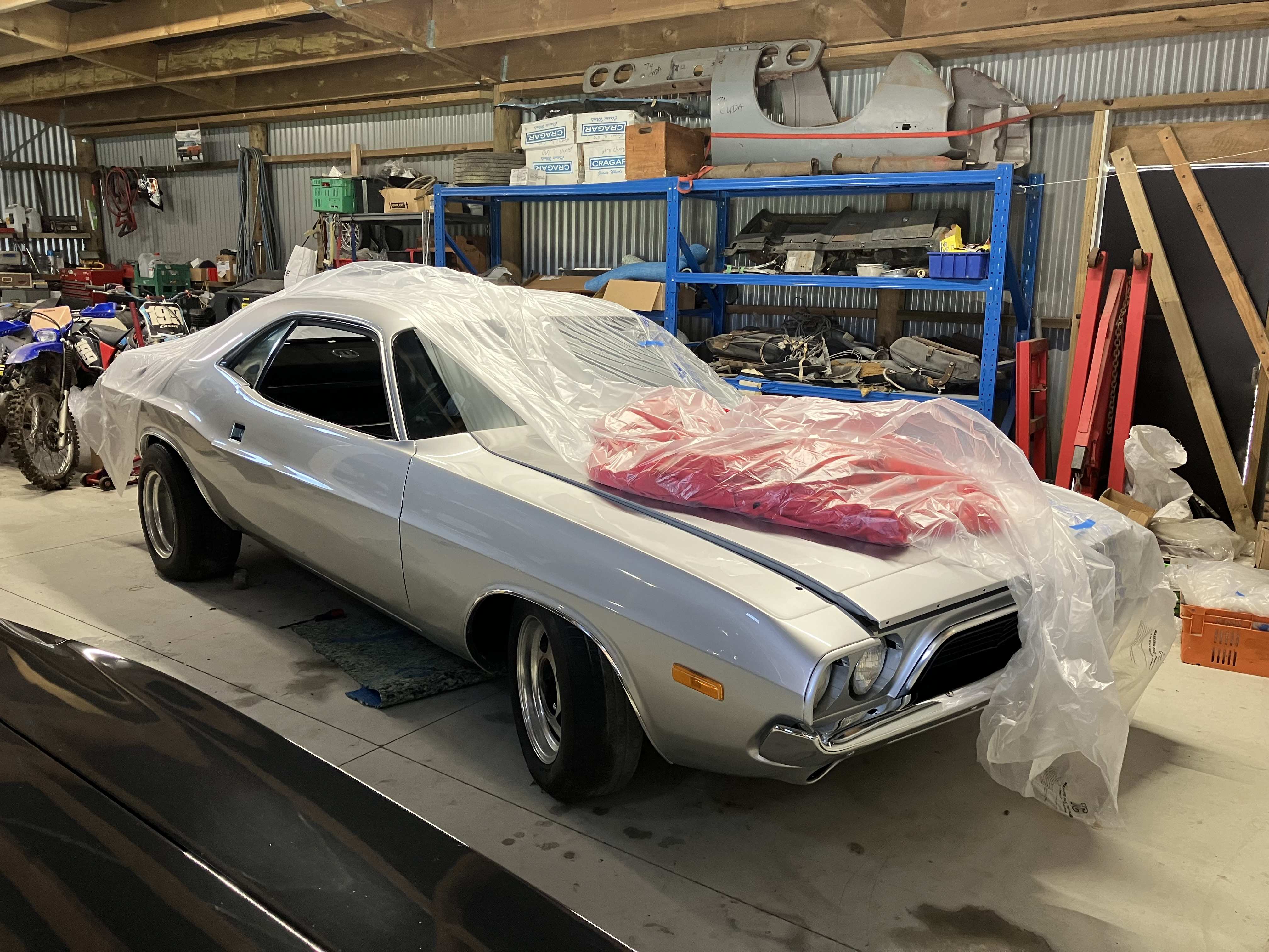

Hey good Mopar people building a 383
Bored 60 over , but of a novice with the transmission want a manual transmission. What the most cost effective and best way to go people talk about temadec etc thanks any help would be greatly appreciated
