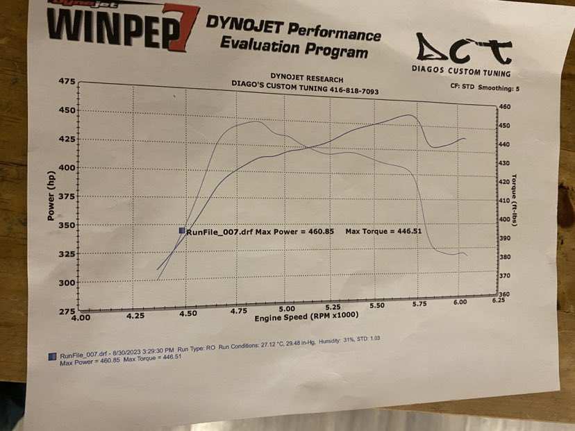

Today the car was on the chassis dyno to put a tune in the holley. It still seems noisy to me standing next to the car but again don't mind if it's not hurting anything. They made a few pulls and did some tuning and picked up about 30rwhp and 20+lb/ft. But no matter what they did right at about 5600-5700rpm it hit a wall and dropped off a cliff and didn't want to rev. Where I'm assuming the valvetrain became unstable. Which again I'm fine with if it's common place.

Not wanting to rev out may be a valve spring problem.
The hydraulic rollers I have played with hit 6000-6500 no problem. That is with a beehive spring on most of the motors.

I have TF240's on a 440, solid lifter cam, and 1.6 rockers. I had a somewhat similar problem when I put it together, it just didn't seem to want to pull "cleanly" past 6000rpm.
I did some checking, and found that the TrickFlow SFT springs are supplied by PAC. A quick phone call to PAC revealed that TrickFlow (despite their all around "good-ness") does not use the recommended installed height for the springs used. TF installed height is 1.900, PAC recommends 1.850 installed.
I bought and installed .050 offset locks, which cured the problem in my case.
Just a thought.........
Your situation could be simply the poor state of hydraulic lifters these days. A lot of problems with both roller, and flat tappet hydraulics.
