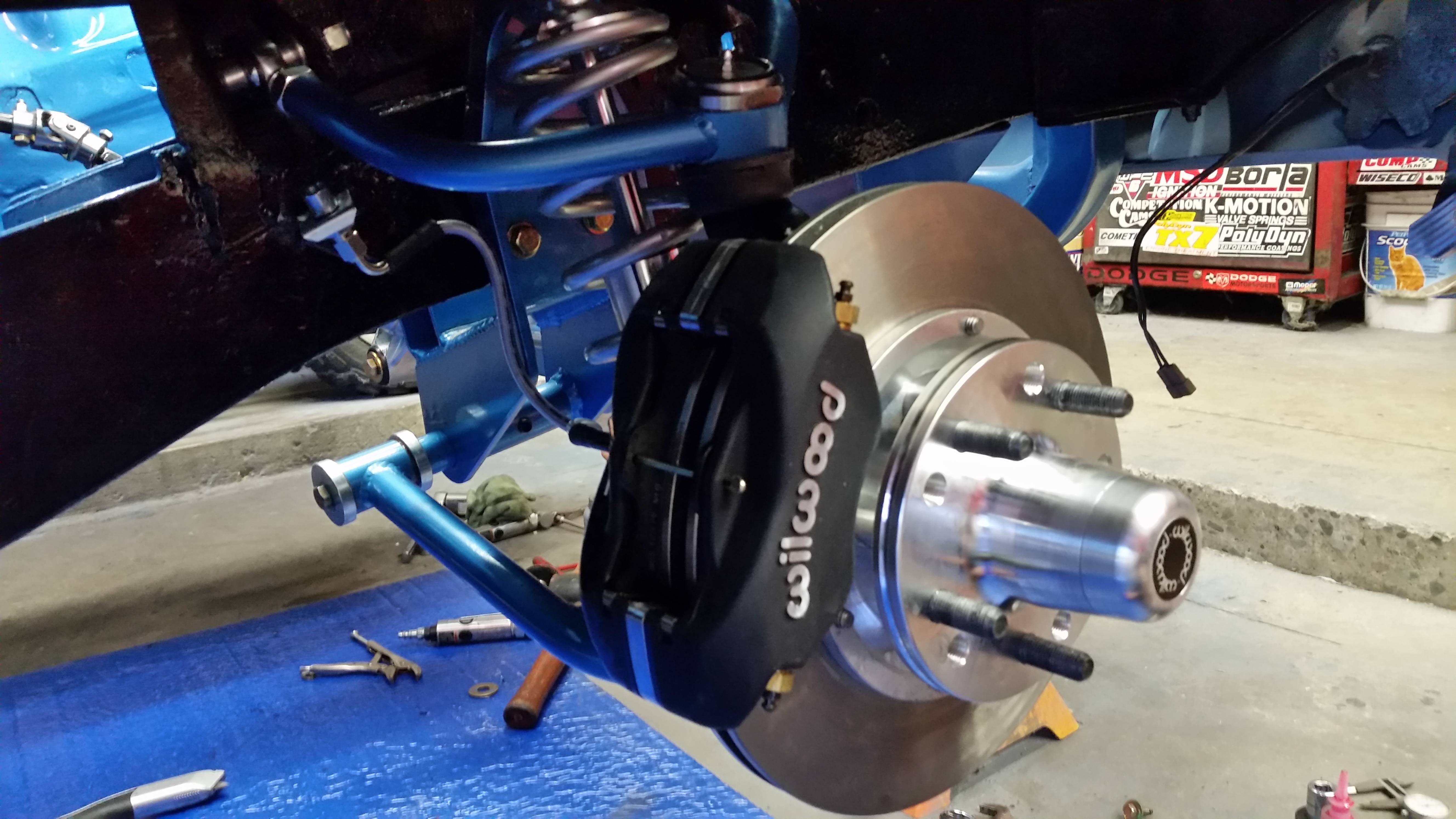

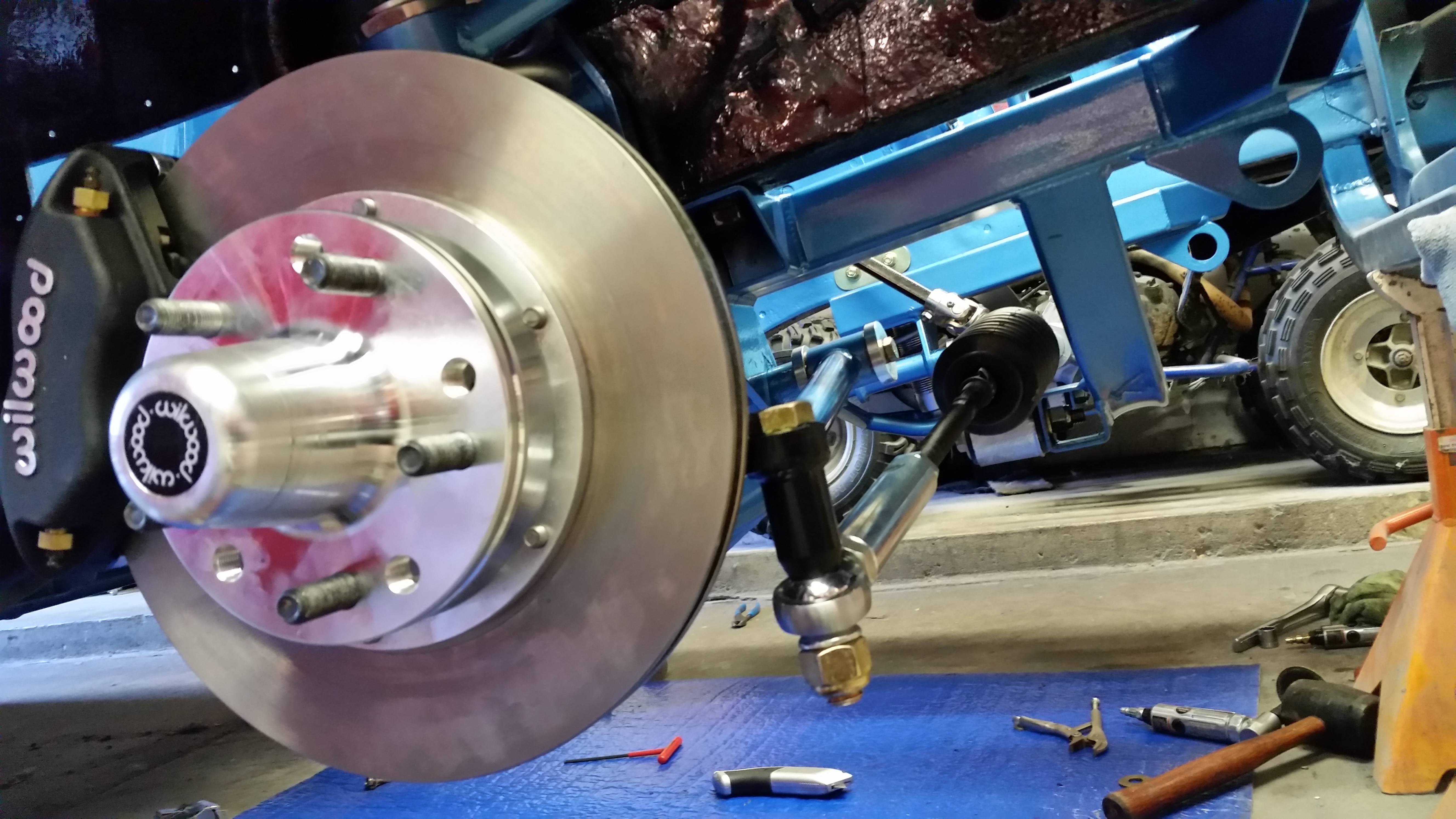

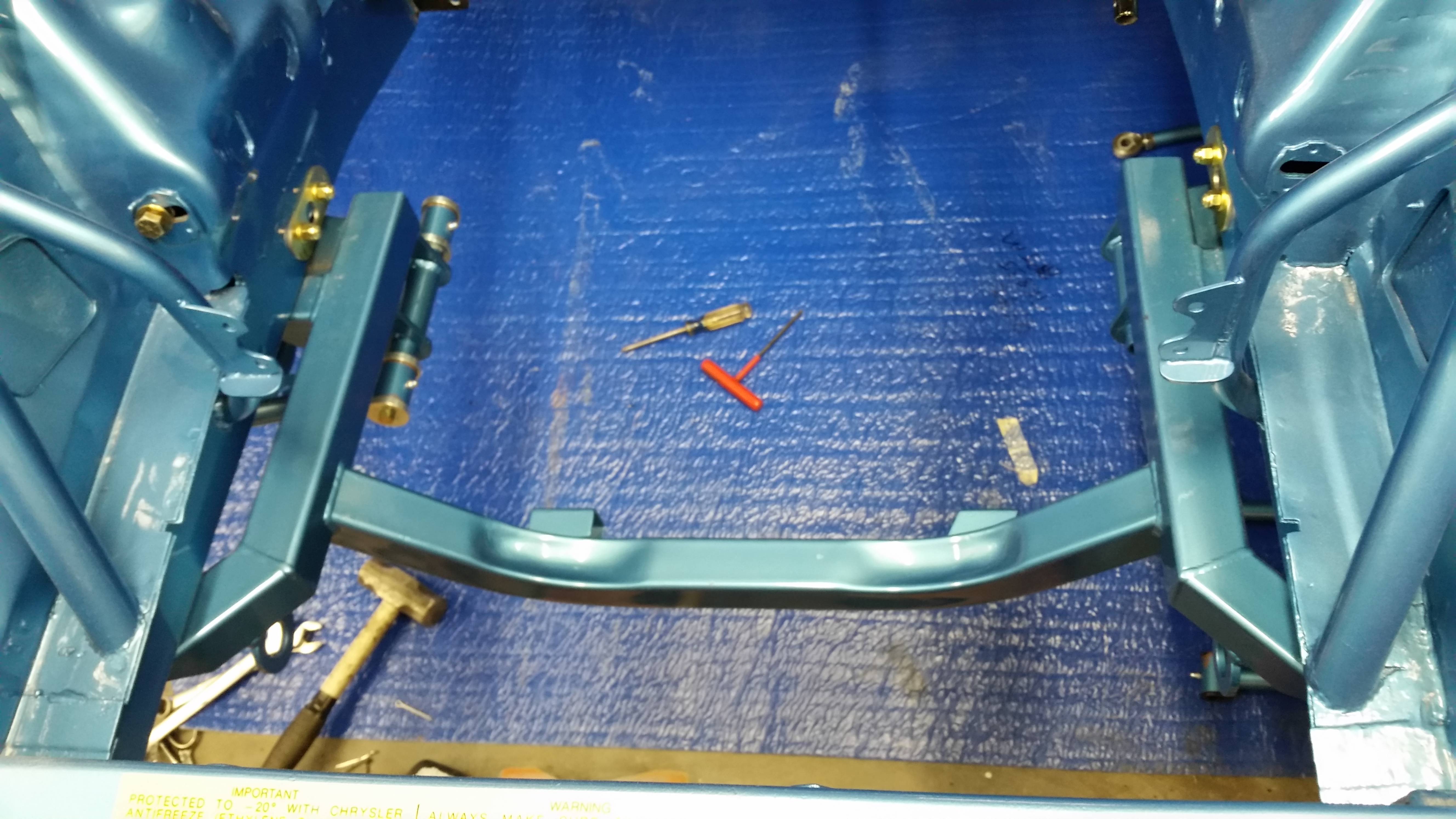

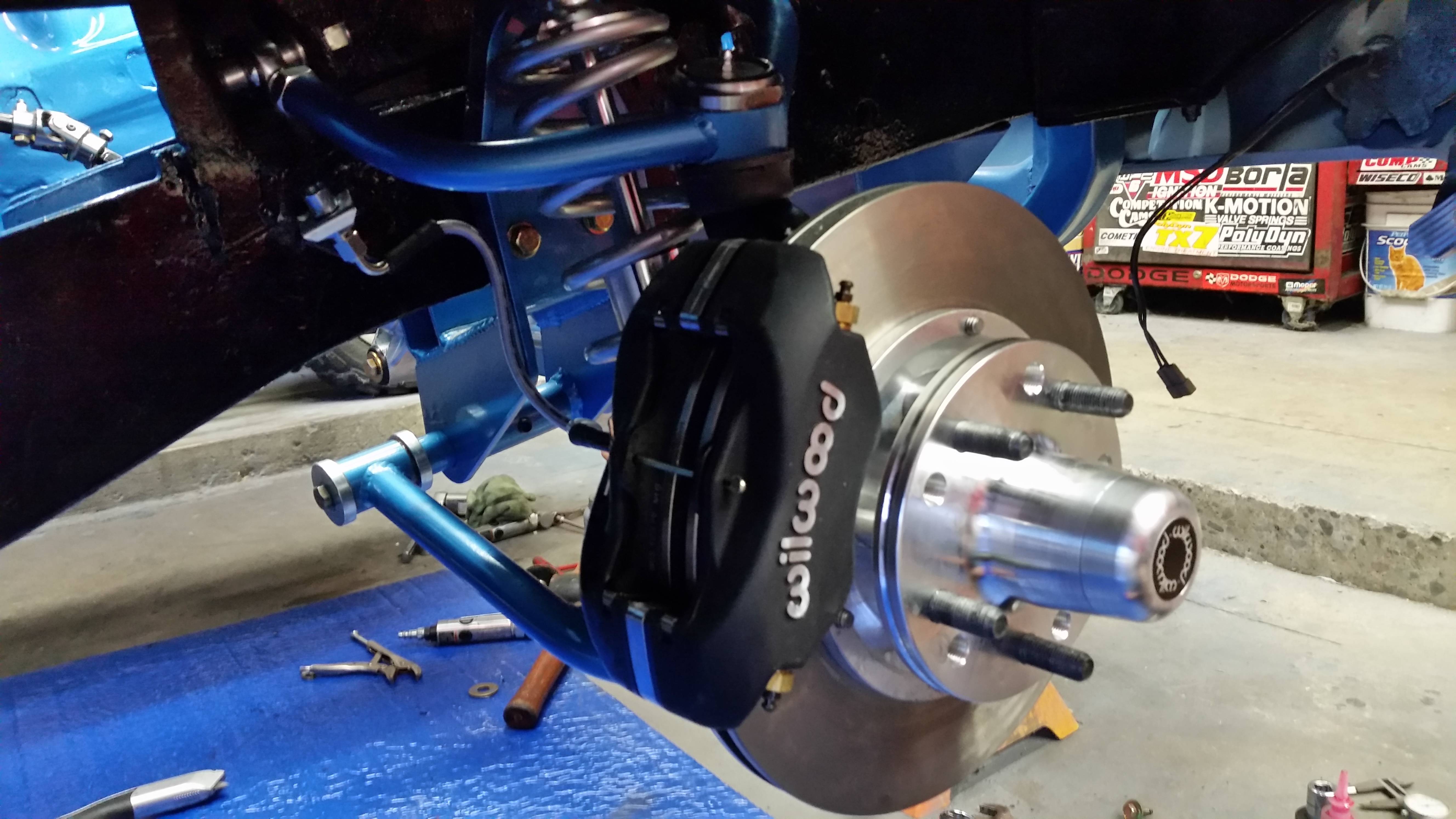

It's an AlterKation (RMS).

It does not have a part number on it anywhere.
Thanks for checking. I have the Chinese piece of junk rack that came with my cross member kit so I can cross reference that for specs and I'll get a hold of Flaming River to get their input on Monday. No import parts on my Mopar! Have a good weekend.

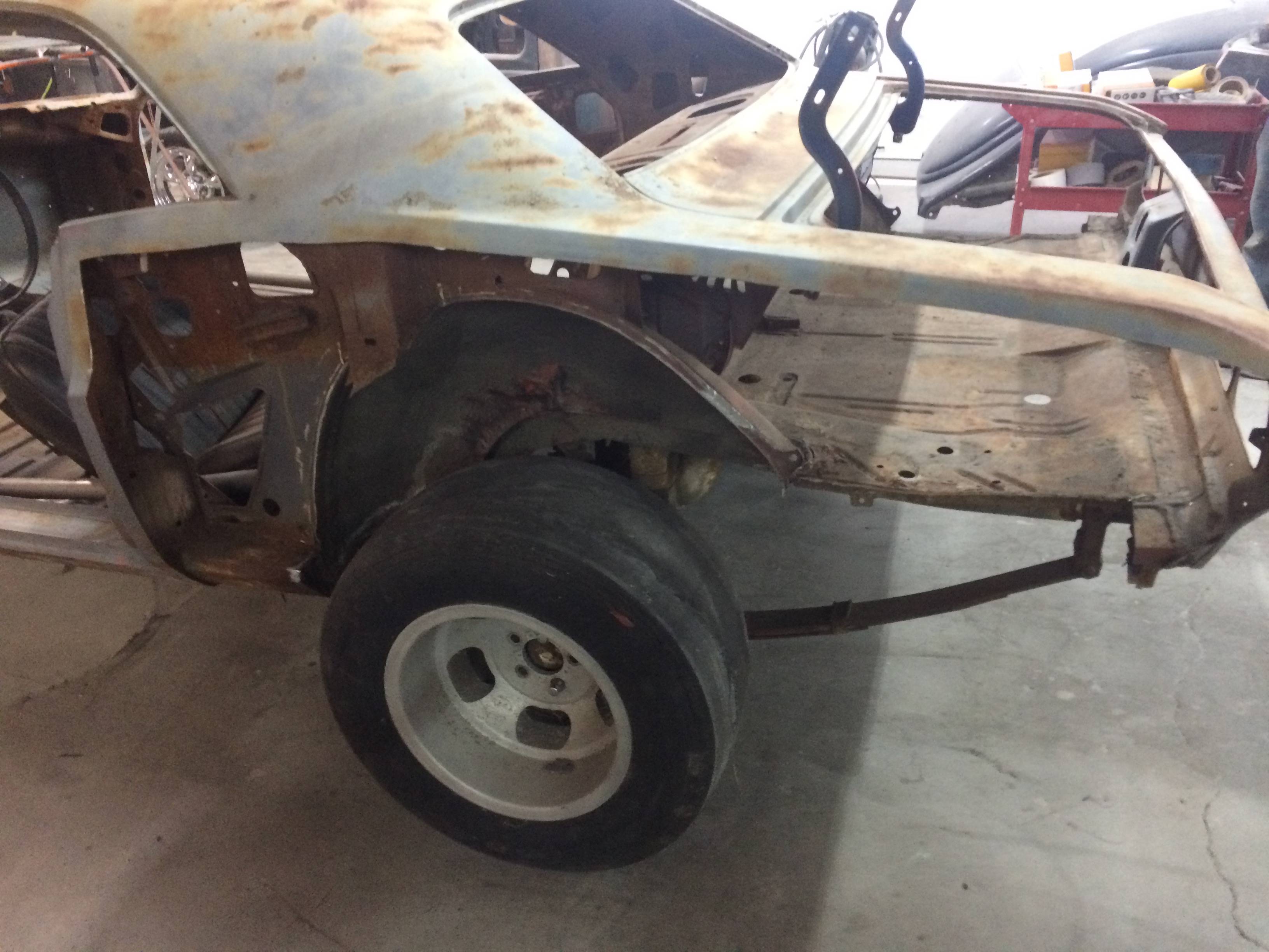

I have also mini tubbed many Mopars if I can help .
Thanks for the offer. I should be starting next weekend as the body shop called the other day and said they should get my quarter skins on either Thursday or Friday this week. We'll see...
