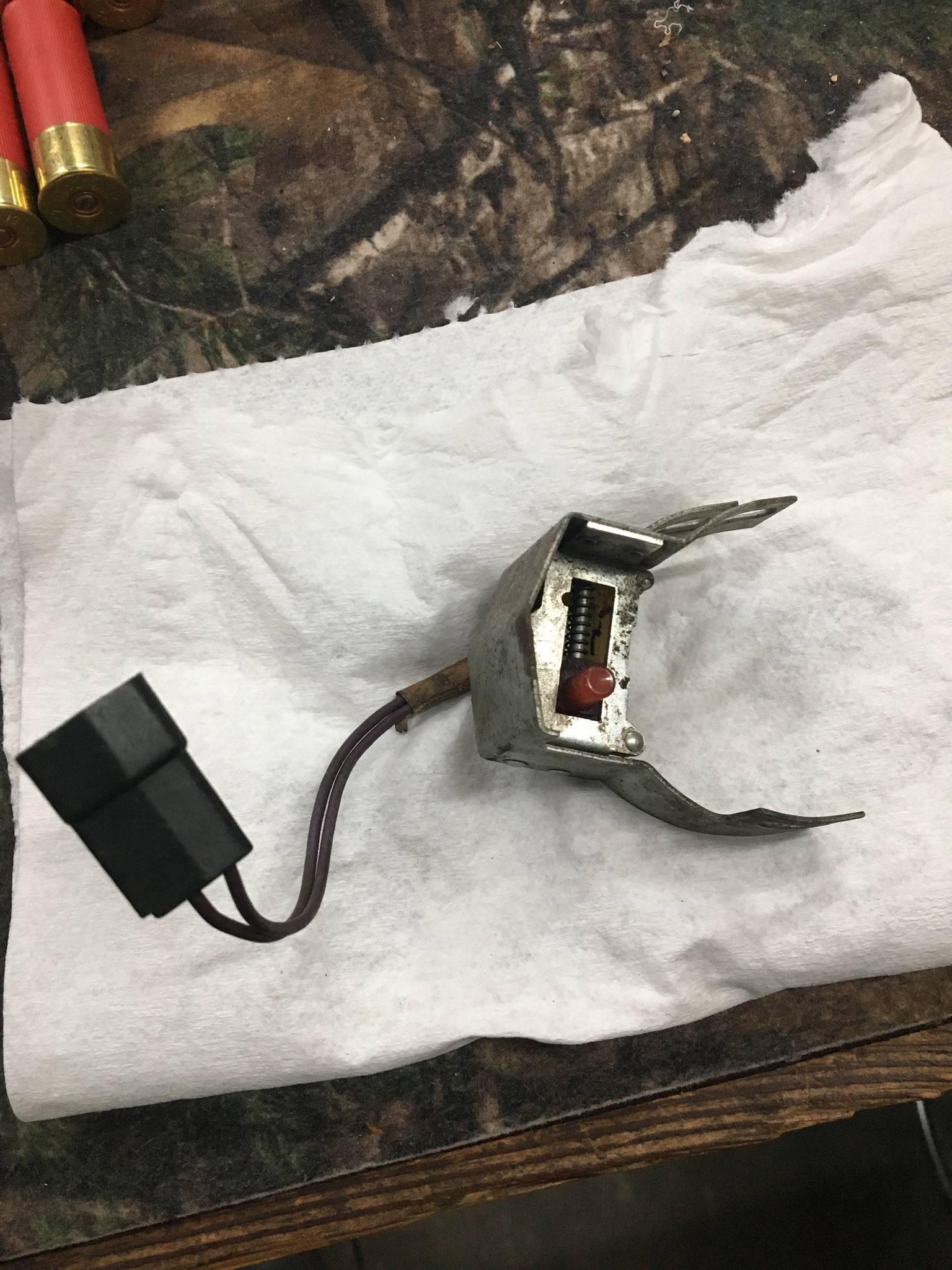

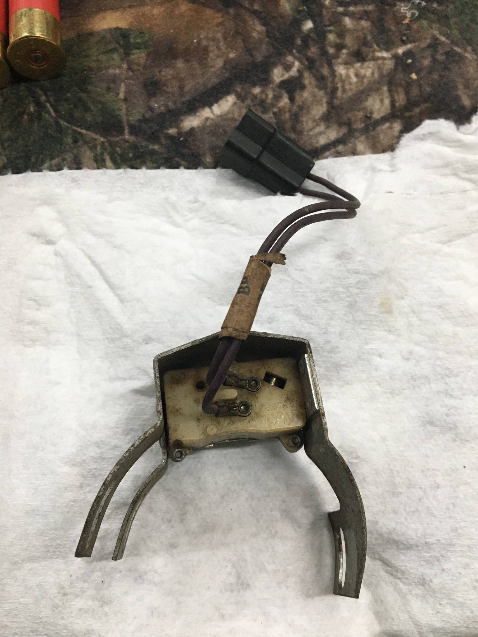

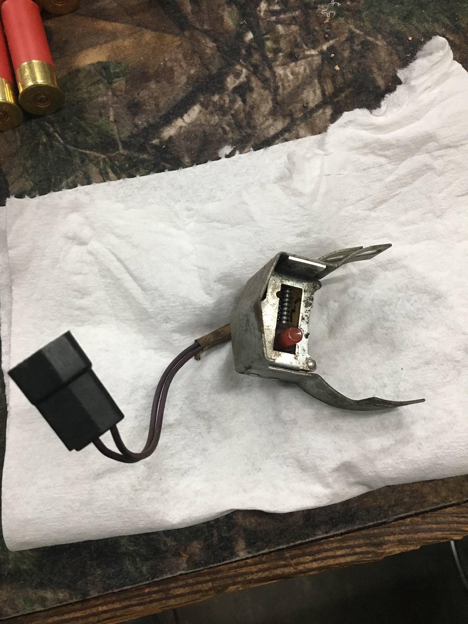

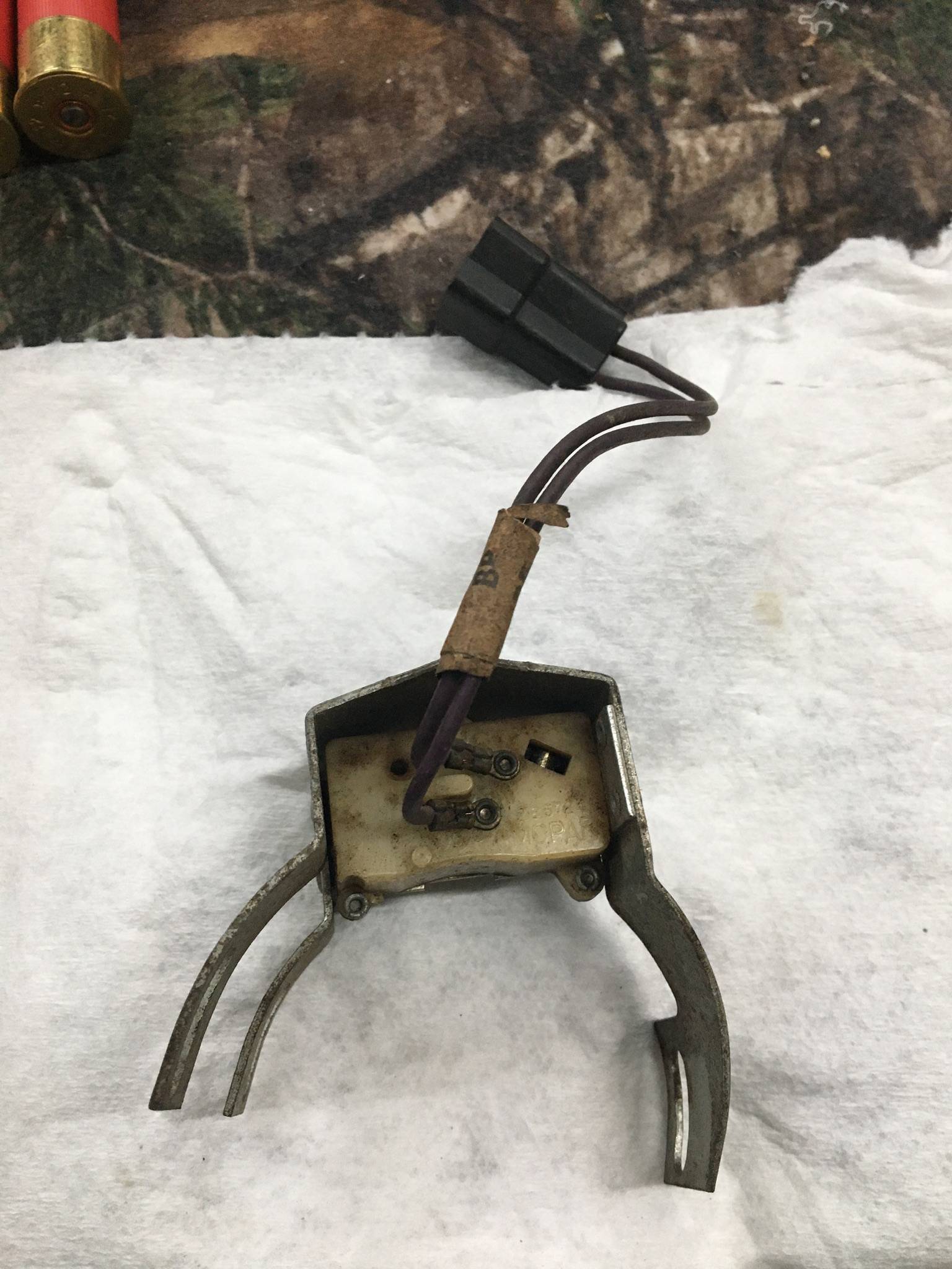

Can someone tell me what this is for? Thanks

Looks like it mounts to the bottom of the steering colum. Is there a number on the paper tag ? Or a stamped number on the parts? Should be a Pentastar stamping on it if it is Mopar.

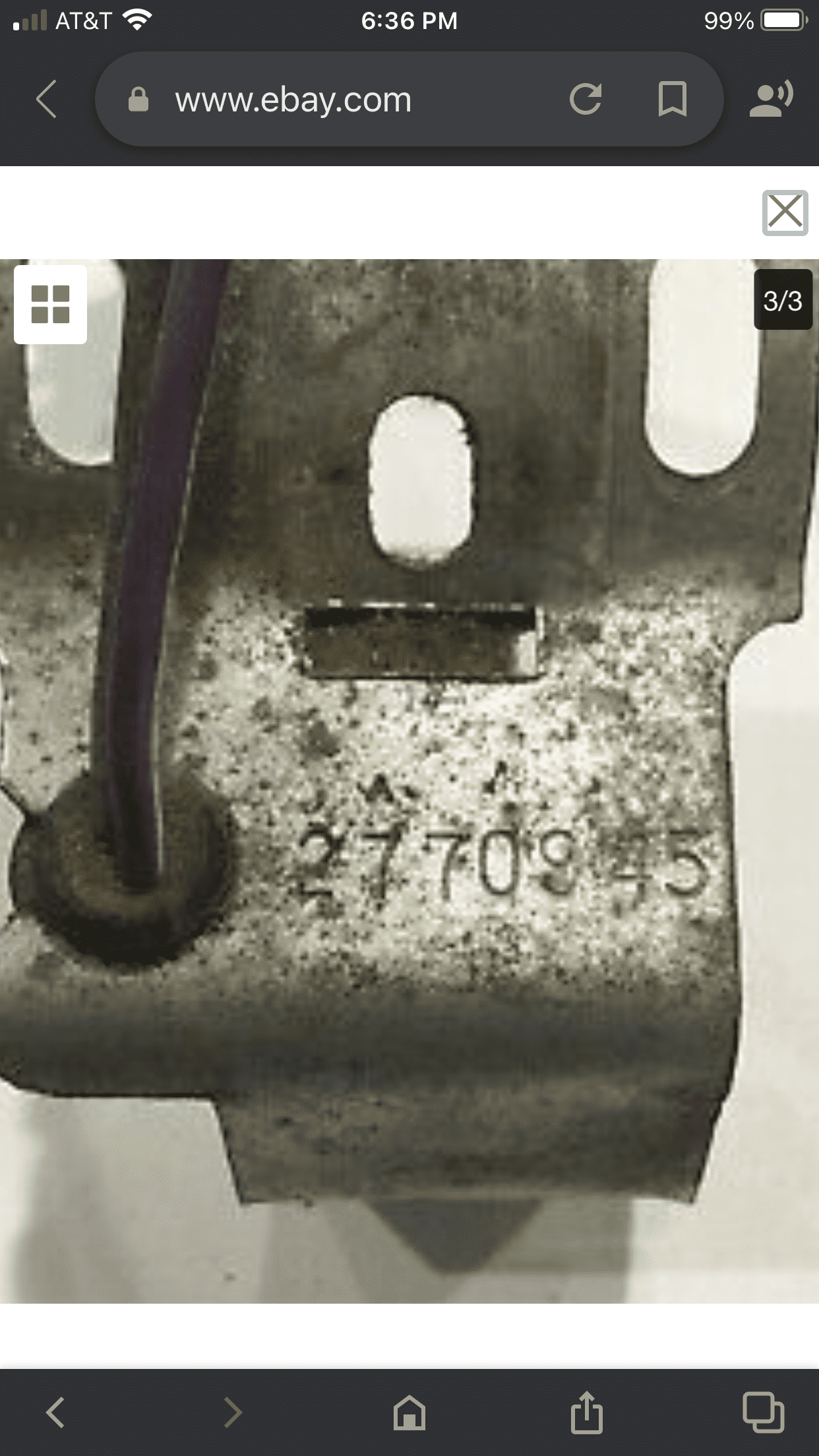

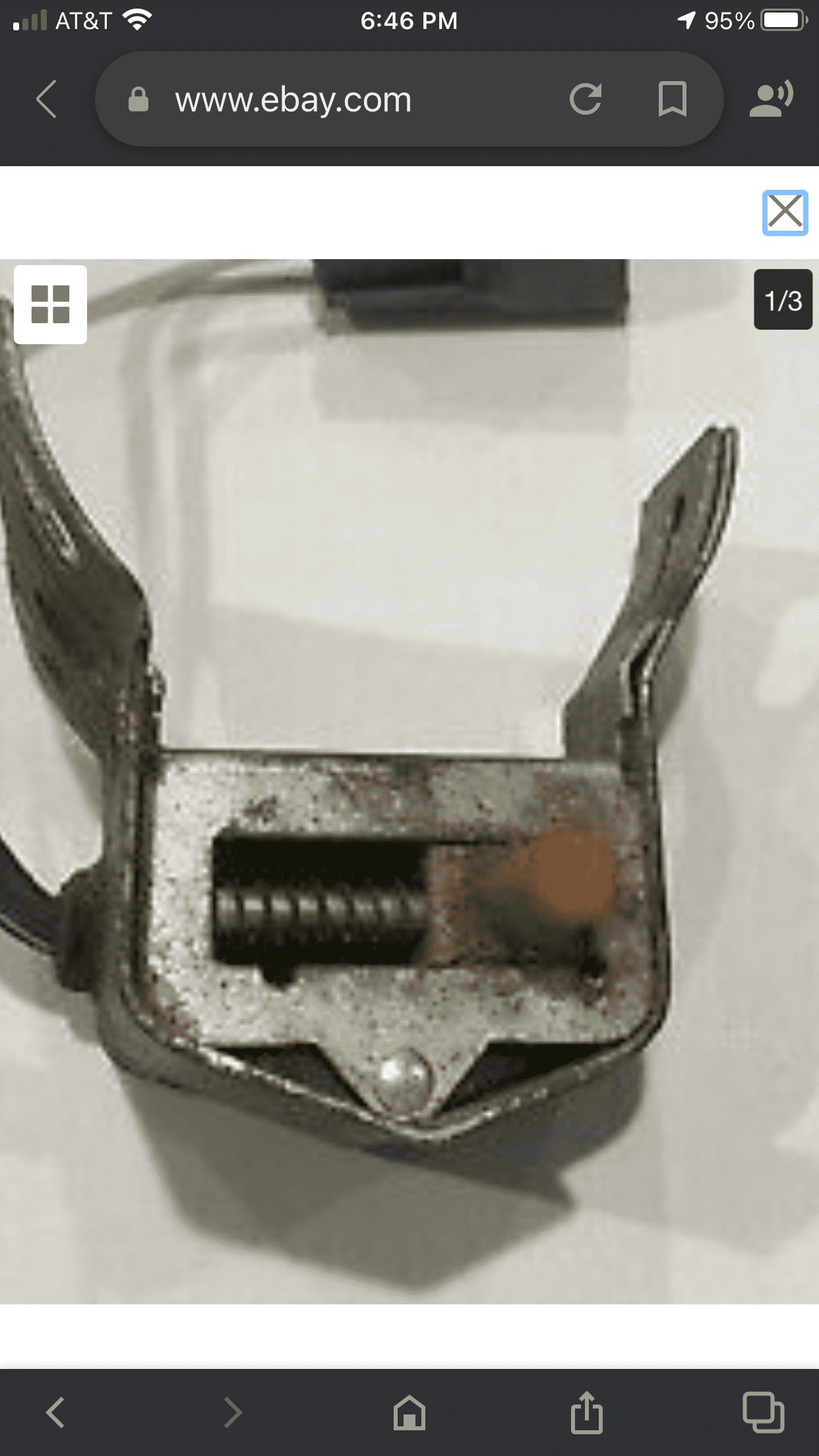

Check out this pic (number on bracket). Appears to be a backup lamp switch, maybe from a column shift car. I found it on eBay. I’m just not familiar with the column shift internals. Advertised as a c body ??? It does however look just like what you posted.

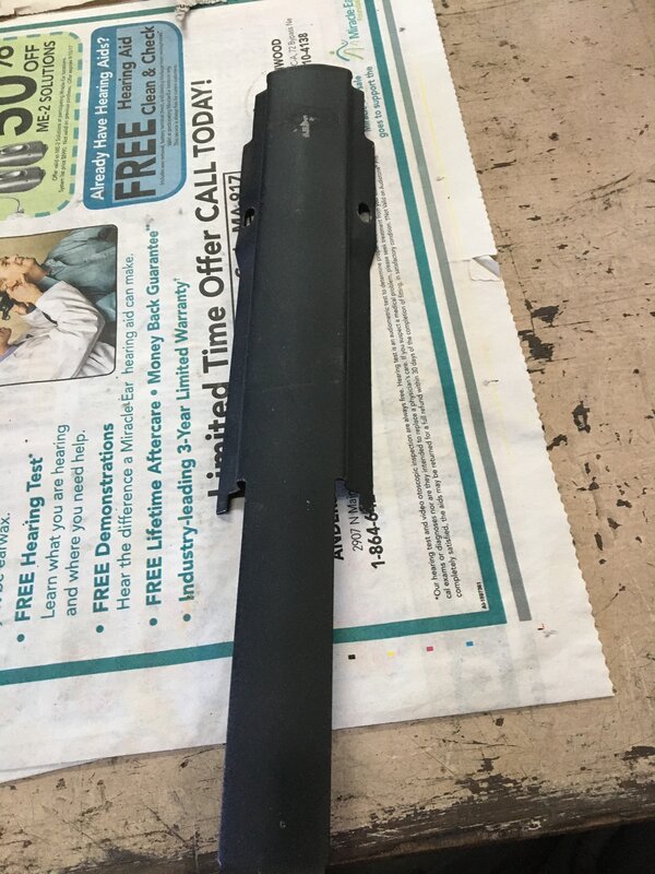

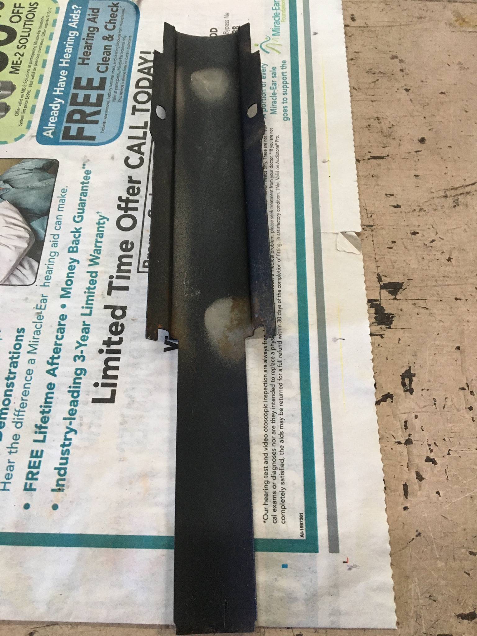

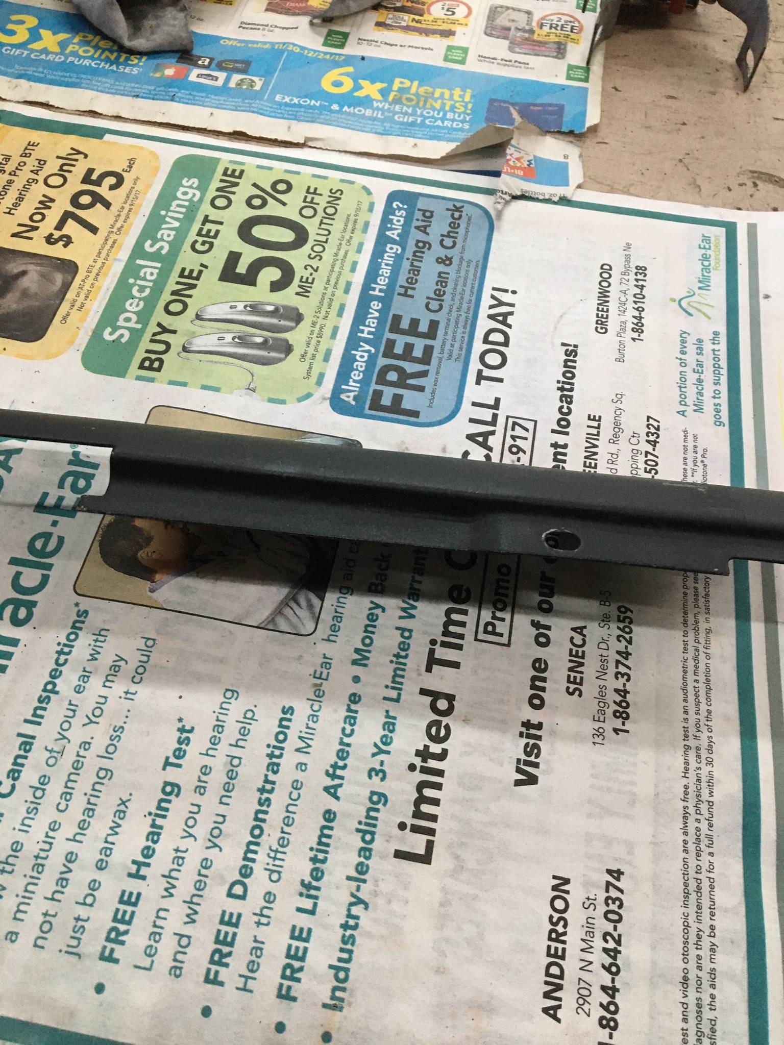

Do you know what this goes to? Looks like under dash piece maybe that covers up something I don’t know.

That‘s an impressive sounding collection of parts but I don’t really need any E-body or Hemi stuff. I’d be more interested in any oddball C-body or Imperial parts you might have like the switch you opened the thread with.
