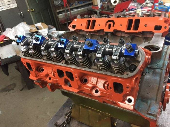

I like the OE look also versus all the bling of a serpentine system. I see you changed out your radiator but kept your power steering. I am having my original radiator rebuilt with a max-cooling core versus the stock 3 row core in order to keep the original look. I am considering upgrading the K member to include rack and pinion steering so the power steering pump will be gone. This will also give more room for headers and larger milodon oil pan. I painted my engine Mopar orange because even though it is the original 340 block since it has a Stroker Kit, it is now technically a 411.

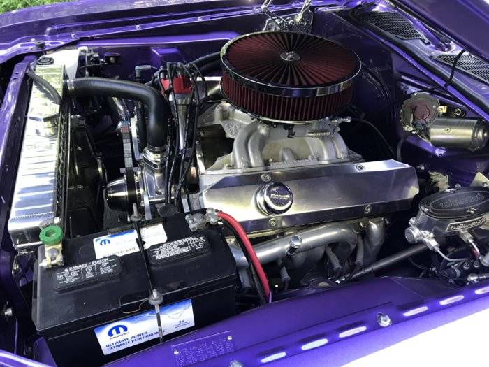

Mine is a 5.9 stroked to 408. I didn't have a radiator when I got the car, so I bought an aluminum one. Seems to be working fine. Although not in the picture here, I used a dual electric fan from a Ford Taurus. I thought about rack and pinion but ultimately decided to have Firm Feel rebuild the stock one. I painted my engine Mopar orange because I love orange engines! Here is a pic on my 71 BHG car. Rod

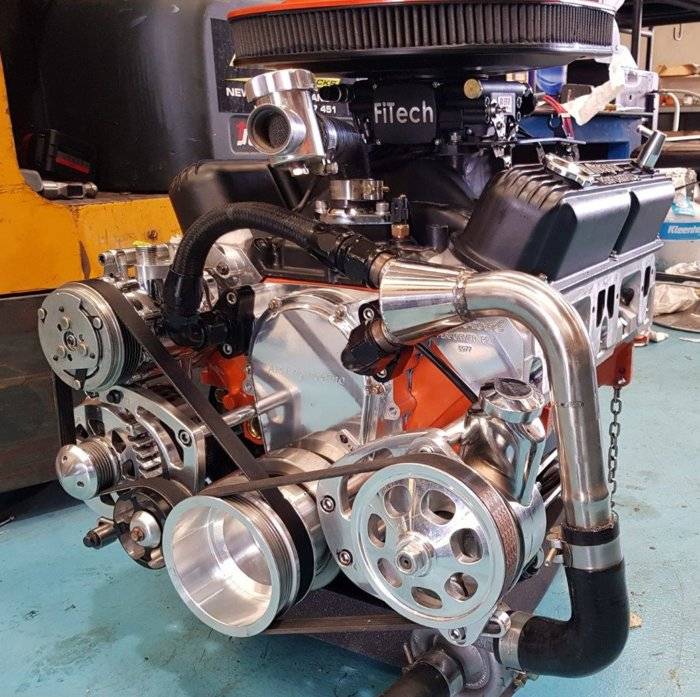

The one issue you will have with going to serpentine belts is that the original AC unit does not have a way to convert it as far as I know. You could go with a more modern replacement compressor like the Sanden though. I am still considering this on mine, but since I will be going with a aftermarket AC, it makes that a little simpler. If you want to go with a serpentine belt set up, I would consider something like the CFV stealth system. It comes with black brackets and pulleys like original, and you can even order a black AC compressor to match.
Chrysler Small Block Engine Accessories | Serpentine Conversion

Stick with the A belts if you go CFV go black A section
Serpentine are just to hard to get to track right trust me i have done it.

I have a 426 Cuda convertible tribute car and switched to CVF 8 rib serpentine belt system and love it. In my case it put the shorty compressor where the alt was and the alt above the power steering pump ( they supplied a GM pump. the system has everything below valve covers and looks great as well as dependable. Check with them and see what they offer for the 340. I am not a fan of having the compressor up high on the left side. I had shaker issues so that was not an option for me.
