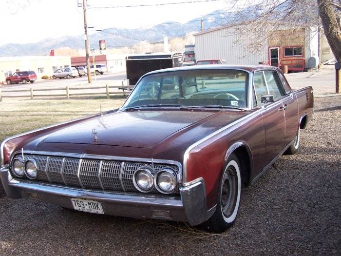

I"m working on a 64 lincoln continental. I put it up for sale back in January, and literally the next day the thing wouldn't start. Been in the family 25 plus years and always starts. I get the feeling it doesn't wanna go anywhere.
So now, I've rebuilt the carb, new fuel pump, new rubber all over the motor and now it won't run. So I'm replacing the rubber fuel lines. Not a lot of them. Hopefully that is why it won't hold pressure in the new fuel pump.
It's taken me forever to get parts. First it's the parts store, then it's the wrong rebuild kit, then buy a whole new rebuild kit for just a dash pot cup from the east coast. weeks to get here. then the fuel pump, specific rebuilder. Weeks to get here. this thing is driving me crazy as I want to work on my barracuda but my one garage bay is taken up by a ferd. well a lincoln anyway. Still! driving me crazy.

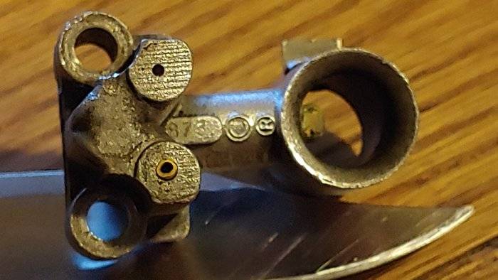

It's an ev3e carter 9510-e.
It has always been a good carb. I broke one of the brass tabs on top of the primary drivers side venturi and I'm having hell finding a replacement. I mean it seems impossible. Even on the lincoln forums I can't get any love.
Replaced the little bit of fuel lines. the rear two that were 6" going into the tank were rotted so I am attributing the lack of the fuel pump being able to hold fuel to those pieces being cracked and letting air in.
Now I am replacing the fuel sending unit. Another few weeks of that car sitting in my garage. :BangHead::BangHead:

Sorry to hear that Cuda Hunter, I tried to have a look at a picture of the carb but can't make it out clearly. It is not impossible to rig something or repair it, is it?

No rigging this thing up. I would have to braze a new one on to the broken off part. I've not done that. And it appears to work without it. You can see the round brass ring on top of the venturi. The piece stuck up off of that about 1/2" and sticks through the top of the top plate of the carb.
I'm just trying to find that specific numbered venturi in the other picture. But it has to be for the drivers side as it has that little 90* piece on it. It's proving to be a very difficult part to find.

you know the part well and I am sure you have explored all the options but If I see it correctly, why not remove the stump of the brass tube and stick a new tube in there? That way you don't need to braze anything. I hope you don't mind my suggestion, just trying to help if I can.

Well, the brass piece that comes up has multiple holes in it and is not just a straight brass piece. That's a good idea though. I'll consider that. If I could figure out how to get the tube out of another venturi that would work. I assume I could just drill out the broken piece but not sure how to get another piece out of another venturi.
I hadn't really gone that route in my mind yet. Thanks for the suggestion.
