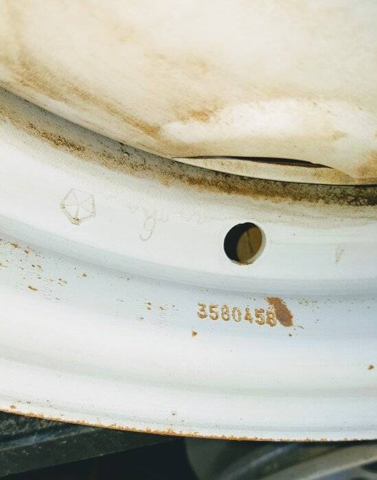

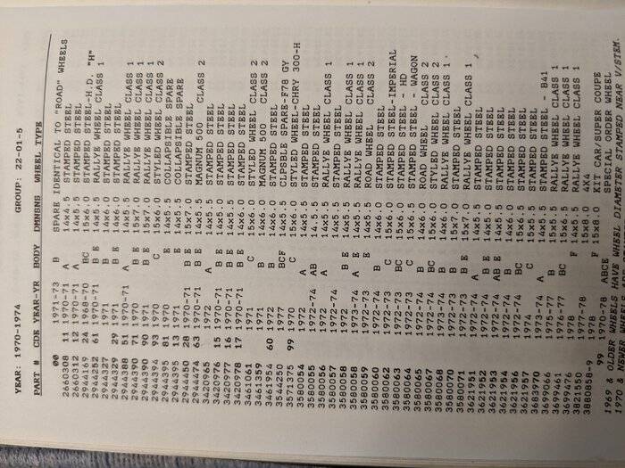

Typical factory installed 14" Rallyes were 5.5" or 6" wide.
With the wheel off of the car you can feed a tape measure through one of the oval shaped holes in the center of the wheel and measure the rim width easily. But 7" were not available as standard.
