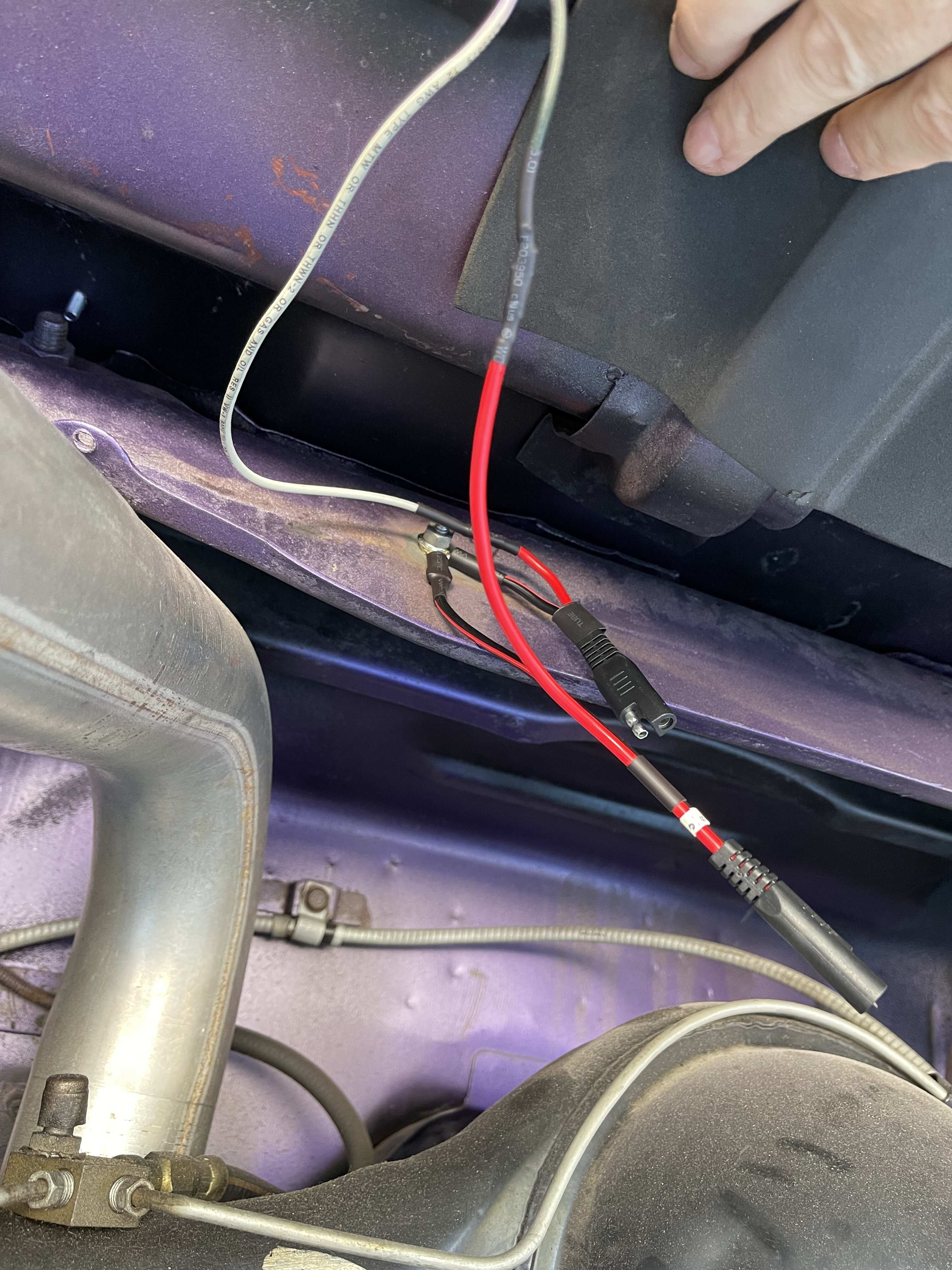

Completely agree with running the electric fuel pump wiring through the interior at the driver's side rocker and then through the trunk floor to the tank.
I utilized Quick Disconnect connectors for both the fuel pump power and the fuel level sending unit and a solid body ground right at the rear cross brace.
Be sure to solder and heat shrink every connection.
