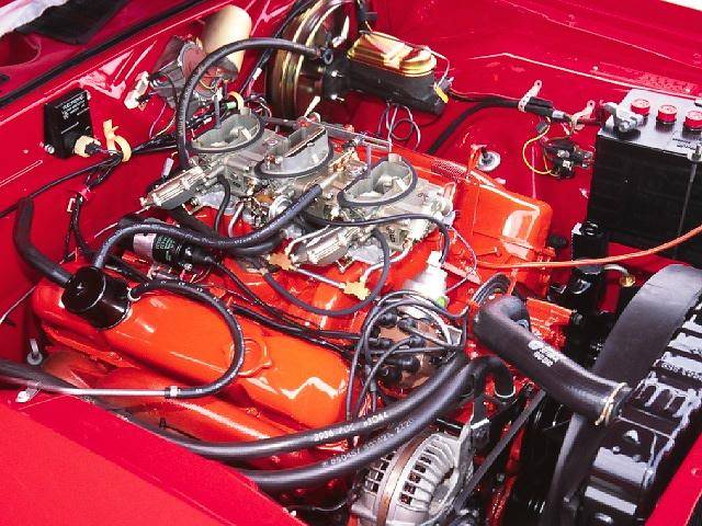

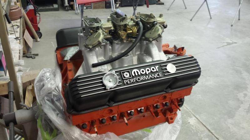

If you don’t have E.C.S (Evaporative Control System) on the car, either the correct three nipple crankcase breather or a functional charcoal canister vapor recovery system, remove the hose from the enclosed bowl vent valve nipple and leave it open to the atmosphere.can anyone tell me where this hose from the center carb goesView attachment 19979
