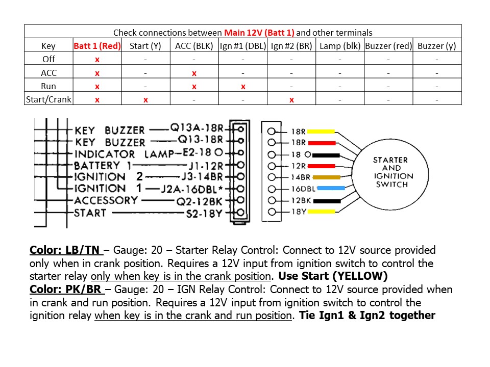

Sounds like the run and start wires are switch somewhere. Check the steering column plug and the bulkhead connector. Make sure there in the right location.
22 Brown 23 Blue Remove connector under hood. Connect test light and check if it's working correct. You should only have power to the brown when in the skey is in the start position.
Could be new ignition switch has failed in the start position with voltage not going to the coil and bypassing the ballast resistor. You may need 2 people to check this out. 1 turning the key to the start position and you checking voltage at coil.
Agreed, that's where I'd start.
Measure voltage to coil/ballast resistor while trying the key.
Disconnect connector on column and you can do it yourself.
Ignore stuff at bottom, that's for a 3G swap.
