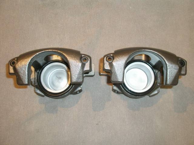

In all my years of rebuilding Mopar brake and suspension components for resale, i have only come across two pairs of the wide mouth calipers.
Very rare items to come across, now a days in the 2022's.
How many cars were built back in 1970 the dinosaur days, with disc brakes?
Not that many, out of total productions.
The wide mouth design started out on the 1969 "C" body line of cars.
They are a bigger, wider, caliper to fit over a 1.250 inch width rotor.
So, when the E body cars came along, and 1970 and up, B bodies, the design was adapted to those calipers.
I have NEVER come across a pair of wide mouth, C body calipers.
