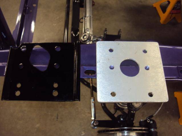

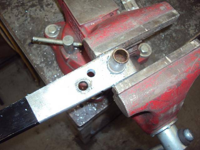

M/S plate
I used an aluminum plate. Also had to drill new hole on pedal for correct leverage

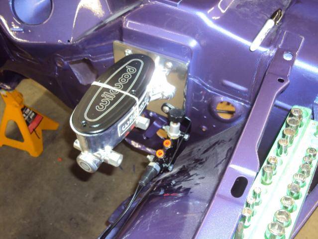

firewall
picture.php
So the block I have will cover the 6 lower holes. I am thinking of just welding in the rest of the hole above the block unless the master is supposed to mount higher then what I have

picture.php
We still haven't seen a picture of what you are dealing with. I just thought you would want something made for your application, that might cover the "giant hole" in your firewall. It also acts as a reinforcement for the firewall. You wanted to know which holes to use, the plate also will align you to the proper mounting holes for your 2 bolt master. You want to weld the master to the firewall ? Seriuosly? Do you really want help or are you pulling our legs ?[/QUOTE
The block I have will cover the bottom 6 holes and mounts the master. I was thinking of welding in the rest of the exposed hole unless the master is supposed to be up higher.
That does look good. The plate I got was a Mopar part # and only covers the the bottom 6 bolt holes.
Have not had time to put it in to check the alignment and is going to be a bit lower then yours.
