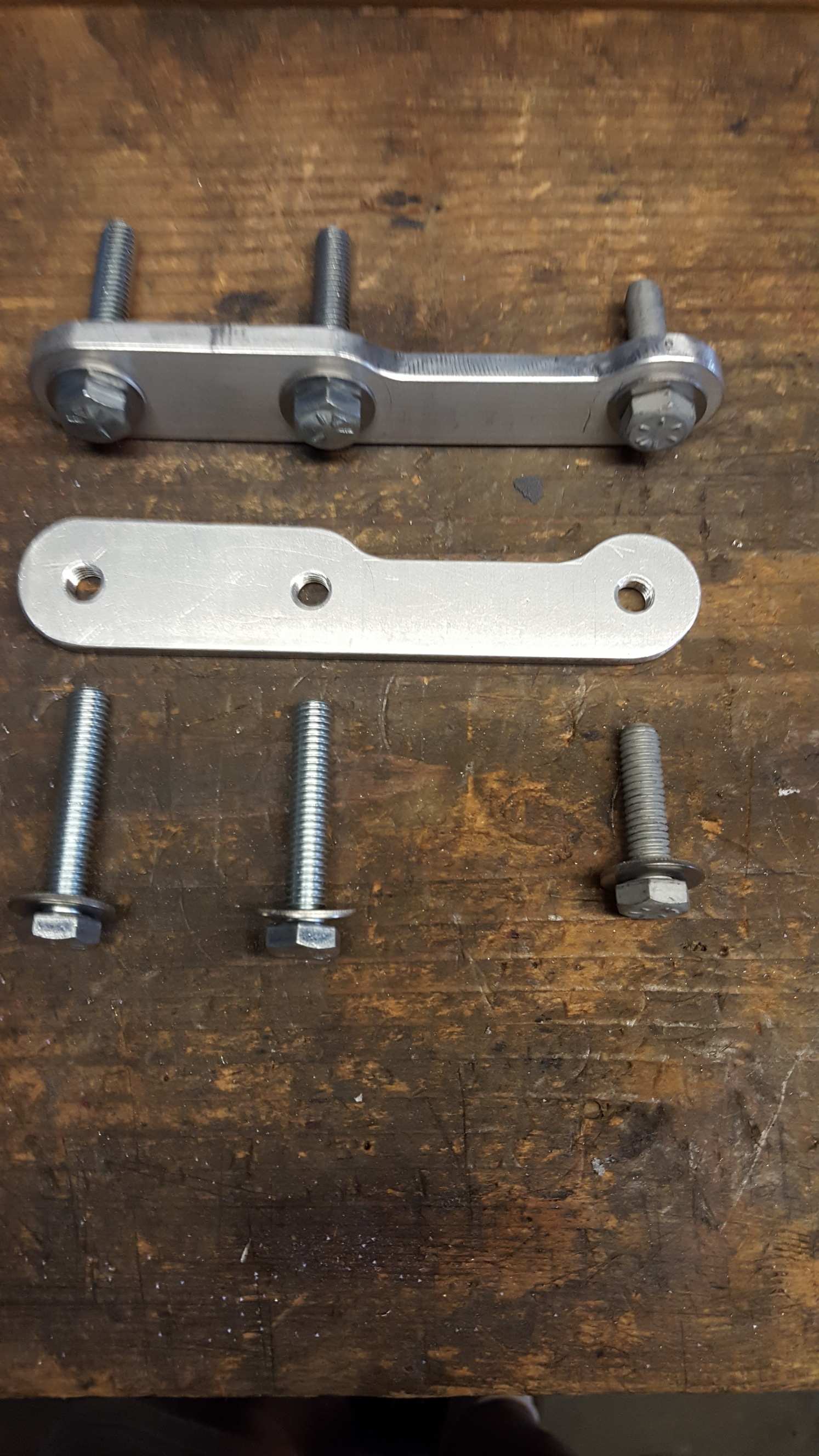

Instead of pressing studs into the master cylinder, I made stud plates that I installed from the interior side. I needed these after switching from power to manual brakes and an aftermarket master cylinder. The studs are actually bolts that are threaded into a 1/4" thick plate. Looking from the engine bay side, I have four studs to mount the master cylinder and two studs above the master cylinder to mount the wire looms.

Instead of pressing studs into the master cylinder, I made stud plates that I installed from the interior side. I needed these after switching from power to manual brakes and an aftermarket master cylinder. The studs are actually bolts that are threaded into a 1/4" thick plate. Looking from the engine bay side, I have four studs to mount the master cylinder and two studs above the master cylinder to mount the wire looms. View attachment 137818
Very nicely done! Where there's a will, there's a way. :thumbsup:
And that's what hot rodding is all about! What is it they say about necessity is the mother of invention?! Good on ya!
