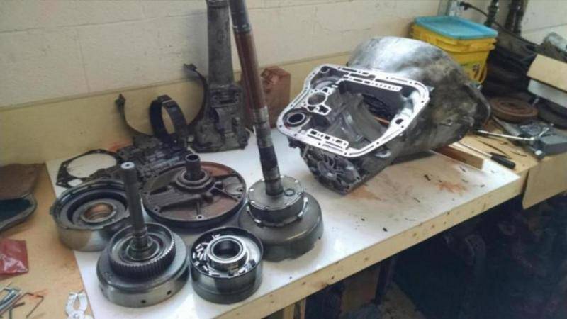

The cylinders were worn pretty good so I had to go .030" over.
As far as the trans? It took me a while but I finally found a used 46 RE out of a '98 truck on the Craigslist for cheap. The internals are basically a 727 with some improvements over our old 727s so it will be donating some parts. The sun assembly has 5 planetary gears instead of 4 and there's room for one more clutch disc in both the front and rear clutch assemblies. (This is per my trans guy, I don't speak trans very well...)

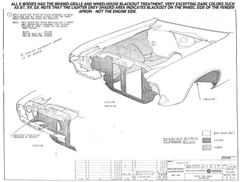

Hi Dematt1, Steve here. I have a '70 Cuda so I've enjoyed reading your post. :)
Just curious.....your car has the blackout paint on the cowl, but should it also have the radiator support blacked-out like shown in this Chrysler Engineering Drawing? Somebody else added the bold text at the top of this drawing, but the original text and artwork is from Chrysler. My Cuda is F8 Green, so mine did not have this blackout treatment around the radiator. You'll notice under the NOTES section in the drawing that the dark painted E bodies were exempt from getting the black paint in this area.
Just thought I'd mention it since you obviously want to do a correct restoration. But please do some add'l research and try to find pics of original cars that were built at the same plant as yours and about at the same time. 70-71-e-rad-blackout_copy_low_res.jpg

I'll make sure the blackout is done properly. Thanks for the info Steve.
You're welcome..... I'm curious to know what you end up learning about this detail for your specific car. My Cuda was scheduled to be built on Nov. 12, 1969 at the Hamtramck Plant and the date on that engineering document is Feb. 1969. The black-out painting directive could have changed in those months, or it could have been a plant-specific thing, or as MMISSLE correctly reminds us.... "No absolutes on a production line." :)

Hey, question for all you '71 owners. Is the top of the cowl supposed to be blacked out?
challenger6pak
Feb 27, 2011
4,087
923
The two I have here are not blacked out. Neither came with the center hood blackout. That may make a difference.

Thanks Tod! I phoned a friend on this as well and it seems '70 was the only year that they blacked it out and the battery tray was sometimes body color and sometimes not.

Matt, my '71 RT which I bought new back in the day does not have the cowl black out and the battery tray was painted body color.
