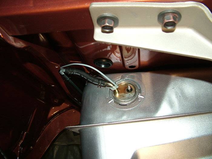

Ah ok. That makes sense. Thank you so much for your help! I have another question though. how do I make my gas gauge work? it has a new sending unit. but nothing. And why one of my headlights is brighter than the other one. And my turning lights never work, and I do have emergency lights and brake lights.

One issue at a time, what dash do you have? Rallye or standard? Do the other gauges work, temp and oil pressure?
Standard, I know they worked because before breaking in my 440 whenever I turn on the key the gauges would move. It has a light for oil pressure, which comes on from time to time. I have an actual oil gauge that reads from 40 to 60 psi most of the time.

Start with these tests

If the gauge does respond, there is an open between the gauge and the sending unit. Put the blue wire back on the gauge, ground the blue wire at the sender, still no gauge response, check continuity on the blue wire to the fuel tank sender. There is one connection on this circuit (blue wire) in between the gauge connection and the sending unit. The dash harness to rear body harness (behind left kick panel) 6-way connector. Verify that connection.
gs73rallye
Jul 8, 2015
37
12
As a Mopar mechanic in the 70s, as far as the gas gauge, first check the ground strap on the fuel line at the tank. The sending unit has the o ring which insulates it from ground. there should be a flat metal ground strap going from the sending unit to the fuel line at the rubber hose. Also, Mopar gauges ground to full, open to empty. GM does the opposite.
72RoadRunnerGTX
Jan 8, 2013
250
181
Shoreline. Washington
The sender/pick-up would not be insulated from the tank by the sender seal if the sender retaining ring is in place. The fuel line clip-on ground strap insures a ground path for the sender to the fuel line in the event the fuel tank is not fully grounded to the body through the tank straps. Normally I would agree, easier to start at the tank for diagnostic steps, except in this case where the OP describes already having the cluster out and if the fuel gauge was the only issue, not yet established here.
