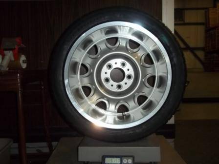

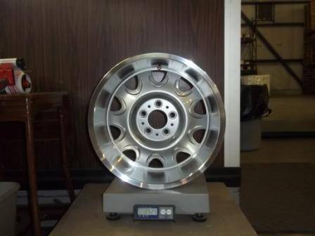

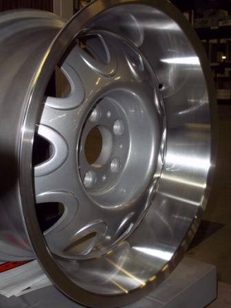

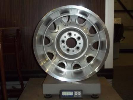

They are finally here.
Here's a quick rundown...
Front: 17x8 - 25.25 lbs
Rear : 19x9 - 25.8 lbs
Max runout - 0.011 over a quarter turn
Pics: 1-front; 2-Rear: 3-Rear
Tires should be mounted today!

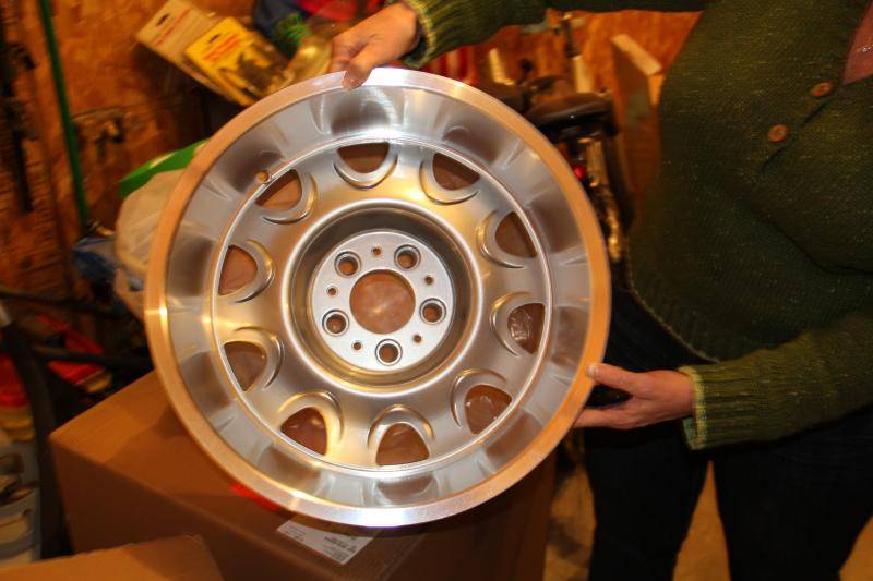

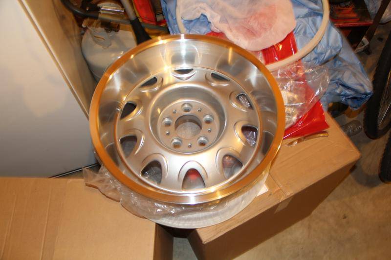

they are the most awsome wheels can't wait for the tires and center caps to get hear. had a really hard time finding the proper tire heigh and width and it looks like 255/50/17 rears and 245/45/17 fronts IMG_4234.jpgIMG_4233.jpgwas going to put 17x 9s on back but after measuring everythink i couldnt see how to get them under there. granted i have rear wheel disc on our 70 6pk cuda but they just wont fit. i wander if anyone else could get them under there. can you guys who received these wheels from yearone beleave the way they were shipped. and all the protection they took to prevent damage. cutos to yearone.

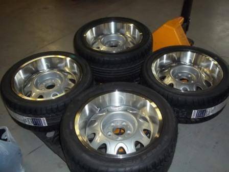

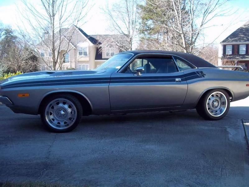

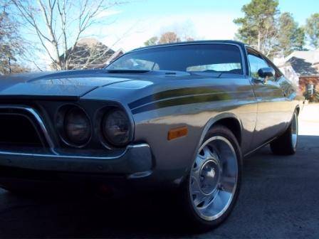

I'm putting the 9" on the rear. I'm waiting for the rain to stop so I can roll the car onto the driveway to mount up. Saturday is supposed to warm and dry.
It is good to hear they were shipped well; I'm lucky enough to live less that a half-hour from Year One so I picked them up Monday on my lunch hour.

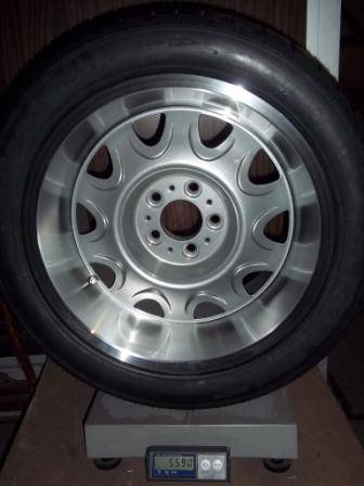

The front 17x8 with a 245/40-17 is 51.5 lbs.
The rear 17x9 with a 275-40-17 is 55.9 lbs

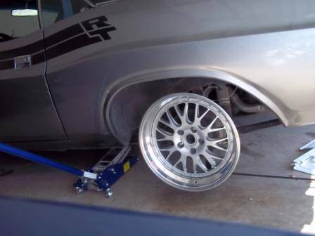

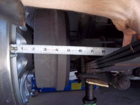

The bottom pictures are when I was test fitting for some 3-piece racing wheels. (They were way too expensive to pursue though) There should be room to spare with a 9" rear. Although I don't know how the disc brakes on the rear change things...

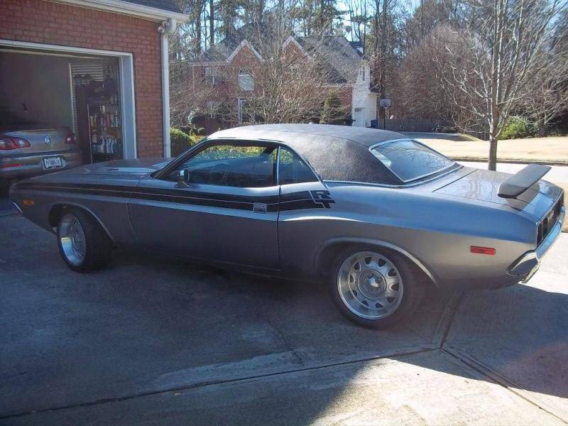

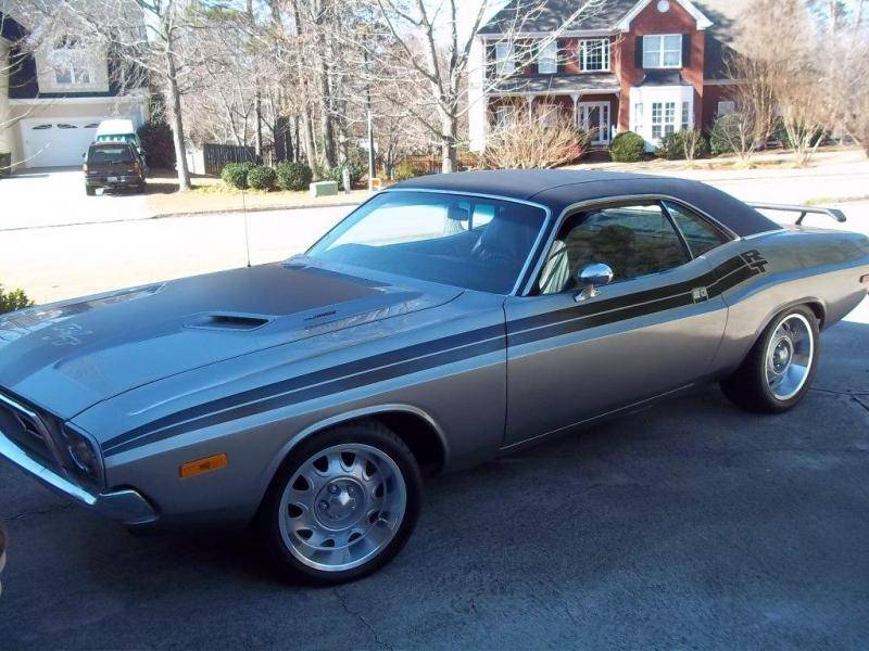

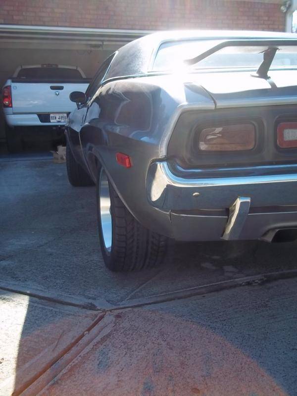

Here are some photos on the car
No fit issues at all.

A taller tire defeats the purpose. Larger wheels were designed so that a tire with less (shorter) side wall could be run on a car. Less side wall means less flex and better handling when compared to a 15 inch wheel and tire combination that is the same overall height and width.
Thanks for posting the pics. I have wanted to see the new wheels on a car.
