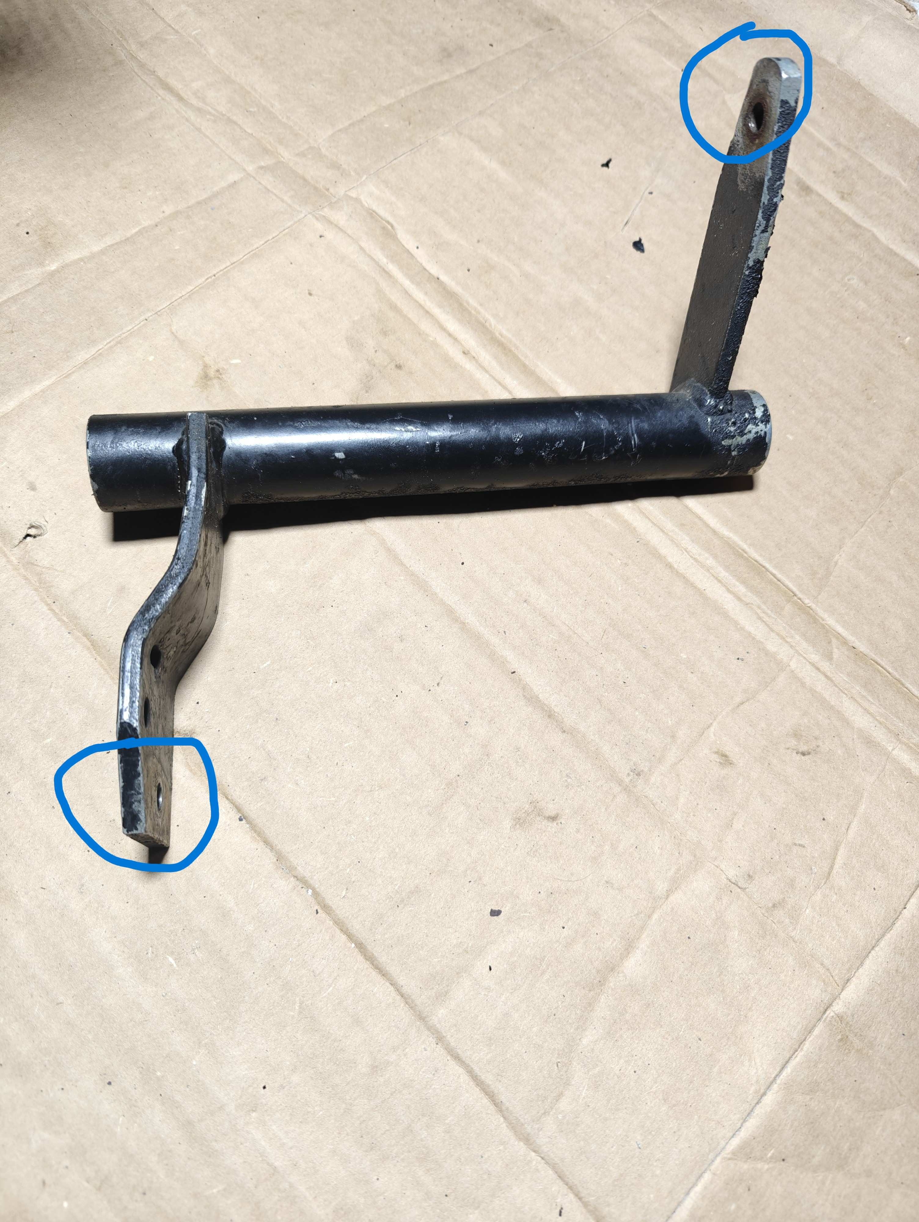

I've had this car for about 6 month and the clutch has always felt a bit off. There is a bit of squeaking when the pedal is depressed and when letting off the pedal sometimes it doesn't come all the way back up. If I tap it with my foot it pops up. I also noticed the z-bar looks a bit crooked from frame to bellhousing.
I thought maybe it was those little vinyl bushings in the z-bar. So today I disconnected the linkage and removed the z-bar.
the bushing in the z-bar actually look fine and are nice and snug. however, there is no retainer clip on the frame side of the bar and when I look there are no holes in the z-bar for the retainer clip at all.

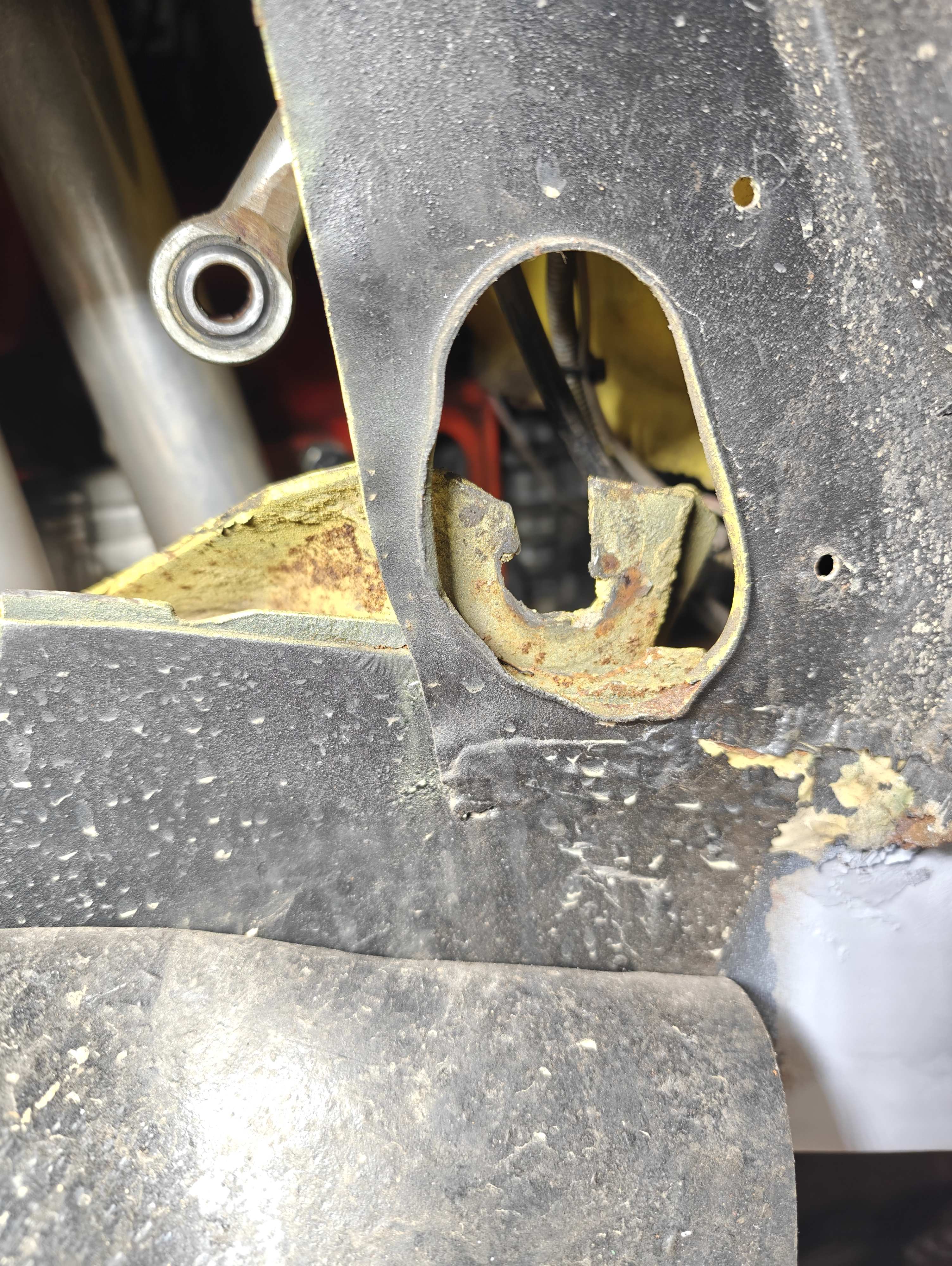

Then I look at the mounting point on the frame for the z-bar and it's all hacked up.

I'm not sure where to go from here... replace the z-bar mounting point on the frame? get correct z-bar.

I would definately replace the frame mount , there is a small notch to position it properly , you could just drill 2 small holes for the positioning clip easily

The other thing I'm confused about is that all the z-bars I've seen have a piece on each end to accept the rods. However mine just has holes so "stock" linkage rods won't work. all my linkage rods are ball joint type rod ends on threaded rods. Including the clutch pedal.. there is just a whole to screw a rod to.

Looks like previous owner made the Z bar and rods to his satisfaction. Seems like he preferred ball bearing linkage, then the plastic bushings that Chrysler used.
