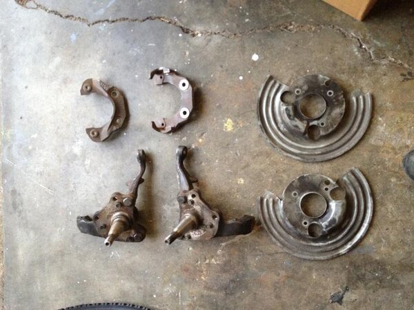

All the tools you think it will take and around 20 more you'll have to pick up, naturally on 20 separate runs to different parts/hardware stores. And tunes. You'll need tunes. Oh, and the spindles, caliper brackets and dust shields off of a junkyard 73 Satellite will be mighty handy too. I'd also recommend you score the calipers for cores when you buy rebuilds at your local parts store. I also got the Satellite emblems for my toolbox, just because they were cool. I've hauled these parts around in this box since '99, better late than never?
Some competent help never hurts either?
On the spindles: There's some debate out there online and in magazines as to whether or not B-body spindles and control arms bolt right onto our cars. They do. Gloriously.

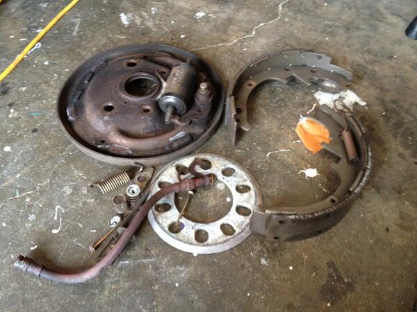

The Before:

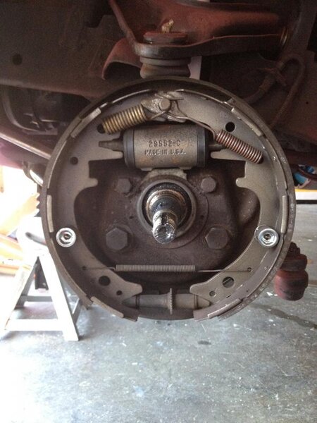

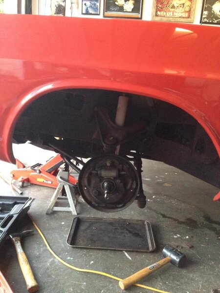

Step 1: Remove brakes?
:icon_scratch:

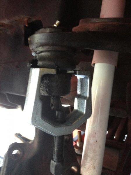

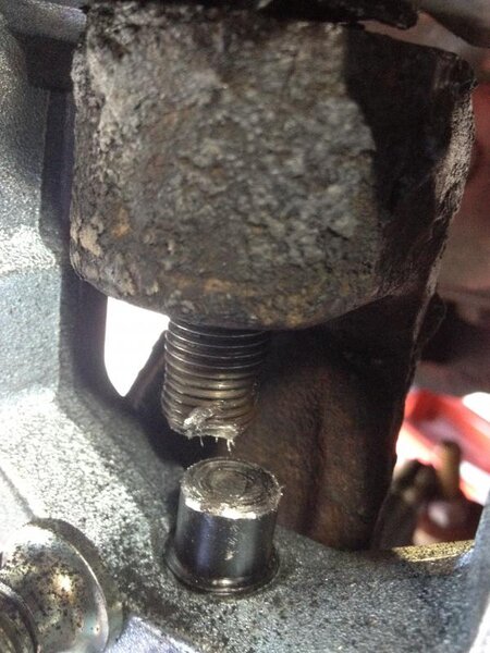

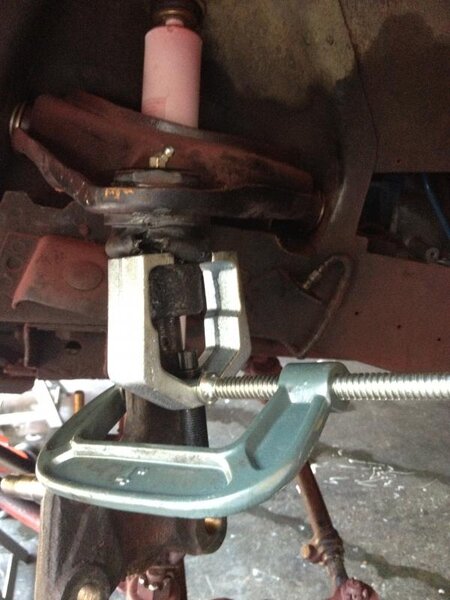

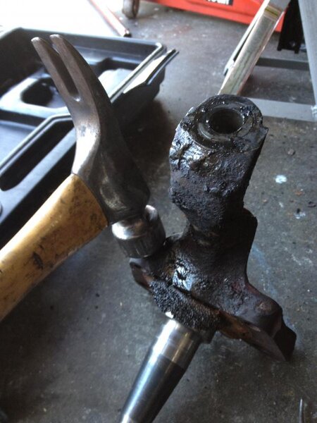

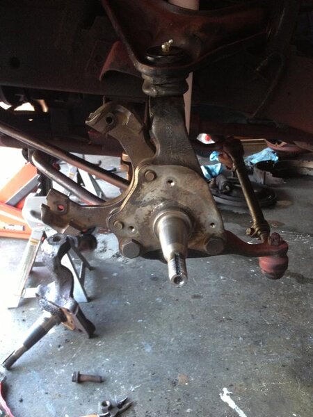

Step 2: Remove spindles. This was actually quite hard. It turns out a 21 ounce California framing hammer is a poor choice to hammer on spindles with. I tried this ball-joint separator tool and really gnarled the threaded end of the upper ball joint. I shredded the boot too. This is bad. Its bad because this boot and the ball joint must be pressed in as one piece, meaning technically I should have then pulled the upper arm and had a new boot and ball joint pressed in, adding a few more days (and bucks) to my project. I RTV'd the boot shut and hoped for the best instead. It's on my follow-up inspection list to see if it holds.
I was later informed by the excellent members of this forum that this part of the job is easily handled with smacking the same place on the spindle (pictured) with a much larger hammer. I picked up a 5 pounder and it did the job (without any more ball joint destruction) on the other side in a matter of minutes. These pictures represent about ten hours of idiocy on my part. Use the sledge, trust me on this.

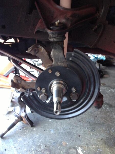

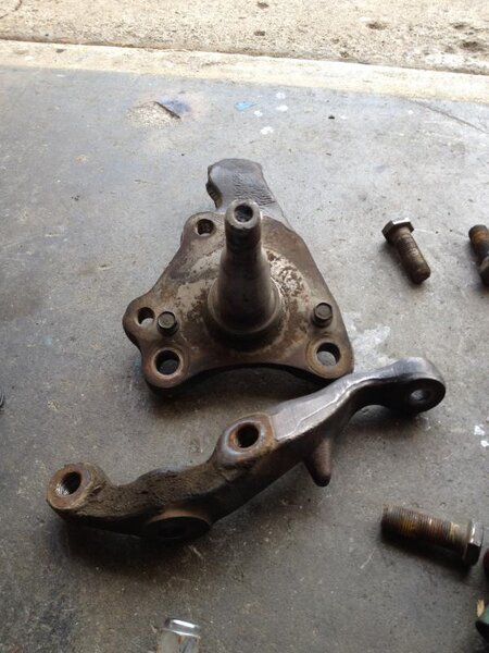

Step 3: Bolt up the new-to-your-E-body spindles. These B-body spindles bolted RIGHT in. I mean like PERFECTLY RIGHT IN. I didn't know this when I took the picture but they even preserved my alignment. I'm going to take it in and get her laser aligned to make sure nothing wears funny, but the steering wheel tracks perfectly centered, just like with the stock spindles.

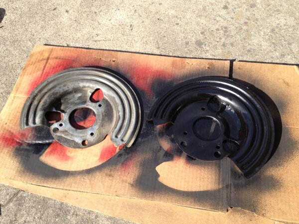

Cleaning up the old parts with a wire brush on a power drill is a good move. I used the axle nut to bolt a piece of PVC tube over the bearing surfaces to make sure I didn't scratch them up.
Step 4: Stand over this pile of inferiority, flex both arms and your chest and shout "I AM ALL THAT IS MAN!"

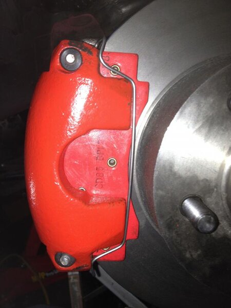

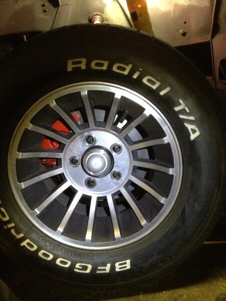

I painted the calipers to help me tell if the wheels were rubbing, NOT as a fashion statement.

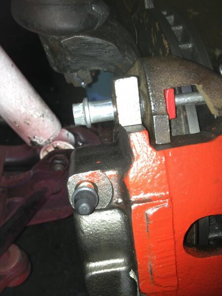

I didn't use these caliper pin clips. I think you need four of them for a proper install and I only had the two. Plus the common consensus on forebodiesonly was you can trash them. They just kind of bent when I mocked them up anyway so I'm not sure if they buy you too much. If anyone wants to weigh in I'd be interested if you use them. And if you bought them recently, where the hell did you find them?
Step 6: Calipers

Just FYI. The upper ball joint is not pressed into the arm, it is threaded and uses a special Mopar ball joint socket to replace. No need to remove control arms.
Much obliged... I will probably make it a point to replace them both either way based on that!

And no matter what the magazines say (Mopar Action...) the separator is useless. Smack the damned spindle with a BFH right at the joint and watch it pop.

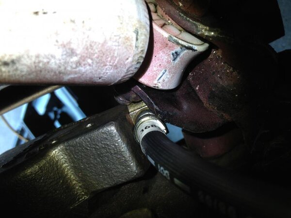

It depends on the type of Caliper used some use a flared hose that threads right into the caliper & have to mount in front of the spindle so the hose point though to the rear , other calipers use a banjo bolt & can be rear mounted .
The clips are just rattle clips , if you buy semi loaded calipers the clips are provided with the caliper , I alway use them just beacause the were there originally .
I agree with the hammer meathid to seperate ball joints !!

Also another FYI. No matter which side you mount your calipers on, the bleeder screw MUST be on top or you will never get the air out of the system.
I've had 'em towed in to my shop like that.
The one that drove me nuts as to why I couldn't get it bled is the one where the lines were routed above the master cylinder. Took me a while to figure that one out until I looked down and saw about 12" of line above the master. Folded 'em down and voila, bled out just fine.

I know I'm many months late with this but did a search for upper ball joints as I want to remove mine. I could see they were threaded (got entire arms out and cleaned up) and was going to tell the thread originator NOT to press them out as they will damage the arms! But moparleo has already pointed this out.
It is a common mistake to try to press them out. I have cleaned up mine of crud and rust and now soaking in trans fluid. I just bought a big wrench as the correct socket is way too expensive here ($84!) and will see how easy they screw out. If no luck I will make up a tool (weld some plates into a rough socket) .

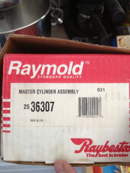

WOW Amazing write up!! THANK YOU OP for including the PART NUMBER OF THE MASTER CYLINDER! That's definitely not SOMETHING YOU WOULD REMEMBER YEARS LATER WHEN YOU NEEDED IT! I love this forum!! Suck it, Facebook Groups!
PS. Apparently the life expectancy on one of those bad-boys (Raymold 25-36307) is 2,017 days...
