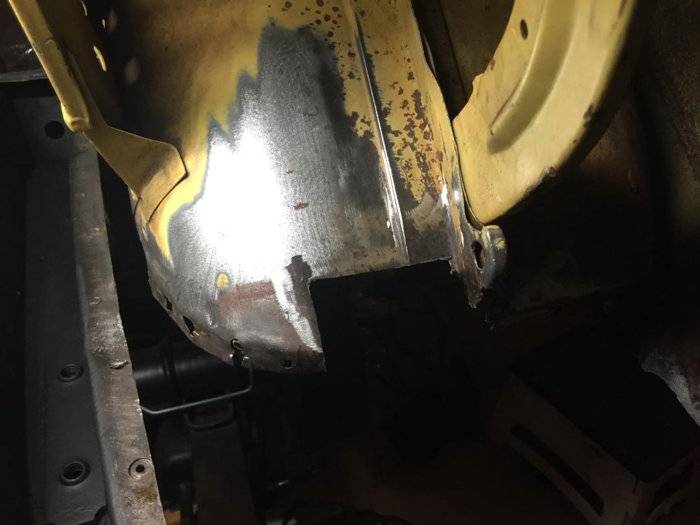

Lee, Thanks for your thoughts
Most of the floor is in great shape.
A small area below the gas pedal left side only needs replacement or patching.
The trunk and lower quarters are the most needy areas of the body.

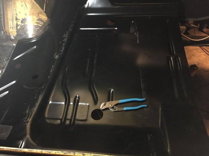

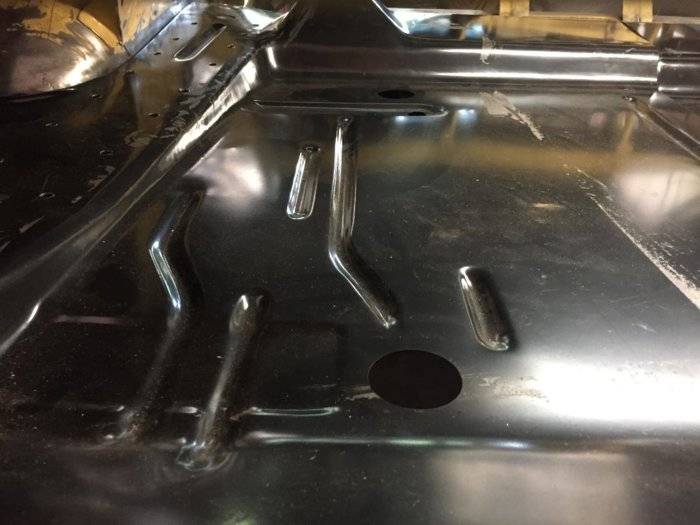

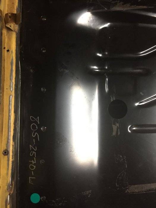

Started the early process of test fitting the new 2 piece trunk floor.
Just wanted to see what the Challenger looked like with a trunk again!

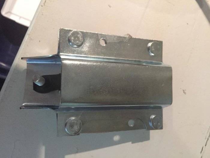

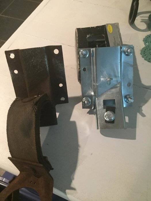

Just picked up a reproduction exhaust hanger bracket that mounts on the left side for a dual exhaust car from Accurate. Looks like a nice piece.
(Hard to believe the original muffler hanger is still intact)

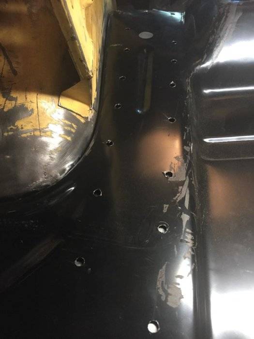

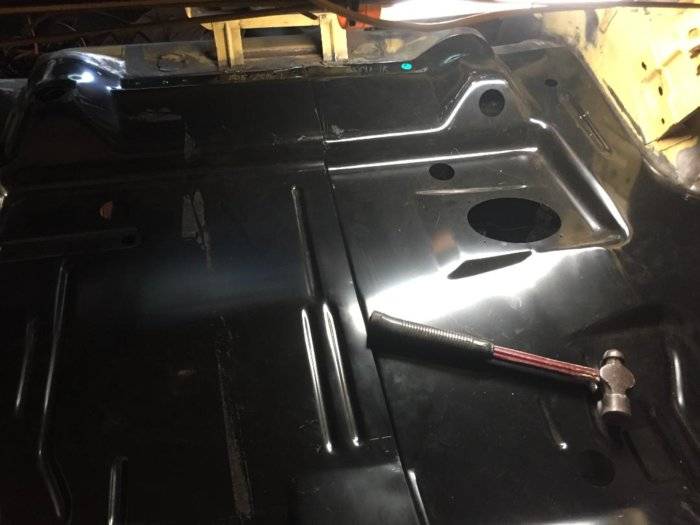

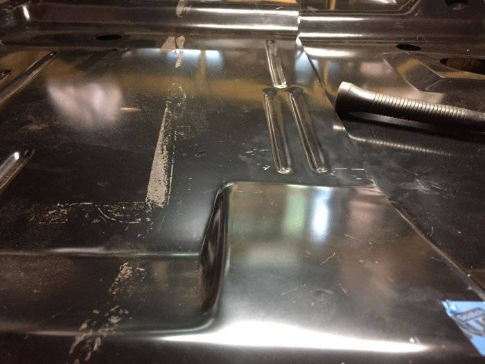

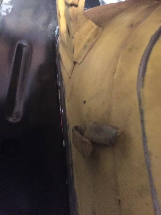

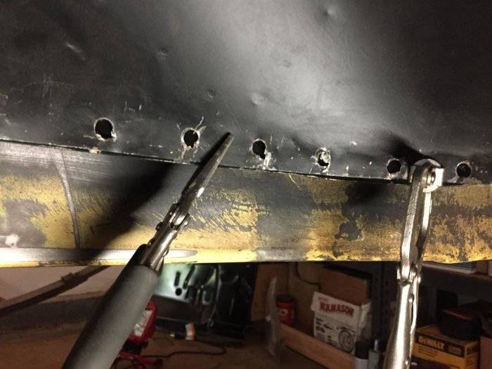

Fitting and "tweaking" the trunk floor to fit against the wheel well, trunk extension panel and back of the rear trunk floor panel.
I bent the back L shape lip at the back of the panel down a little to give more wiggle room.
Trunk extension on the left side is a little concave in the middle (needed to "bend" the trunk floor down a little to come close to matching.
Bottom of trunk floor seems to meet the frame rail relatively flat.
Toughest task so far; to get the side of the trunk floor to match cleanly to the wheel well. A lot of hammer dolly work to flatten this area along with the frame rails.
As noted by others, the BFH and a piece of 2x4 are coming in handy!
Glad I don't do this for a living.
Adam
Dec 25, 2012
1,694
758
Washington
Good work! Vise grips can be your best friend, in this situation. Also, just sheet metal screws, that you later remove and weld up.

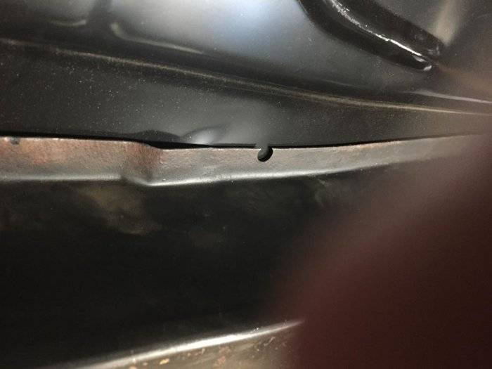

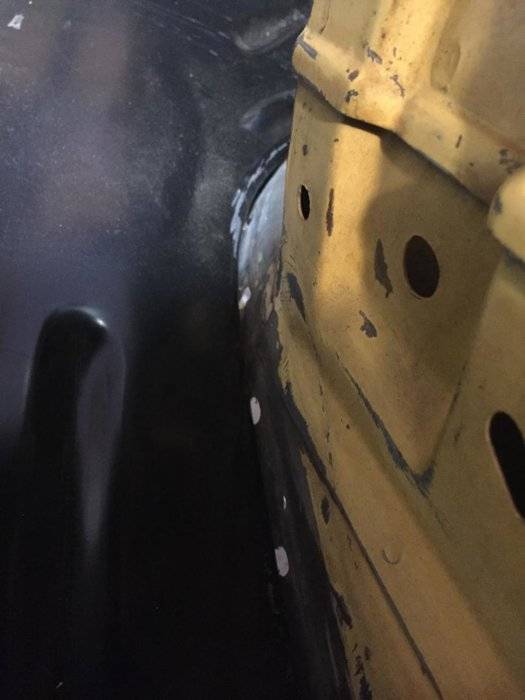

Trunk floor meets the frame rail well enough.
There was a natural bend in the frame rail in this area. Did it serve any purpose?

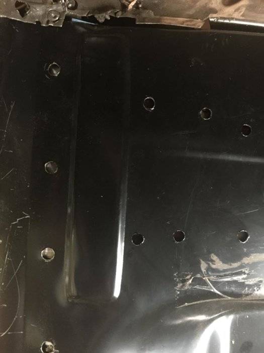

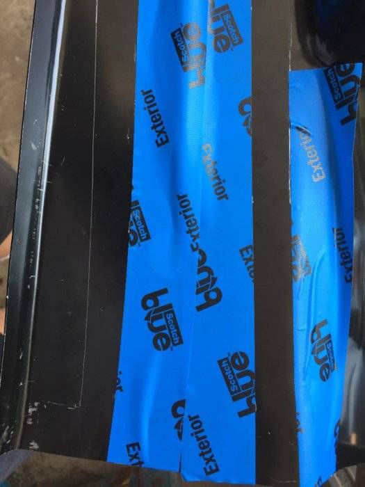

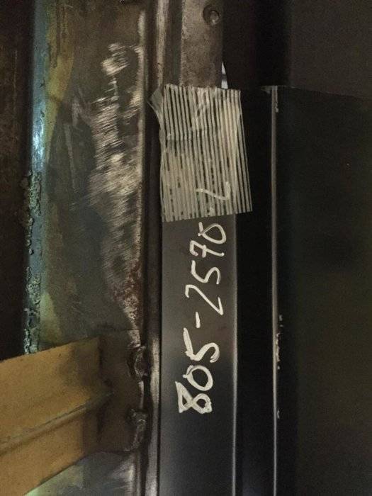

340challconvert
Feb 13, 2011
5,432
2,916
Parsippany, NJ

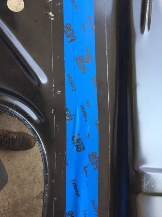

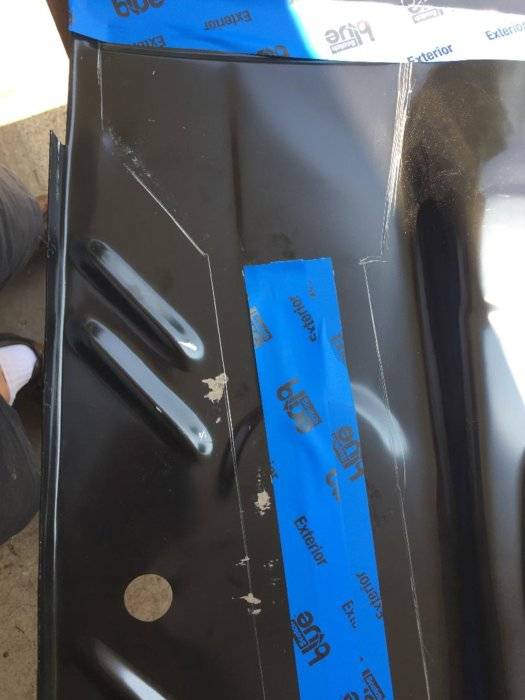

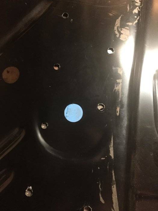

Laid in the trunk floor and scribed the frame lines on the bottom of the panel to determine location of drilled holes for the plug welds. Taped off the locations and drilled from the underside of the panel. Worked pretty well for accurate drilling.

moparlee
Jul 25, 2011
3,266
1,442
Mid Michigan
Looks good Phil:thumbsup:. You have a nice fit up by the wheel house. Now just screw it down tight and weld up all those little holes. Sounds easy enough ha?
