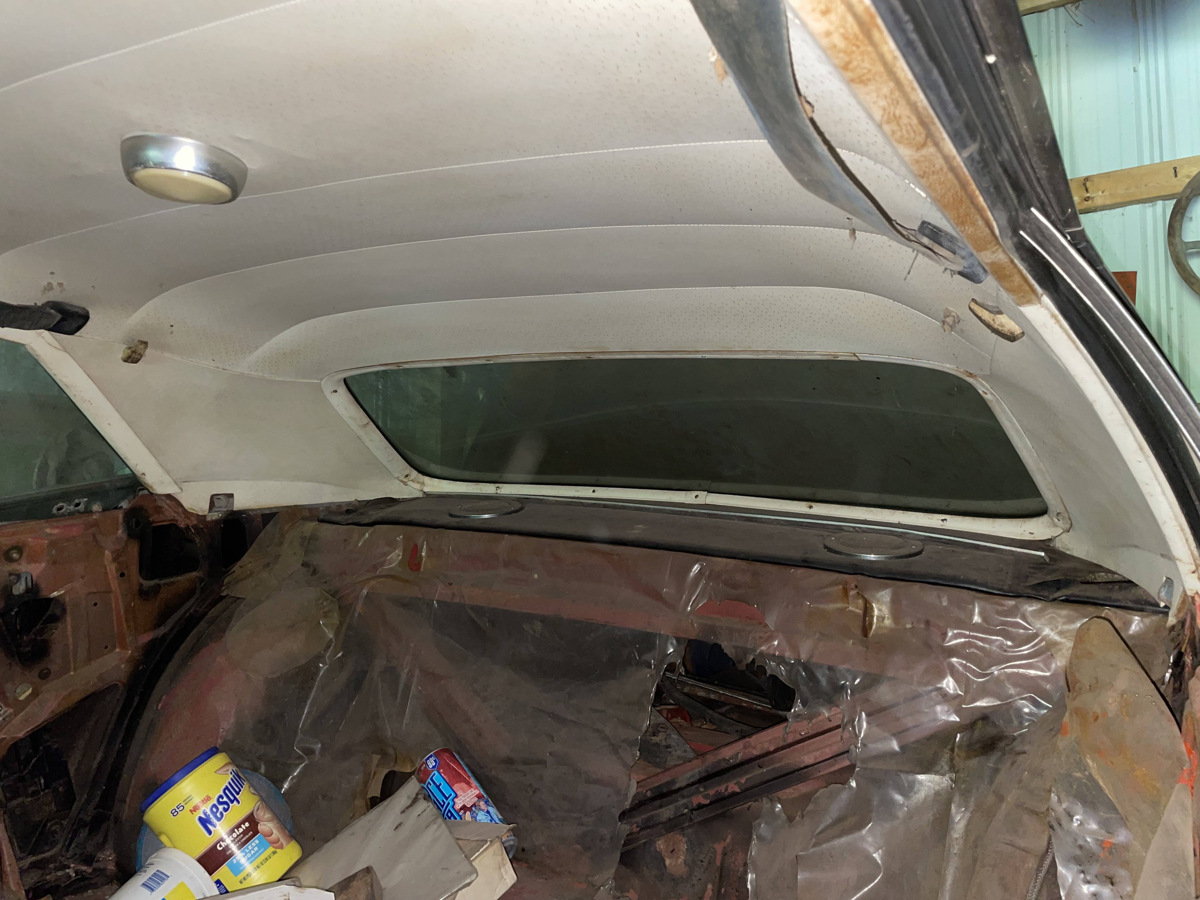

I went and took a couple of pictures of the car today
Speaker deck tray here is black however, it does not look factory
440WB
May 30, 2015
491
76
Michigan
Black seatbelts like you said
Also in this car the A pillars are black
It was dark hard to see the trim
when I took the picture
440WB
May 30, 2015
491
76
Michigan

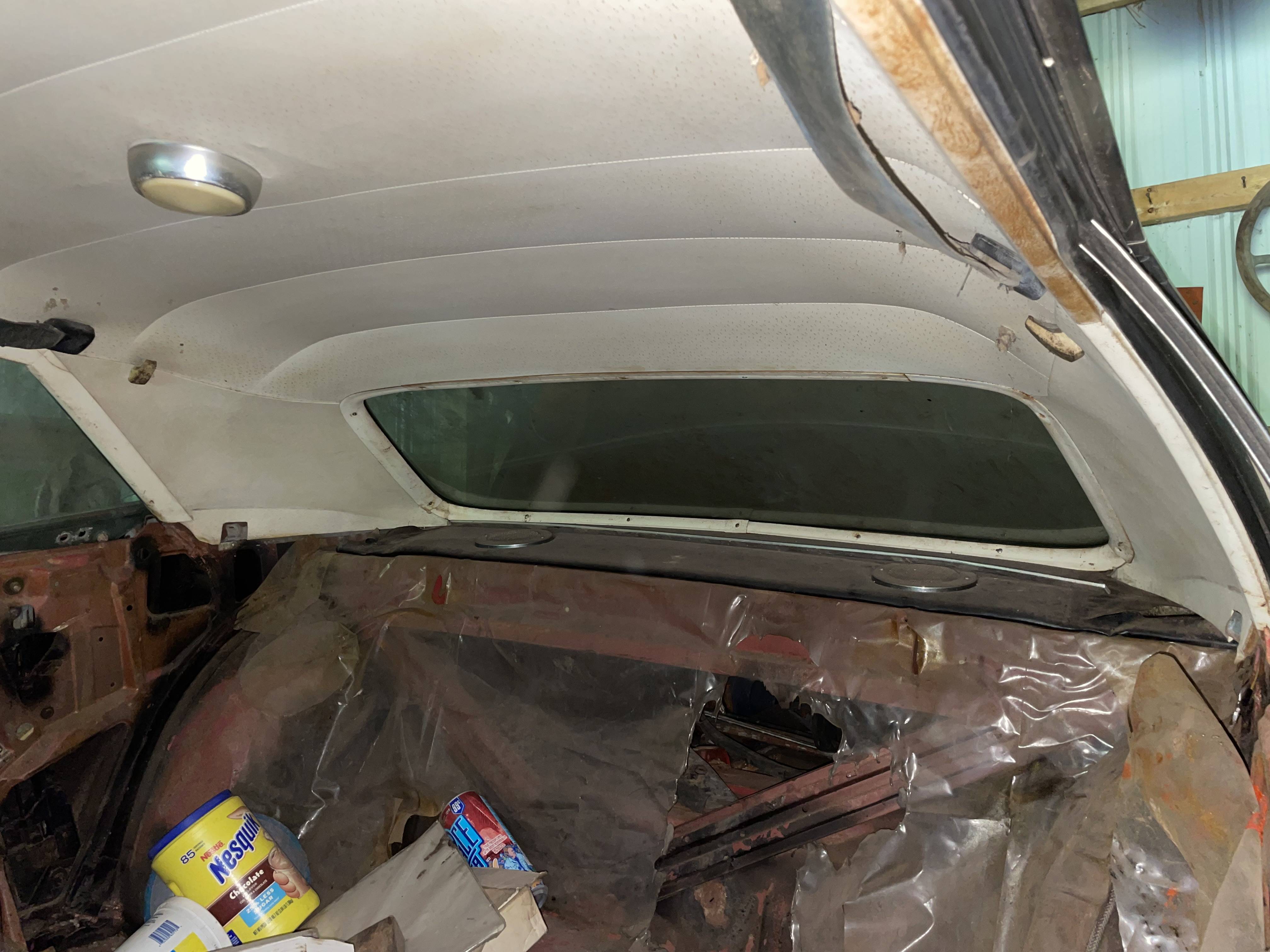

also in the rear picture you can see all the glass is tinted

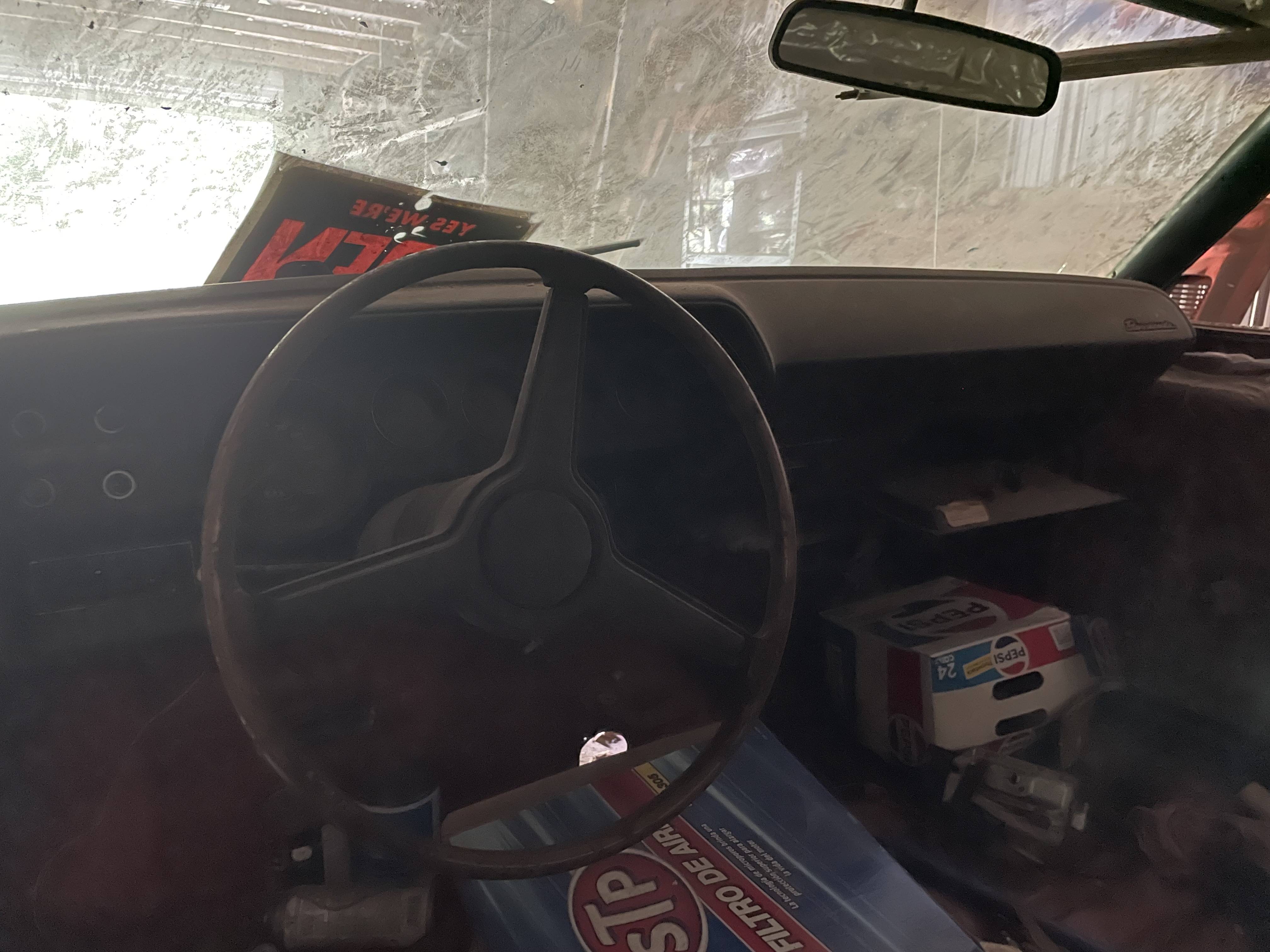

black steering wheel
dash pad looks good in this pic
would have to wash it and look in the sunlight to see for sure -
the good is allot of the original trim parts are in the car even thou some of it is removed.

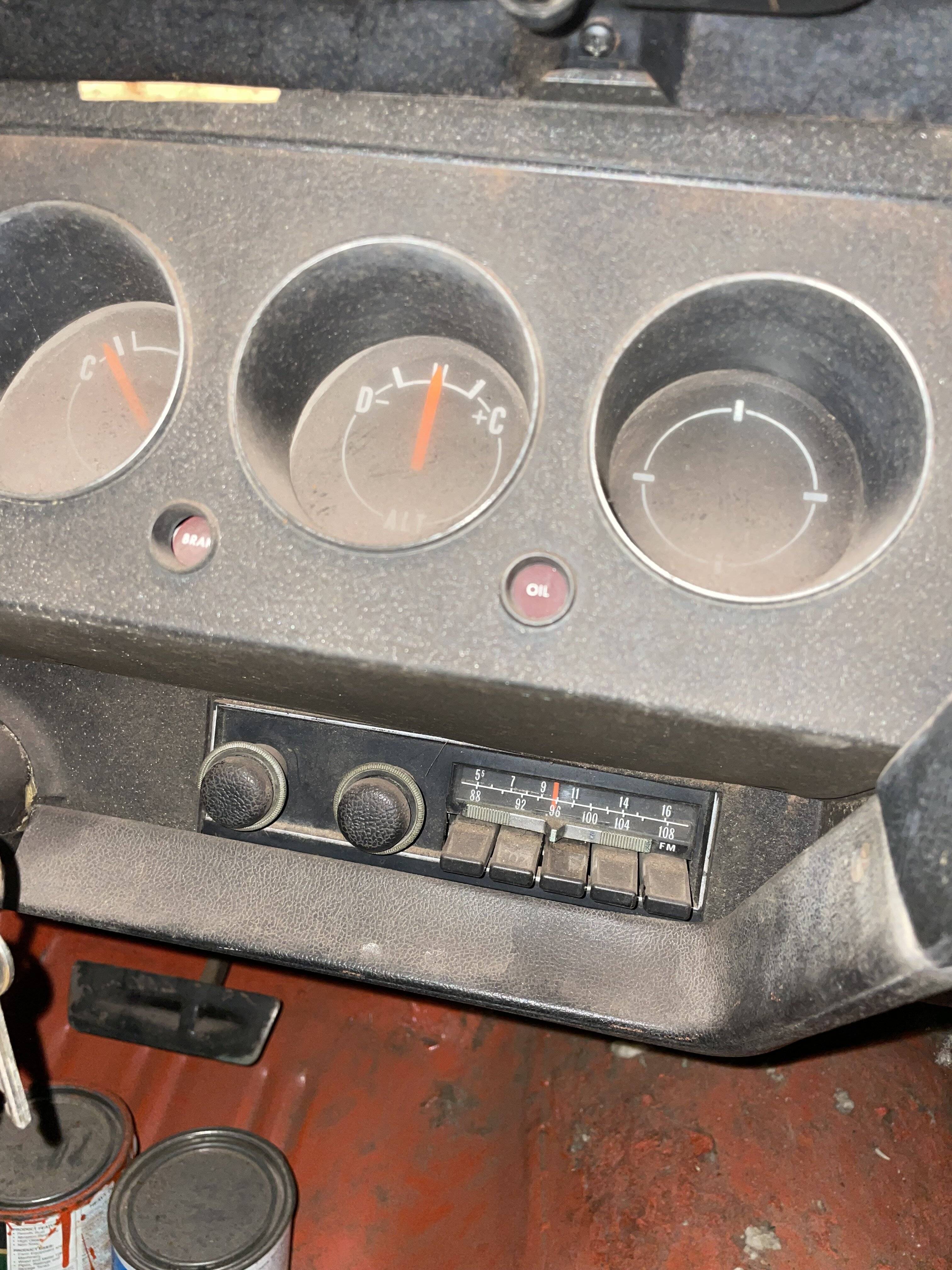

super nice am fm push button radio -
all dash trim in place with all wiring

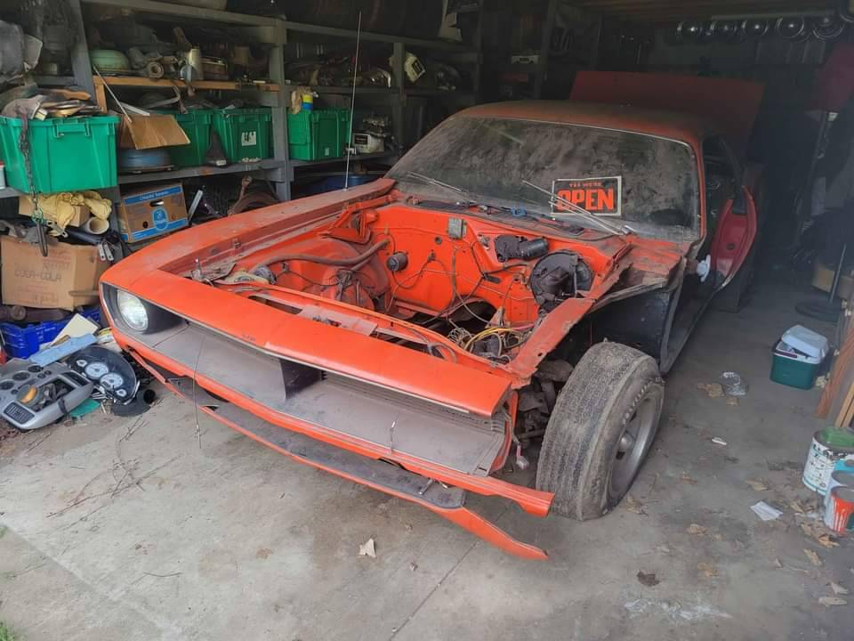

this is a FE5 color car -
shows factory red color inside a pillar hinge area.
you can see it was repainted orange
and very heavy layers over rust pitting of floors and all -

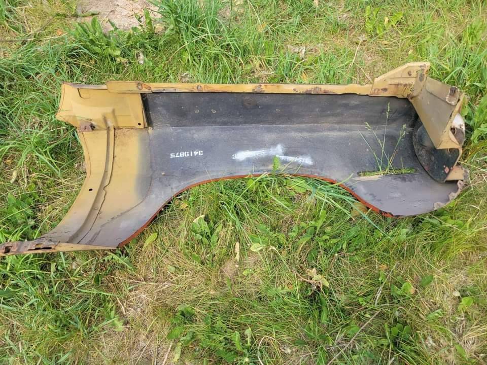

the person says it was in accident and sheet metal was replaced - would be why she has no fender tag- no screw holes in inner fender -
440WB
May 30, 2015
491
76
Michigan
most likely the parts changed inner fender with fender, driver door, the full firewall with upper cowl and radiator support ( front frame ? ) might be why dash with all is now regular ???
with the whole body repaint ???
Insurance job???
person says car has been in the family for 40 years - they are second owner.
stamping numbers probably stamped from auto repair center - they are not very deep - one digit is off - out of line

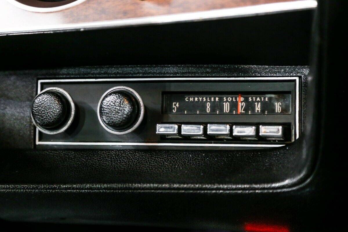

Your car came with the R11 AM Radio which has chrome buttons as below.
The radio in your picture is not a 1970 radio. The 1970 R35 AM/FM is a thumbwheel radio with chrome buttons. The radio in your picture is from a later model E-body with the R35 AM/FM radio option. Black pushbuttons were not used in 1970. Later models did use the black pushbuttons.

the radio is another thing that was changed -
ofcoarse!
