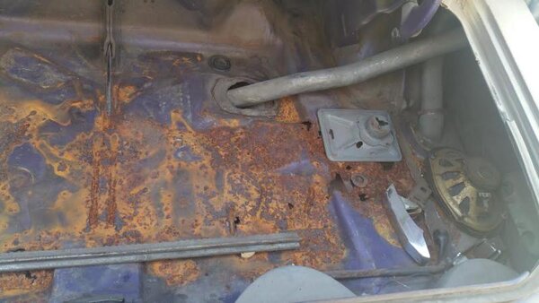

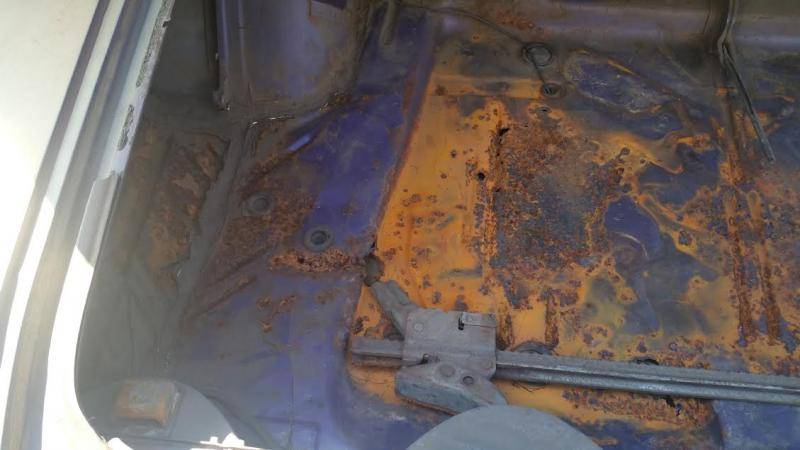

i spent a little more time on it this weekend ,i cleaned out the interior and was amazed - not a spec of rust in the floors - i threw out the rusty original exhaust system that was still in the car , the trunk is a different story - it will need the center portion replaced but i lucked out again -the previous owner had purchased a new trunk floor and forgot to give it to me when i picked the car up-i dont know the quality of the new part ,i guess i'll find out when i pick it up
