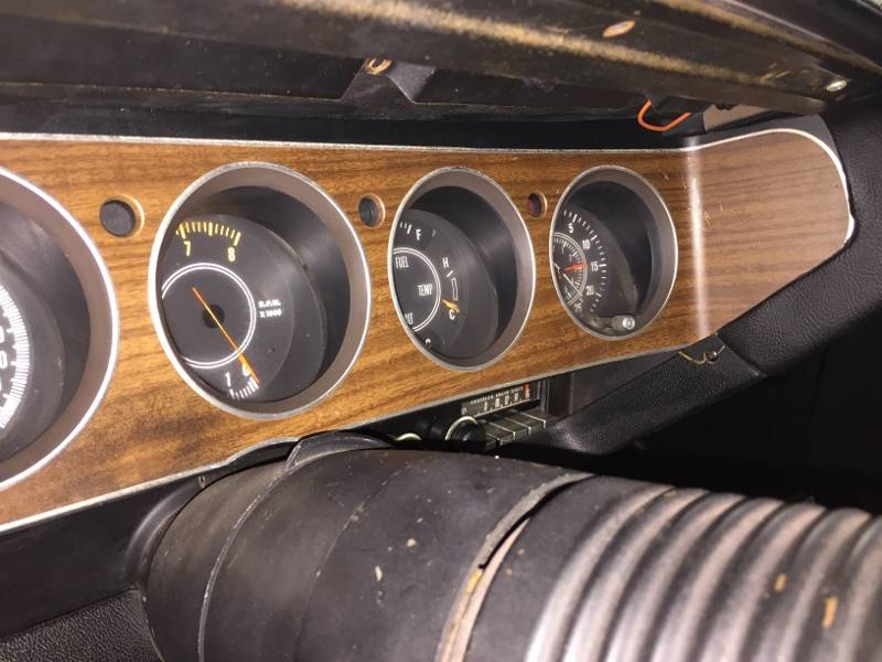

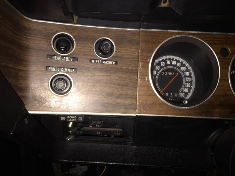

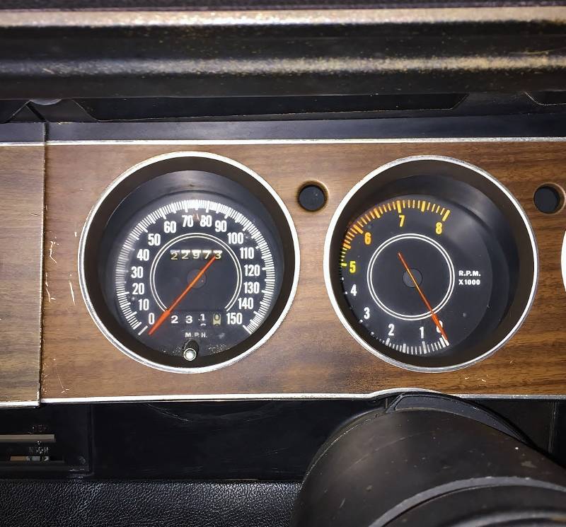

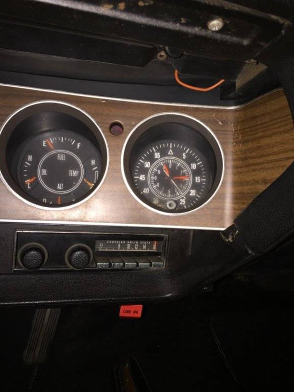

MY 71 Cuda' has a Rallye dash that I know is not original to the car, it is coded on the broadcast sheet for the standard gauge cluster. I'm debating if I want to restore it or put the car back to the original standard dash and my question is what is it really out of ? Through my research I see that 70-71 had the 8,000 RPM tachometer and trip odometer and clock set knob in the bezel housing. Mine has trip/clock knobs like the 72-74 style that go through the gauge but has the 8,000 RPM tach. The obvious answer is that someone just swapped out the tachometer and it's defiantly a 72-74 style, but could this be factory correct ? My car is a late April/early May 1971 build car and some things were transitioning to a 1972 model year could the Cuda' rallye dash be have been this way also and I just happen to have one?

I'm guessing someone added the 8K tach to the later cluster. I don't think It hurts the value of the car to upgrade to the Rallye instrument cluster. I would make an effort to find the correct one for the year of the car though. I also don't think your car is late enough to have had any '72 parts on it.

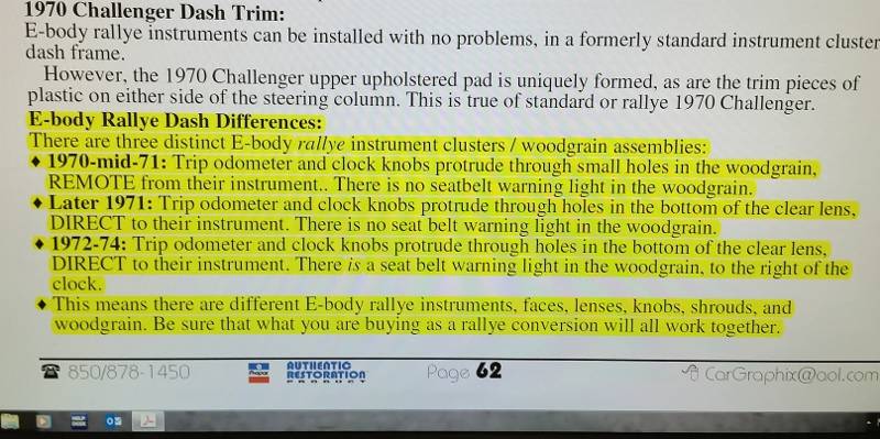

Okay folks,
I was looking around the internet today and found this little bit of information from Performance Car Graphics...Thoughts ? Do I really have a late dash as indicated here or not I guess ill have to pull it out and look for some numbers...
