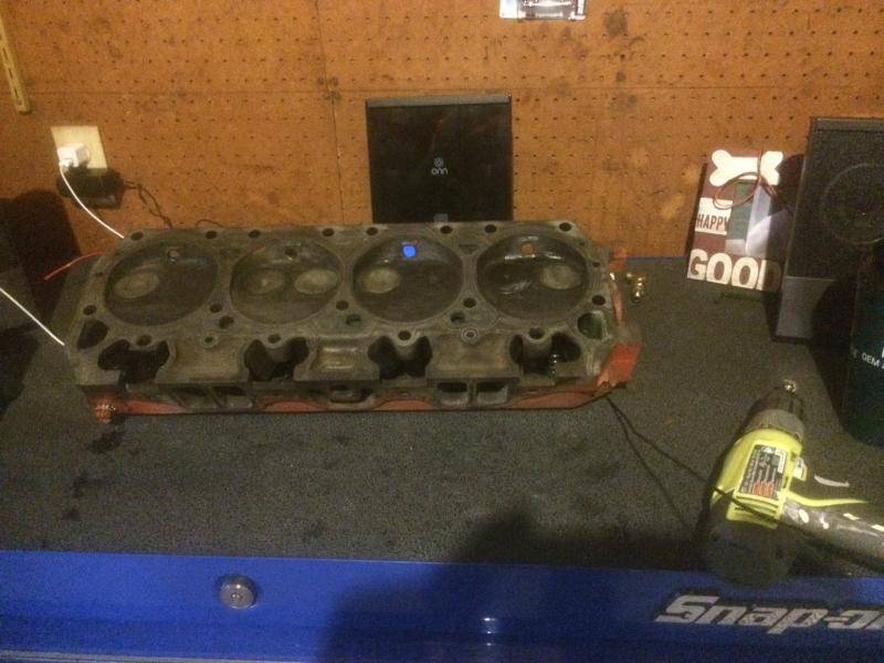

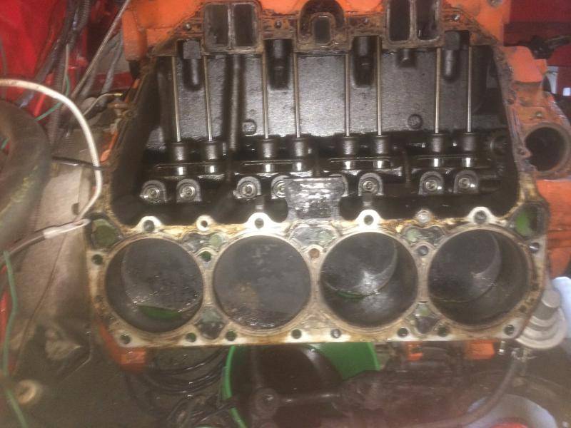

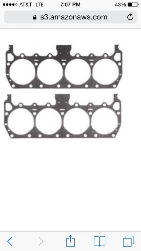

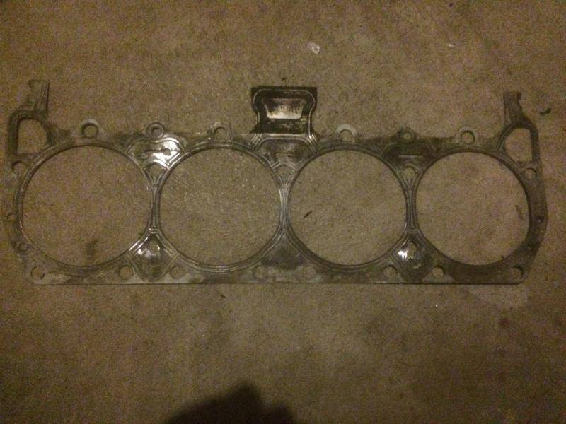

I have a 73 440 with 213 heads in my 73 challenger. I've begun to year it town and have one of the heads off. When it ran it would always be hot, especially when stopped for periods of time. After taking one of the heads off I notice the metal shim head gasket doesn't have the same cutouts/ port holes for the coolant as the block or the head. The coolant ports in the head don't even match the ports on the block. Is it possible the heads were put on the wrong side with the wrong head gaskets? I can't even find a head gasket for a 440 that's has the cutouts for the 213's extra cooling ports.
Ive attached pictures if the head removed, the block and a generic picture of the head gaskets removed. Thank you for the help!
