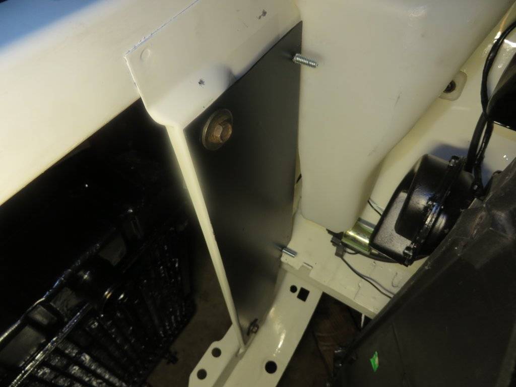

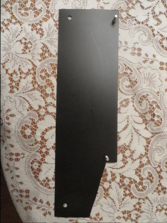

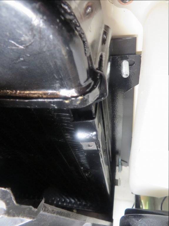

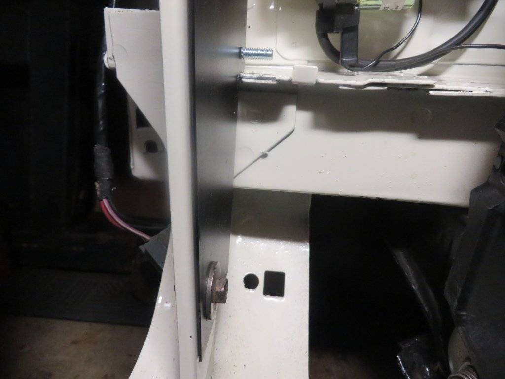

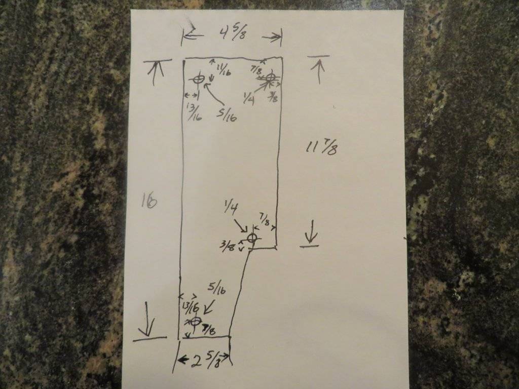

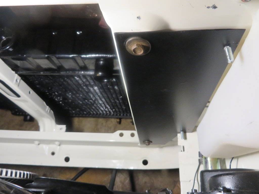

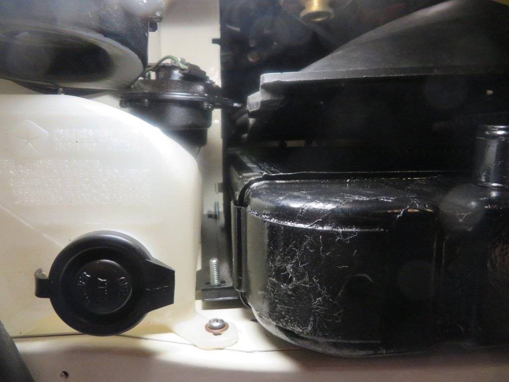

Hi all. Don't know who might be interested, but I mounted a 26 inch radiator on my Challenger's 22 inch radiator support without any cutting or welding. I did this by making an adaptor plate for the passenger side. I used 16 gauge stock from Lowe's. Attached are the measurements and pics of the adaptor in place.
I used JB Weld to attach the bolts for the 26 inch rad mounting holes (cannot get a wrench on the head of the lower bolt after installation). Primed and painted black.
View attachment 26960 View attachment 26961 View attachment 26962 View attachment 26963
A couple more pictures with radiator in place...

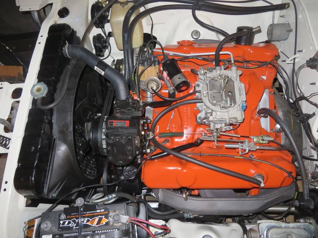

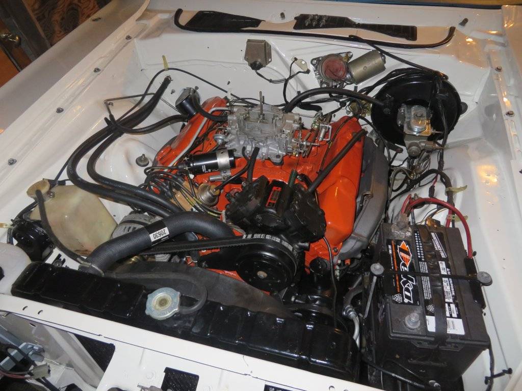

I changed to a 26 inch radiator because I swapped the 318 for a 440. I hope to have no cooling problems with the 440 (I plan to eventually add AC). My 440 installation:
This is a great idea if you are planning on putting the 22" radiator back in the future, but if you were going to leave the 26" one in for good wouldn't it be better to trim that section out to provide extra air flow through the core?
I did the same thing except I made spacer for the two bolt holes that were already in that location. If I didn't make spacers then the radiator fins would be hitting the core support.
Looks like the ac is already there, you're quick! (I see it's not plumbed) I was thinking the same thing that Mark was in that you now have a 26" wide radiator but with only 22" of it exposed to air flow. You probably increased your cooling capacity a little but you're not going to get the full benefit that you could out of that 26" without opening the core support to the same size as the rad..
Your engine room looks great though.
Yep. The whole point of the 26" radiator is more cooling capacity which means more airflow to the radiators surface area. Since this car is obviously not original, why not do the a/c, cooling system upgrade the proper way ? It still can be done cleanly.
A couple of reasons I did not replace the passenger side radiator support. I am keeping the original 22" radiator and the matching number 318 engine and 904 transmission. I'm also keeping the original driveshaft. This all for the next owner (after I die).
I only lose about 2.5" of radiator fin exposure. This affects cooling at speed a bit, but I have a shroud, so the cooling difference at idle is negligible. I would expect, for any engine, cooling at idle to be the most demanding. I also wanted a stock look with the radiator tank (no aluminum box) and I needed the upper hose to be on the passenger side and lower hose to be on the driver side (opposite of 318).
One other thing. I had the engine bay painted and did not want to redo any of that.
