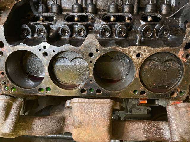

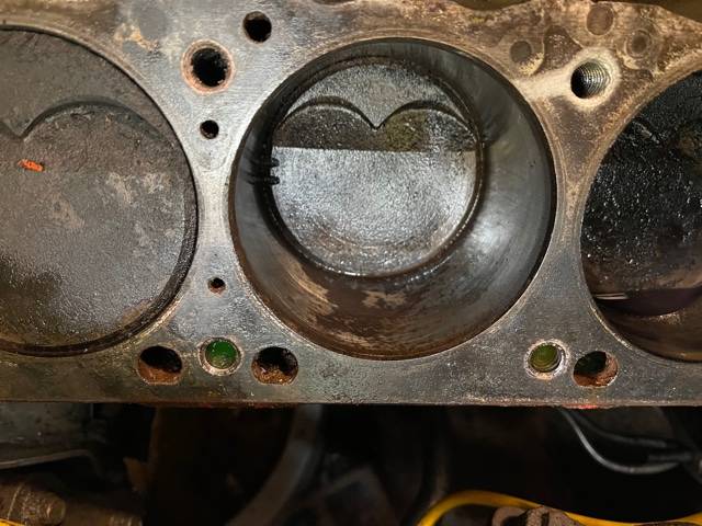

My 70 Challenger (340 4-speed) has a seized 340 and I have this 273 from a A body stick car lying around so I was wondering if it would bolt right in without any modifications? Will the 340 exhaust manifolds bolt on to the 273? This car is pretty ratty and I was thinking I would like to drive this car the way it is and possibly someday down the road restore it.

Thank you very much for the replys. I definitely did not consider some of the points made but I did know about the timing cover/hoses. I don't know what year my 273 is but it does turn and should run.
Maybe I will try one more time to free up the 340. It sure would be cooler to have a 340. The car has been sitting mostly outside since 1984. If you ever watched Rust Bucket Resto on YT the guy who does those videos found a 2nd gen Charger in the woods. One video showed him trying to free up the engine and man it was really bad inside. I think I will do a little more tare down on my engine and see how bad it is. Maybe if I take the heads off I can get enough transmission fluid or Marvel Mystery oil in it to free it up. The one thing that gives me hope is the oil looks brand new on this engine. If that doesn't work maybe I will look for a running 340 to put in it's place. I just hope that someday I can free up the 340 because it is the matching numbers engine.

I think you are right in disassembling the 340 and trying. A lot can be done to save it and like I said earlier, sleeving is an option to save it.

rklein71, yes I want to do whatever I can to try to save it. It will definitely make the car more valuable and cooler too.
Richard Rach, that is a very interesting idea. I will give it a try. If it doesn't work I don't see how it could hurt anything.
Bobby, your buddy is lucky. I tried Marvel and it didn't work for me but I wonder if I put enough in the cylinders. Do you fill up the cylinder totally?

When I started working on my A66 340 engine after the car sat in inside/garaged storage for sitting 34 years; I could not get the engine to turn over manually. I used Kroil and PB Buster initially through the spark plug holes for a number of weeks. Still would not turn. I finally pulled the heads and used these materials directly on the pistons. Slow but sure and putting pressure on the crank bolt, the engine freed up. The process also loosened up the small amount of carbon that was on top of the pistons.
Cylinder walls were in good condition with minimal ridge. I found one cylinder with pieces of oak nuts? How the heck did a rodent get into one cylinder? A small amount of light corrosion was evident on the cylinder wall in that cylinder.
