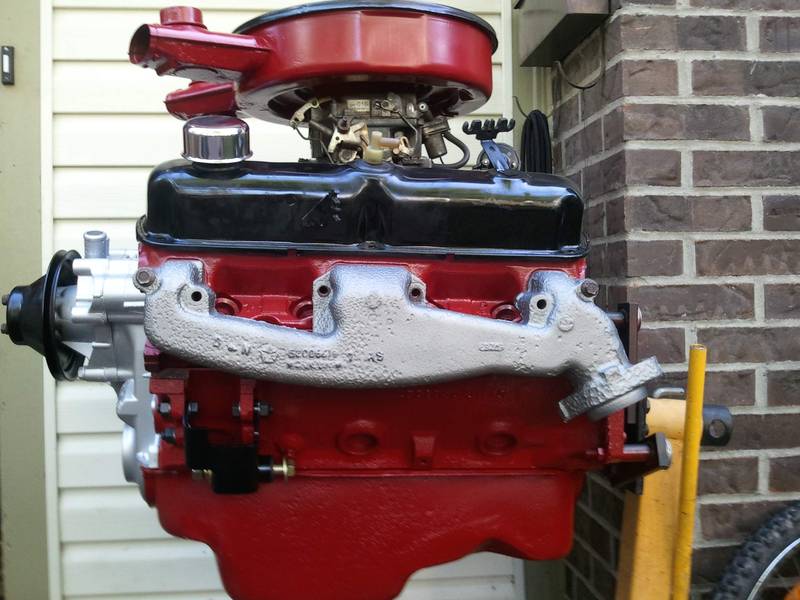

Here is a mock-up of the left-drivers side of a 318 with a 92/93 castings 53006618 & 53006619 are the best flowing modern magnum manifolds.
