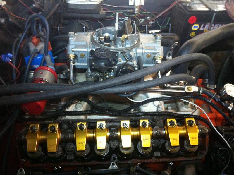

I have a crate 360 but no history on it as the previous owner has not return any calls. I am considering doing a full rebuild on it rather than nickel and dime it to get it to perform well. Unfortunately I do not have time, space, and through knowledge to do the rebuild myself so this will be sent out to a local machine shop of which I am researching now. I don't have a lot of details on the engine (bore, stroke, cam, etc). I do know it has cast iron heads, Holley 4150 670 cfm carb, roller rockers and the block is stamped 1979. My primary objectives would be a very reliable, streetable, good performing engine with 375-400ish hp but no drag racing. I have a 727 3-speed auto with 3.91 gears (planning to switch these to 3.55). I don't want to have to change transmission, rear end, etc because of engine upgrades. My budget is around $3000 which will ultimate drive this project (like always). Has anyone had good/bad experiences with a rebuild? Any advice on recommended adjustments (change intake, what cam and intake/exhaust, change carb)? I'm also considering stroking this out to 408 but keep the compression around 9.5 and have been told this is fairly easy to do, and would welcome your thoughts on if this is good/bad and why. Thanks for your help!

It looks like it's got some decent parts. The power level you're looking for is reasonable with afresh engine and a camshaft.. So I'd say pull a head and see what the lower end has for pistons and what the bore size is, and go from there. "Ticking that changes with rpm" could be a lot of things, some of which are entirely normal for some types of camshafts, but if you're unsure perhaps the best way is to figure a rebuild and have it done. Where are you located? I do not feel that $3000 is enough to propoerly build a larger-than-factory stroke, even a very mild one which is what you're talking about.

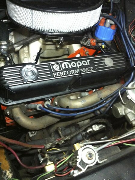

Those headers look kind of old. The ticking could just be an exhaust leak. Start the engine when cold and quickly feel around the tops and bottoms of those header flanges, you will feel the leaks. Careful it will get hot quickly.

Thanks Adam. You are right about the headers, but I've pulled them twice and checked for leaks, replaced gaskets, and changed to Stage 8 bolts. All pulleys were checked and torqued, and measured the valves. All seems to check out ok. I am getting a new set of headers (Hooker Comp/Super Comp or TTI's) as these have got to go.
I installed new headers on my 440. They were very nice with 3/8 thick flanges; both the head and headers were very clean and looked straight, but that didnt matter. The new gaskets blew out and leaked in short order. I upgraded to copper gaskets and they never sealed... lastly I installed Remflex brand gaskets and they worked very well.
