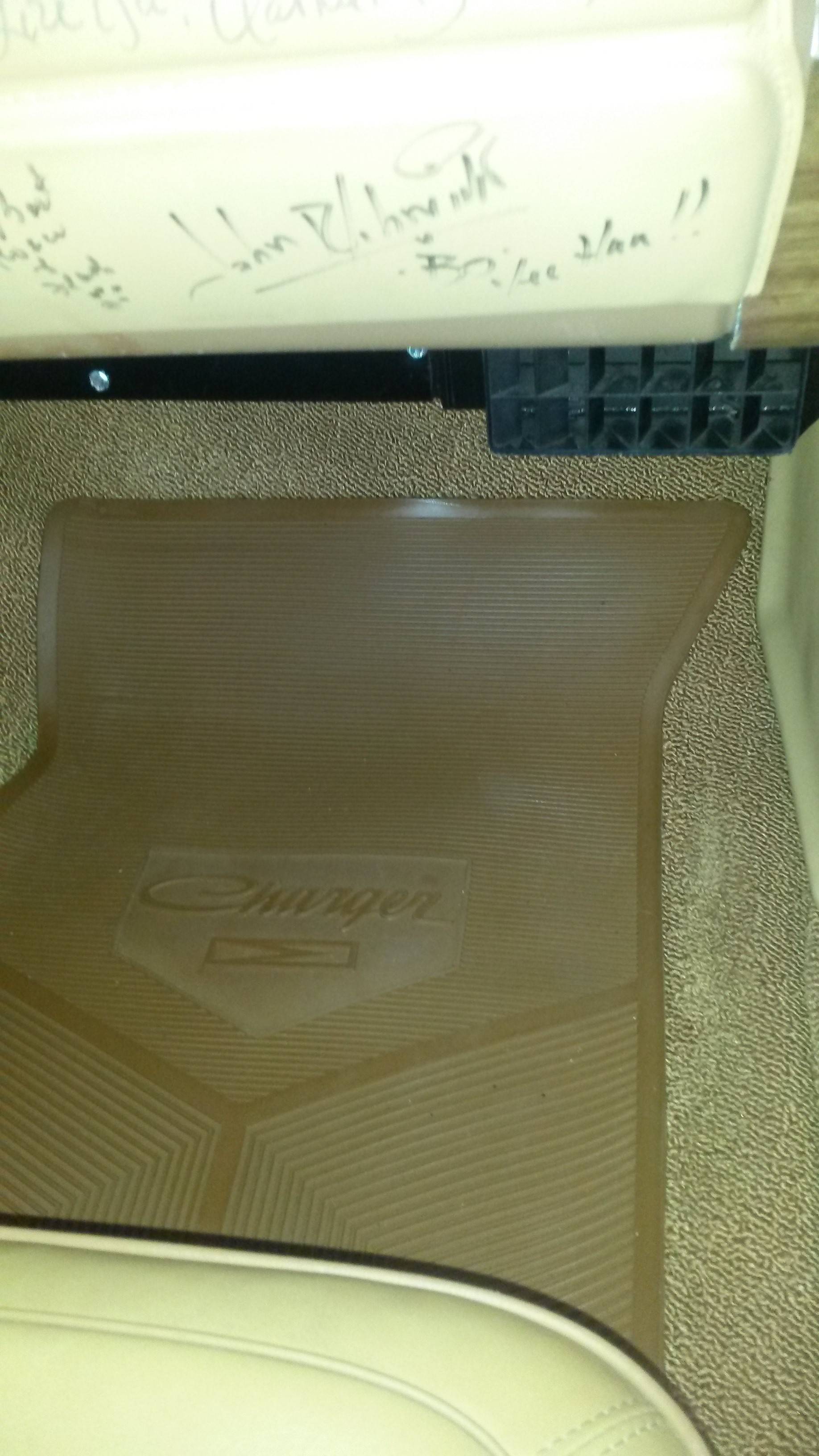

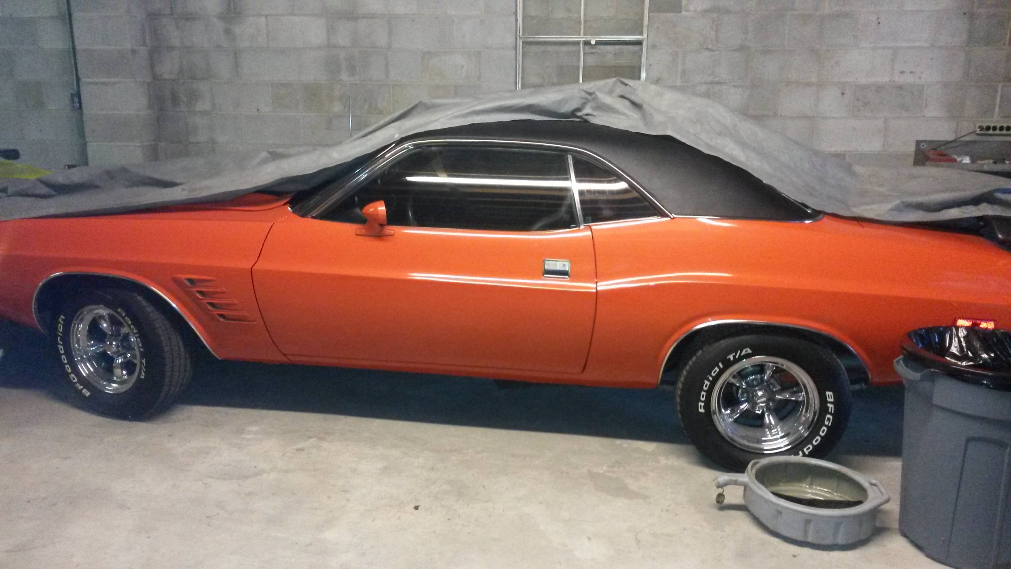

About that.360 stroked.his brother told me that the not 360 would clean his clock like yesterday was over a week ago. His stock 69 Charger 440 General LEE. If you take notice The charger dash is singed by some members of Dukes of Hazard. If there is a 360 in it I would make the best of what I have. With my deep pockets I would also build a 3Gen for latter.Or end up putting into something else latter. I don't know if at some point some parts or things will be available. Depends on do you want a stock look or a mod look.
