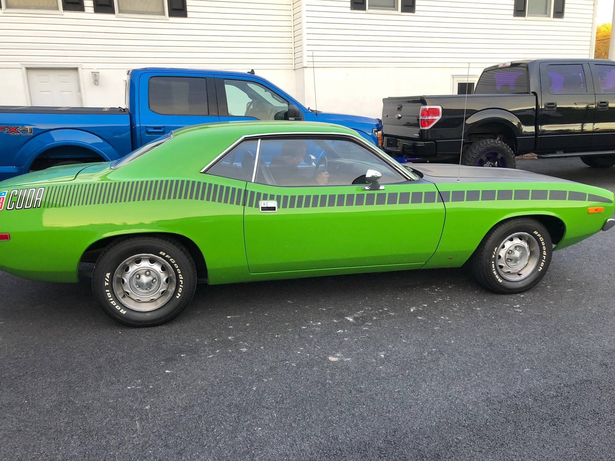

Just bought a 72 Barracuda with a slant 6. I quickly found a 440 with everything and 727 trans, just need to rebuild. Was looking to put top end kit on the 440 with some headers and a Holly Sniper EFI.
I just saw a Gen 3 392 Hemi engine for sale and was thinking maybe that would be a better choice, although would be more expensive.
I think the 440 would have as much or more HP when done. Wondering what others have done and which way would be an easier swap. Thanks in advance for any input.

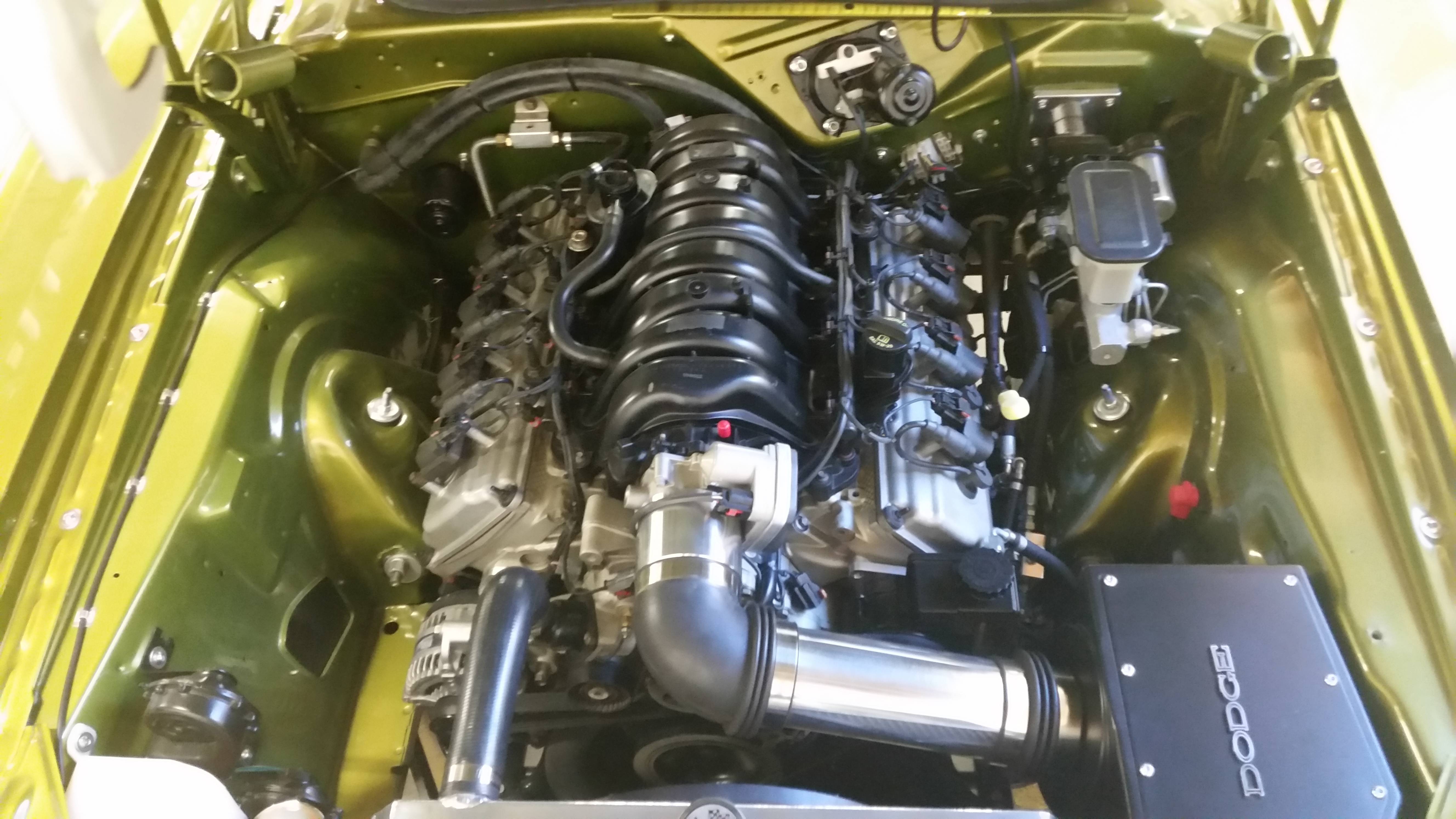

It really depends on what you want. Old school iron is cool and pretty straight forward but a G3 will be very reliable and deliver consistent smooth power. I have a 70 Challenger with a 440, a 73 Cuda with a 416 (stroked 340) but I am building a 71 Charger with a 5.7 Hemi. I grew up with old iron and while I love an respect it, I really want the reliability and drivability of a modern G3 like I have in my 2010 Challenger RT.
Either choice will be fun and I will say that the 440 will be easier overall.

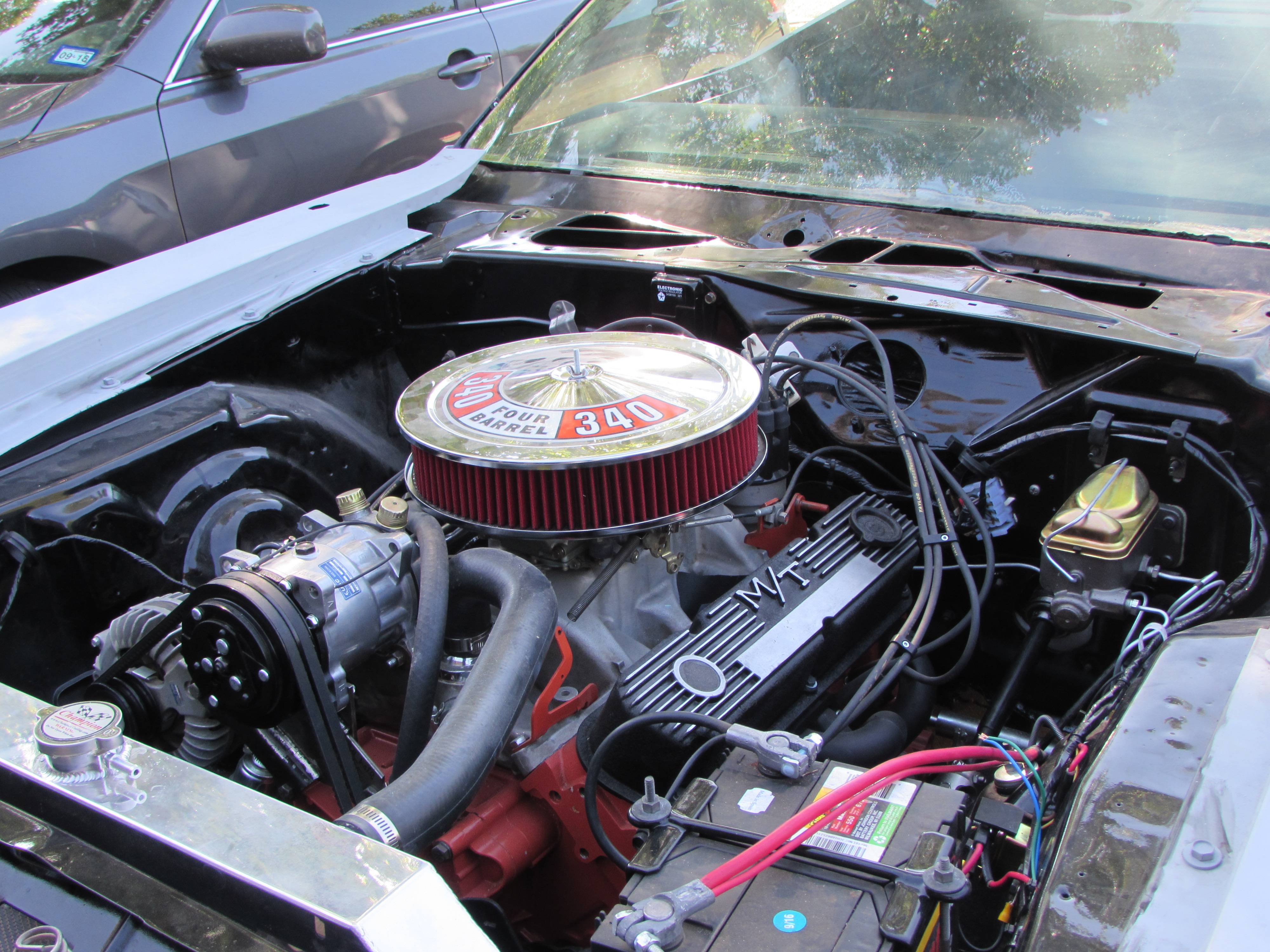

Three years ago I had to make the same decision and went with a stoked small block with plans to put EFI and an overdrive A518 trans in. . Everything is a lot more straight forward since they were original to the car. That said, if I were doing it now, I would give a Gen 3 much more consideration. The availability for the parts now is much greater, and better options then before. Some of the cost you will incur either way. Both need motor mounts, headers, radiator, and fuel system upgrades for the EFI. The base Holley Sniper is around $1,000, where the Terminator X ECU runs $1,300-$1,500 depending on what unit you get. The real cost difference then come down to engine cost. In my case, my stroker long block is over $6,000 not factoring in that I still need an ignition system. That cost is close to what I have seen for low mileage 6.4/392 for, and 5.7's for less. If the 440 you have just needs a basic rebuild, with a good top end kit, could be done for less. These are all just things to consider, so take it for what you will. I'll finish off by saying I don't regret going with my stroker, it looks original, but will a lot more torque to move the weight that Adam addressed above. A Gen 3 can do it, but I would think the 392 would be the best option as far as stock offerings.
