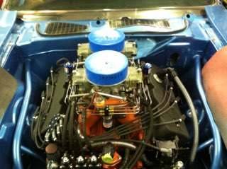

I have their K frame and front suspension on the front of my 70. No issues to date. I did have to modify my #1 header tube to clear the steering rod to the rack. I am however able to run a 10 quart flat bottom top fuel/funny car oil pan with plenty of ground clearance.
