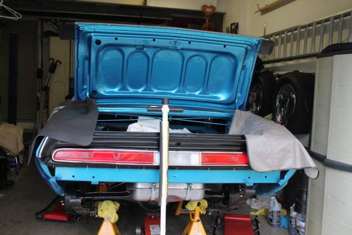

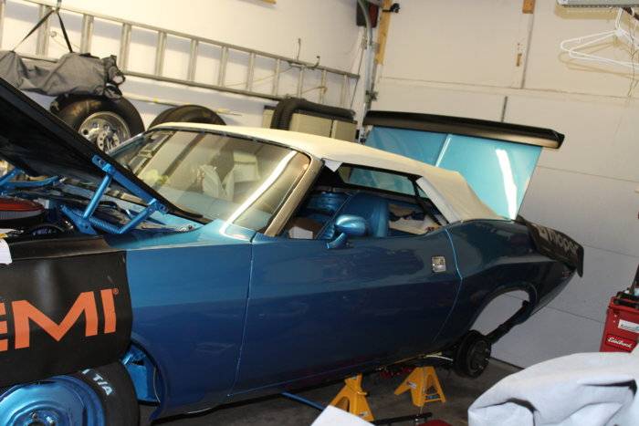

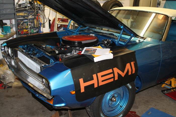

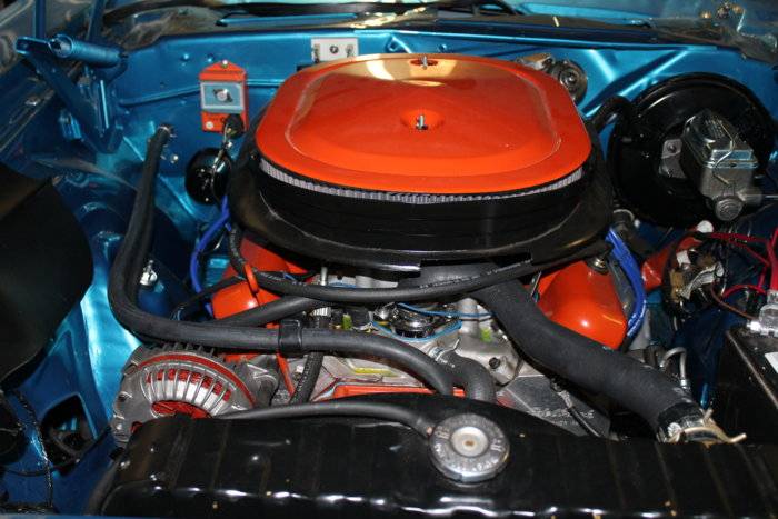

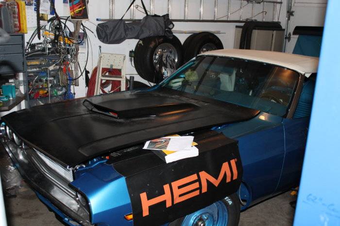

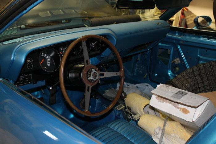

I purchased the car along with a number of parts in 1992, 318 auto rough but restorable ,started a `B` body in 2000 finished it in 2010, 2012 stripped the vert and sent it off to the body shop( sat there about a year and a half ...used as shop filler) brought it home winter of 2014 and started the reassembly process drivetrain ,electrical dash, top (almost done) and then comes the exhaust not realizing that the tip brackets need to be installed before the suspension (live + learn) have now r dropped the rear end and
just want to be sure on their exact location pictures are where I'm at hope to have it road worthy summer of 2018

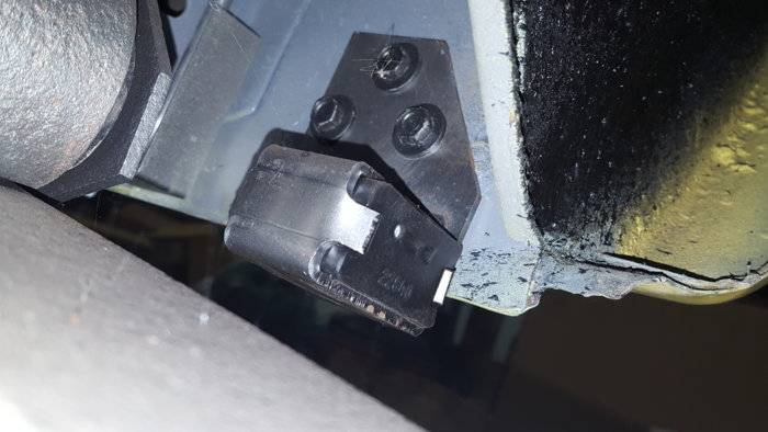

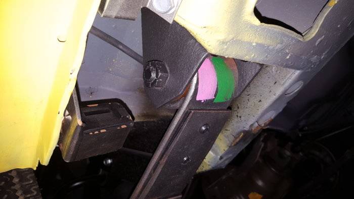

There are brackets that mount to the inside of the rocker panels by the forward rear spring mounts that support the T/A side outlet exhaust. These pics are of the right side. Hope this helps...

WOW - absolutely stunning.
