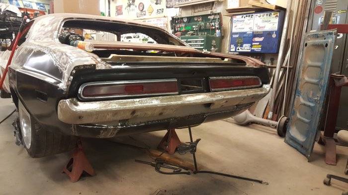

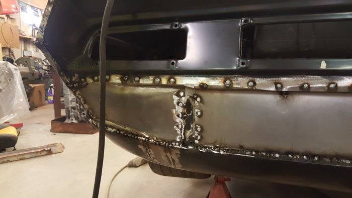

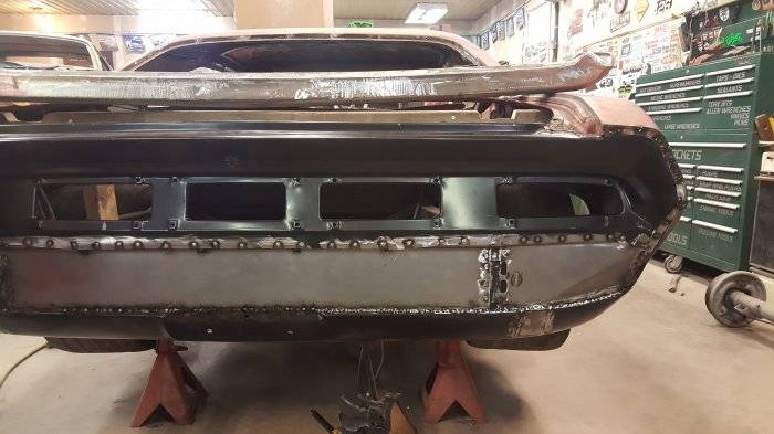

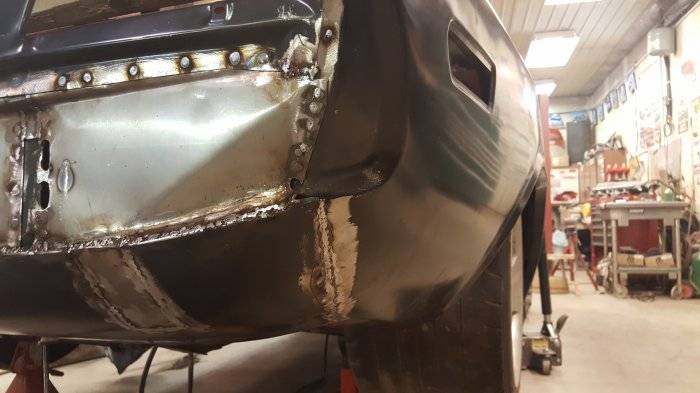

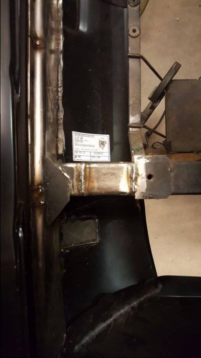

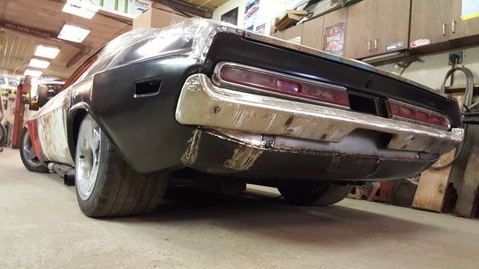

Got the tail wrapped up in the last couple days. Got the bumper fitted with new brackets and holes filled. Had to lengthen the Viper frame rails 3"to reach the back panel of the Challenger trunk. Welded a filler panel in between the t-light panel and the valence. Might add on to the bottom of the bumper to get a better "finished" look and fit. Welded the valance in to the bottom of the quarters too. That joint was really bad. Looks good now tho. :) And, the deck lid even fits!!!!

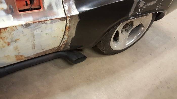

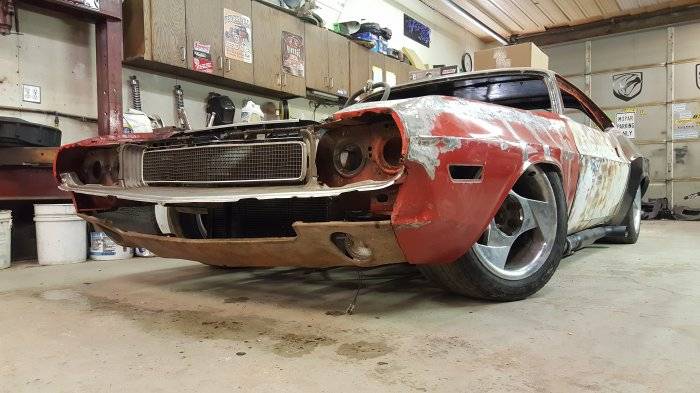

Took a couple shots of Challenger on the ground. It is LOW!!!!!!!!!!!! I am 6' tall and the top of the front fender is about knee height.:cool:
Fat and low! This is going to be one damn cool Challenger. Great idea, nice work.
Thank you!! The front is 24" tall where the headlight bezel attaches to the top of the fender. The rear is 26" tall at the sharp bodyline at the rear of the fender.

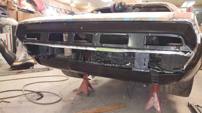

love the way its coming together !!!! just not sure about the rear valance and or bumper. I'm sure you will come up with something to make it flow together nicely!!! (judging by the rest of your fab work)
Yup, we are going to extend the bumper down to meet the valance. Never paid much attention to the factory placement and how crappy they fit together.

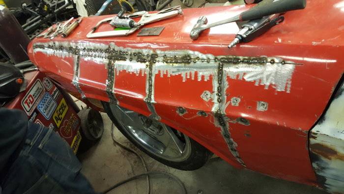

Don't know how many of these are repeats. Been working on car for a few months now. Many mods. :)

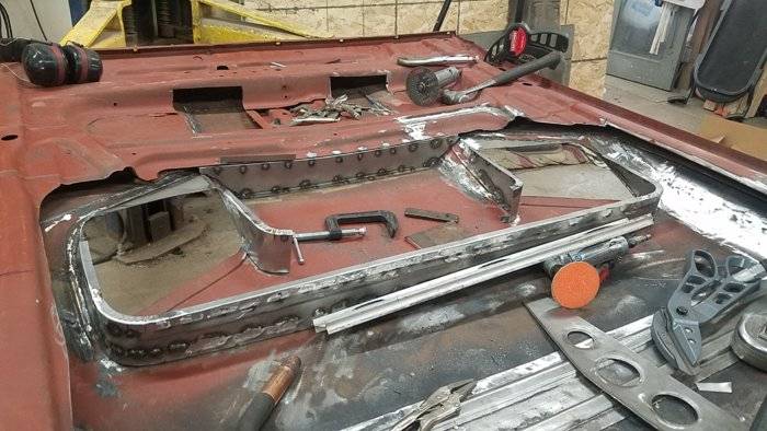

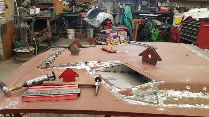

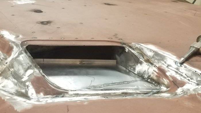

Been working on a functional ram air setup through the hood scoops.
