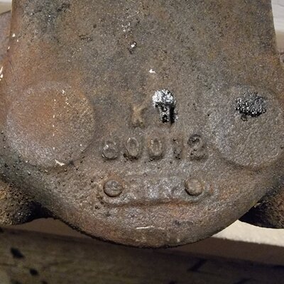

Take some photos of the complete caliper, bracket set up. What are the casting numbers on the original calipers ?

Here's the casting number. I'm getting remans from NAPA tomorrow. If they are actually remans, they should fit. If they do, I'll have to turn in the old ones for the core charge. I won't be able to work on it over the weekend, so I'll let you know next week what I figure out.
What you have are known as "WIDE MOUTH" Calipers.
They were a one year only design like that on the caliper body.
The 1971 up E body, and later years Kelsey Hayes, single piston caliper used somewhat of a different design body caliper.
Those Wide Mouth calipers are extremely hard to find in this modern day and age.
DO NOT turn them in as cores at your parts store.
Eat the core charge and keep those calipers, and sell them here on this forum.
They are worth BIG BUCKS, $$$$$$$$, to the restorer, and person that knows what they are.
You want to know what i sold a rebuilt pair of those wide mouth calipers at, write me a pm message and we can have a conversation with one another.
Jim V.
