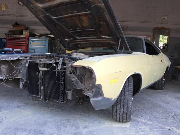

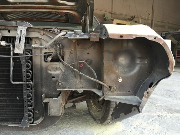

ORIGINAL NOVEMBER POST: My older brother Michael, who was a marine, passed on and I am now raising his only child - a '73 Challenger. He always dressed this thing up to try to look like a 70, taking off the rubber bumpers and adding a beat up R/T hood. I disagreed at the time while he was alive but now am trying to make at least the front end look like the 70 he wanted, which always reminded me of my favorite Mopar, the '68 Charger (we also disagreed over the best WW2 airplane - Mustang versus Lightning). I've kept the old 73 Fenders on the Challenger for convenience and price.. knowing from previous posts that somehow there's going to need to be a weld to make the 70 grille stick to the 73 fenders... I guess we'll figure it out, but Do you have any instructions on making that 70 grille attach? Also, it looks like I'm missing a part in this picture that holds the headlamps in.. what am I missing here..? My 73 Grille that was removed is all one piece .. so, I can't remove those headlamp mounts.. Any ideas or advice..?

The headlight bucket is part of the 70 steel fender. In 73 it is part of the fiberglass header panel or fascia. You need 70 or 71 fenders or a pair of buckets from 70 or 71 fenders.

Another forum a person posted this: "I installed a 70 grille in my 73. I didn't like the bumper guards,spacers, or grille. I drilled out the spot welds from a set of rusted out fenders. They are easy to line up. You need to cut the bottom threads of the hood adjustment bumpers as the threads run into the headlight buckets. It is necessary to weld a tab for the outer headlamp bezel screws. The upper edge of the fender needs to be dimpled for the upper bezel screw. I made a template from a 70 fender. The hood latch will still work but the extension on the lever is buried behind the grille, you can access it though. The 72 rear bumper brackets fit position the bumper correctly. If memory serves me right I just slid my 73 front brackets rearward as they had 2 sets of holes. i didn't change the tail panel as it didn't bother me."
He meant AMD would be your best bet for the fenders. Are you still thinking of modifying the old fenders ? There are no instructions to do this modification that I know of. Of course if you ruin the fenders that you try to modify you can always still just buy the 70 fenders.

-Front fenders-70 or 71 ('72 up fenders don't have headlight buckets, headlights are in the fiberglass grille header panel, so you need '70 fenders or at least the buckets to weld in)
