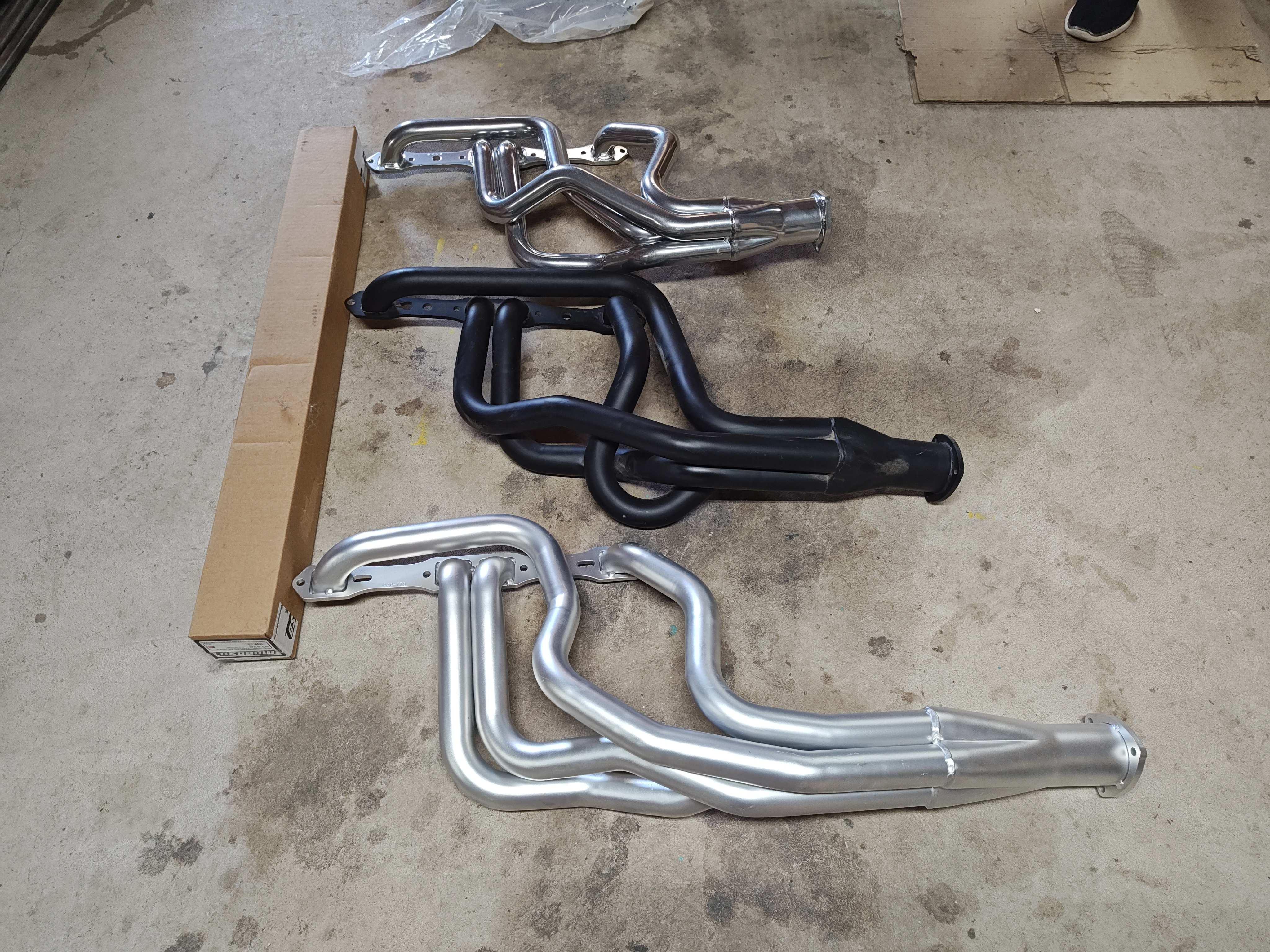

It's still a little warm here in the desert, but I'm going to install big-block TTIs, Doug's and Hookers into my 71 Barracuda. I'm betting on the TTIs fitting the best! I bought the Hookers for breaking in my spare 413 and the Barracuda's 440 because ceramic coated headers don't like breaking in engines. Like Mrmopar340 and Steve340 said, you need to cure the ceramic coating.

Any updates on your header fitment testing?
Xcudame
May 27, 2023
2,172
1,569
Southeast Arizona
It finally cooled down here in the desert. Highs in the 60s and lows in the 20s! Seriously thinking about using my 70 Challenger instead of my 71 Barracuda. I can swamp in the Doug's headers pretty easily as they're for a 383/400. Then I can pull the original 383 out (it needs rebuilt after 250k + miles) and drop in the 413 my Son and I built, break it in with the Hooker headers, then swap in the TTI headers.
