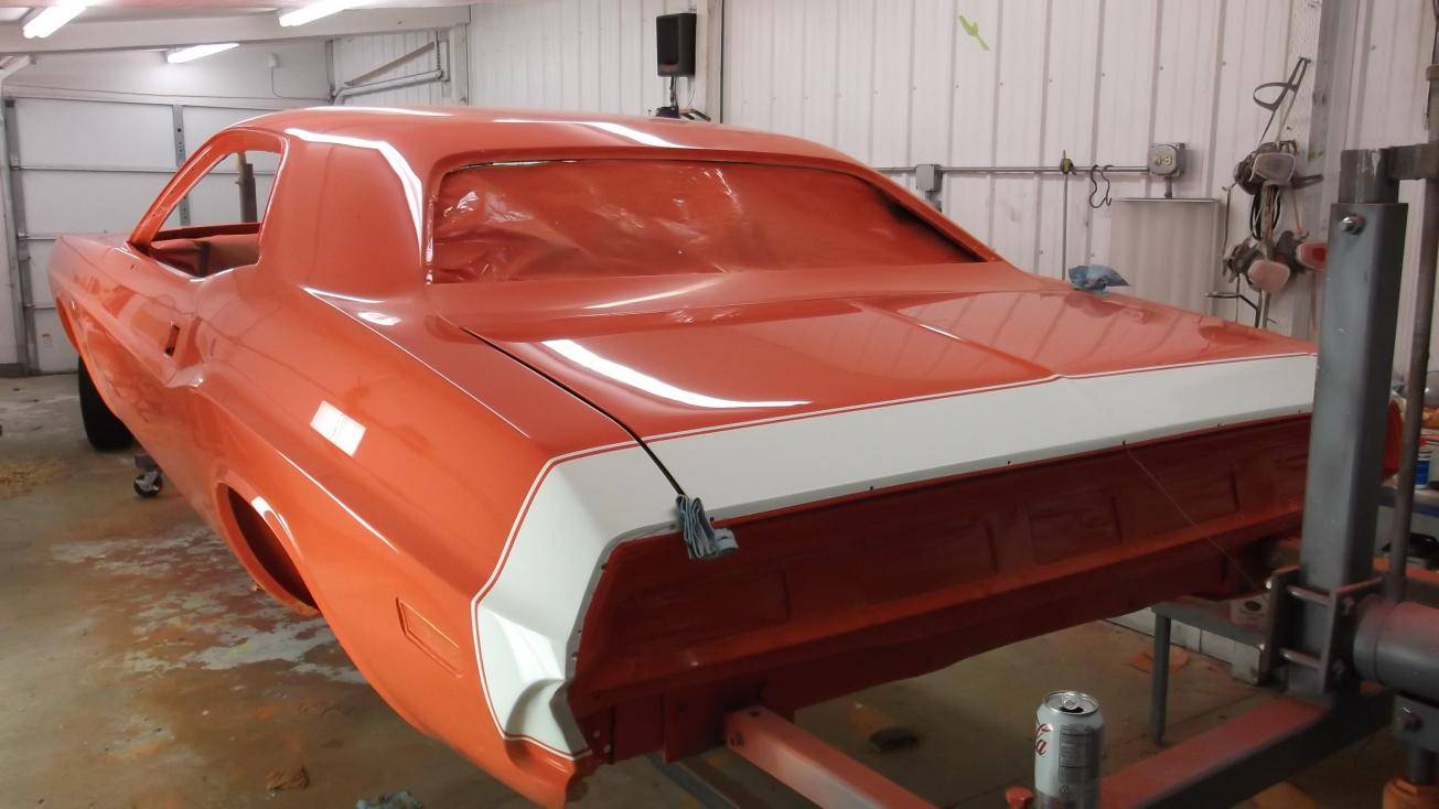

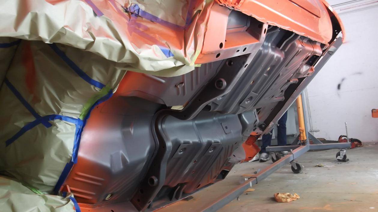

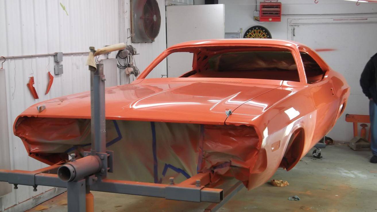

Just read your thread, glad to see your keeping and starting to work on your A66. Mine has been sitting idle for about 2 yrs in my buddy's paint shop. It is still mounted to the rotisserie and I need to finish the undercoating in wheel well area and paint the black out areas it had on upper cowl area and behind grille and core support areas. This is a # matching 9/28 SPD built A66 4spd car from Hamtramck. Hope to bring it home and start assy in March if I can get my shop cleaned out. Paint was done to match original (single stage) as was underside. Glad to see you got those 340 decals, good score.

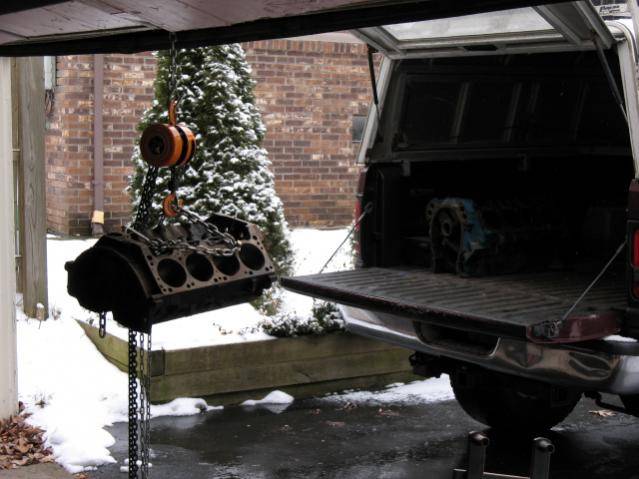

Loaded up the engine block and main caps for a trip to the machine shop. Not so much to get started on the rebuild but to be hot tanked, magnafluxed and have a hone sent through the cylinders as a quick check of there general condition. If all is well it'll just be oiled and bagged for storage. This is the final step in making sure that the original engine is in fact useable. I think it will be, it doesn't look that bad.
